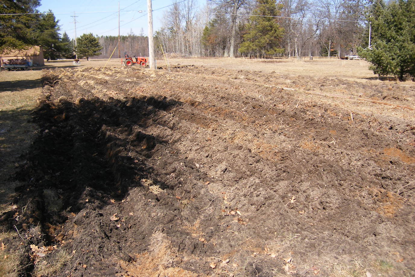

You can pull a small frame 2-12" Moldboard Plow in sandy soil with a B3030HSD. You cannot pull a large frame 2-12" as the plow beam will collide with the rear of the tractor. You will be plowing in HST/MEDIUM with full throttle, which is fine. (2-12" NOT possible if you have Turf Tires.)
If you have clay, gravel or other 'tough' soil it would be prudent to stay with a 1-12" or 1-14" Moldboard Plow. (Turf Tires fine.)
HST/Gear is immaterial. Tractor weight, traction and space around the 3-Pt. are the three issues. If you plow, you pretty much need a Disc Harrow for secondary tillage:

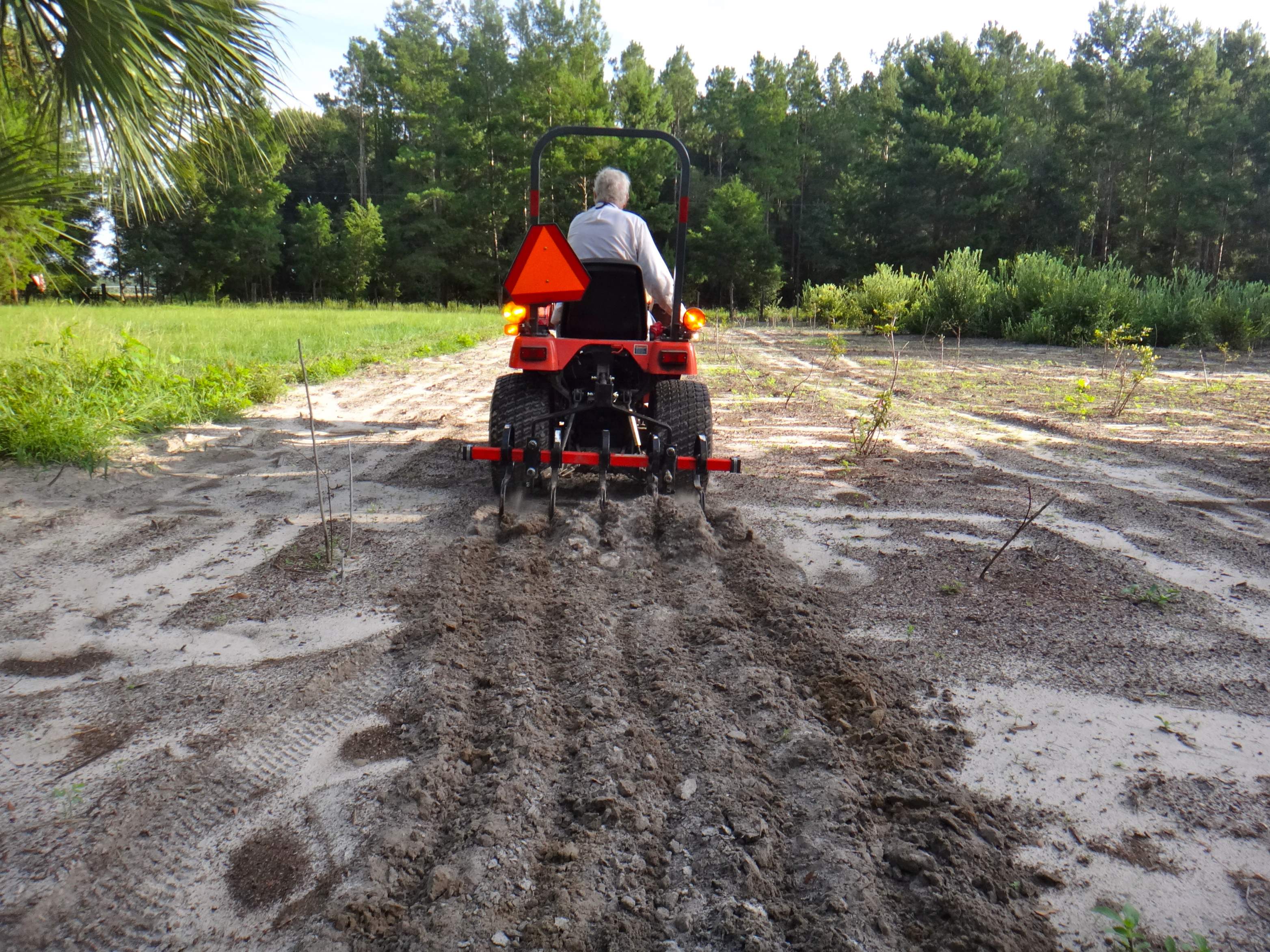

HST is the ideal transmission for PTO powered roto-tilling. (Turf Tires FINE.)
Few owning a roto-tiller would feel the need for a plow or Disc Harrow. Roto-tillers are superior for garden preparation.

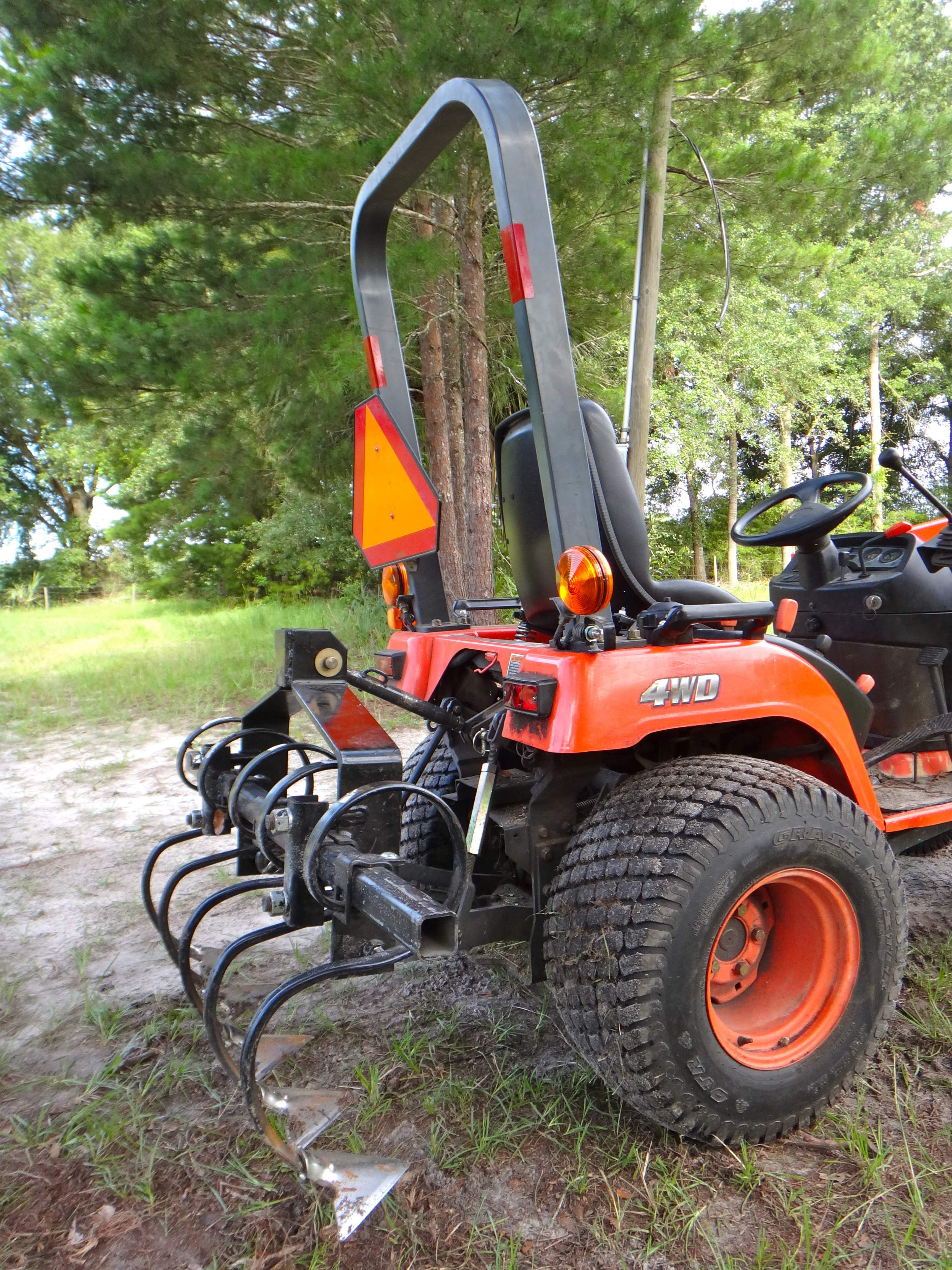

You will probably want some form of tine-space-adjustable Three Point Hitch garden cultivator. Pictured is 'Wunderbar' from Woodward Crossing.
