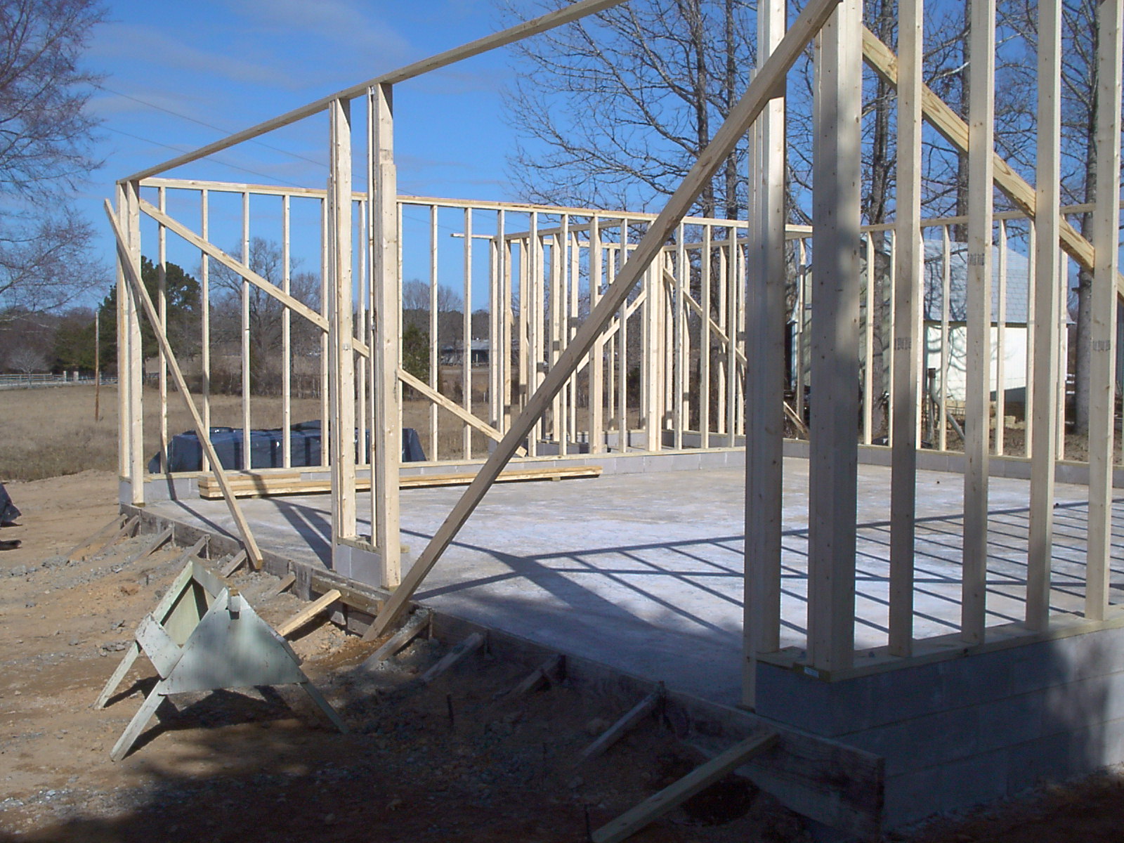

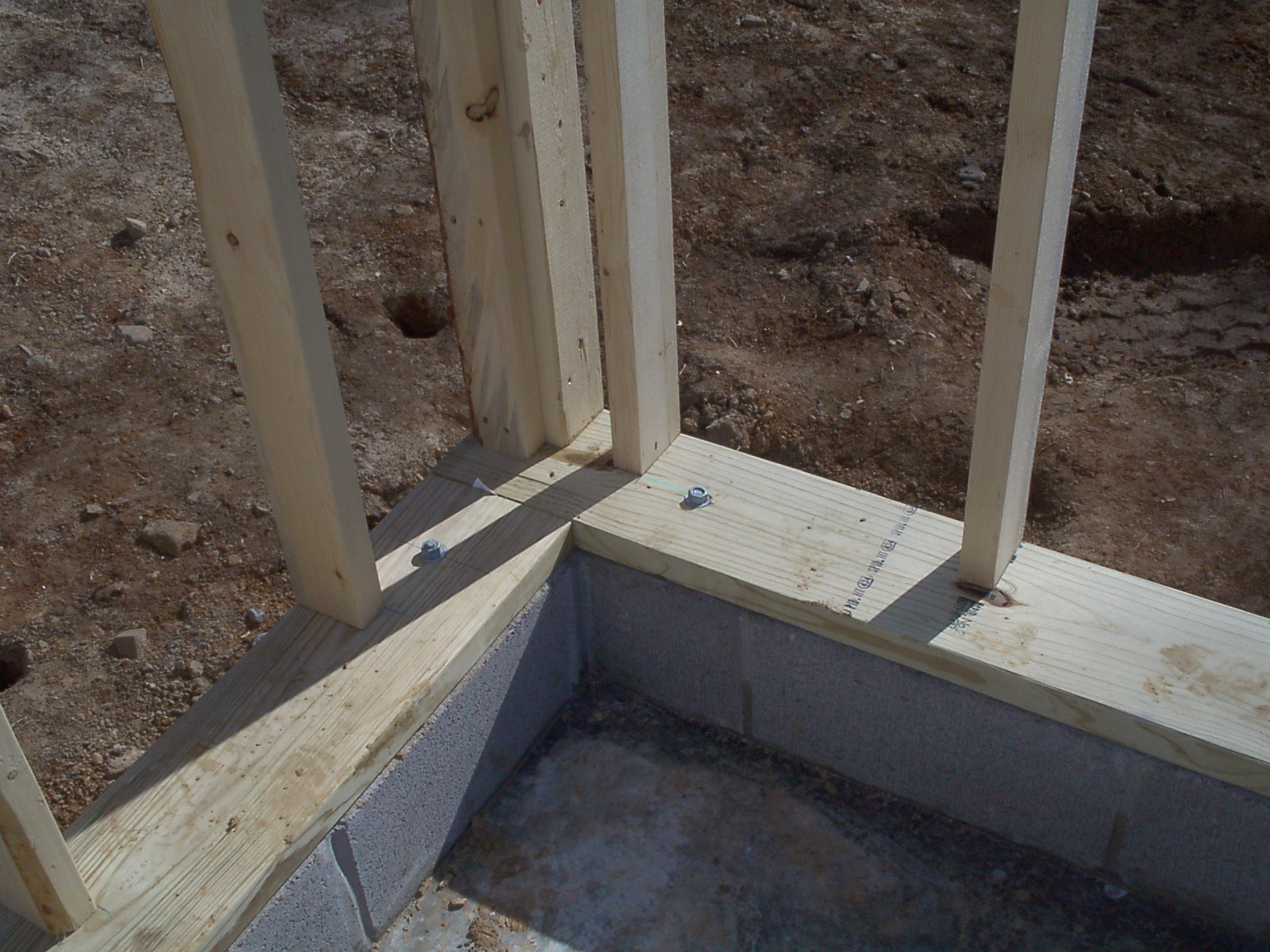

Wall height is not an issue, go high as you like with standard CMU block. I have seen them more than 25 feet tall on many electrical control rooms. Just have to install rebar in the blocks and grout it in. If you dont go more than about 12 feet high, you would probably be ok with #4rebar in ever 4th cavity. I put a 18 x 18 footer under my barn but I dont have more than a few inches of frost line. My builder used CMU for making the forms for the slab as seen in the photos. He left the front side open to allow the concrete truck to back into the area and work out to the front where he quickly installed the outside wall form and poured it on out. I then had him install one course of blocks on top of the slab so I could water wash my floor and not wet the walls and also raise my ceiling height. On hind site, I should have put 2 courses up to raise it even further. I used standard 2x4x 9' lumber for the walls and when mounted on the 8" block and the 2x8 wall plate give me almost a 10 foot ceiling. I insulated all the walls and ceiling with fiberglass bat insulation and sealed all interior walls with 3/8 plywood. It is fairly sound proof and sunlight coming thru the garage door windows warms it up pretty good in the winter. I would think that wood construction would be lots cheaper than CMU even at .65 per block. You still have all the mortar to purchase and as someone said handling a 16" block and mixing the mortar and laying the blocks is not for a single person to handle. Mine is 30 x 52 fully insulated and wire for lighting, 110 and 220V power and cost me $25,500. All I did was pretty much level the slab area. I left it sloping to one side to give me a higher shed height on the left side which came in handy when I got my LS P7010 with Cab as if pretty much takes the full height to get it in under the shed where my Yanmar is parked in the photo.
I put in one 16 foot door and one 10 foot. I keep my boat on the 10 foot side and my workshop is on the other.
