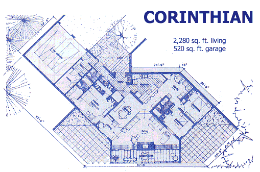

We live in an earth sheltered home. It was built in 1984.It is open in back for 2 car garage and 2 intrance doors and in the front on 3 sides. It has regular swinging doors in the back and 1 inch thermopane sliding doors in front. It has a 36' greenhouse on the front facing south which gathers a lot of heat in the winter on sunny days. In this greenhouse is a 10' long brick and concrete fireplace that goes from floor to ceiling and it absorbs a lot of heat and transfers it to inside. The house was built with concrete walls and has spancrete for ceilings, it has the grooves and was sprayed with a small popcorn type spray. The spancrete is the same stuff used on bridge overpasses. There is about 3' of dirt on the roof. It is pretty efficient in that when we leave for a few days and turn the heat down to 50, it doesn't kick the furnace on even when it is below freezing outside. It is basically a basement, but does feel like a warm inviting home. Lots of light from the 6 patio doors, 2 -10 footers and the rest 8 foot span. The fireplace is connected to the air ducts and has a 3 speed fan that will heat the whole house with wood, it doesn't take much to run you out, I know this cause my wife loves to keep it burning. I think these were one of the early ways to try to go efficiant and in our case , still does. If you are interested just go to Davis Cave Homes and you will see their idea of how to build earth friendly homes. The ones below are our plan, but was modified slightly by the people who built it. John
