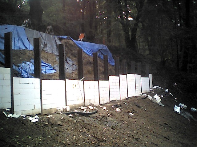

I have always been an experimenter with construction methods
and materials. Here is a soldier pile retaining wall I designed using
steel I-beams and a 4" thick ICF between the columns. This was
for a failed section of roadway in an area that the county stopped
maintaining, so the neighbors got together and fixed it. The best
contractor bid was somewhere north of $150K. Cost of construction
and materials was about $25K.
People who want superior alternative construction for their own house
often fail to accurately guage the impact of government oversight.
Getting building permits for an alternative method can be tough enough
for code-approved alternative methods. Non-code-approved methods
can be VERY tough. Manufacturers of ICFs have done the work to
get code approvals. Other alternative methods (e.g. straw bales,
rammed earth, etc.) may require extensive engineering certifications
and sometimes even testing. I remember an article in Fine Homebuilding
about 20 y ago where a guy wanted to build a straw bale house. His
first choice of location in WA refused to let him do it at all. He eventually
built it in rural Nothern CA, but the bldg dept made him build a test
structure and test it to failure.
