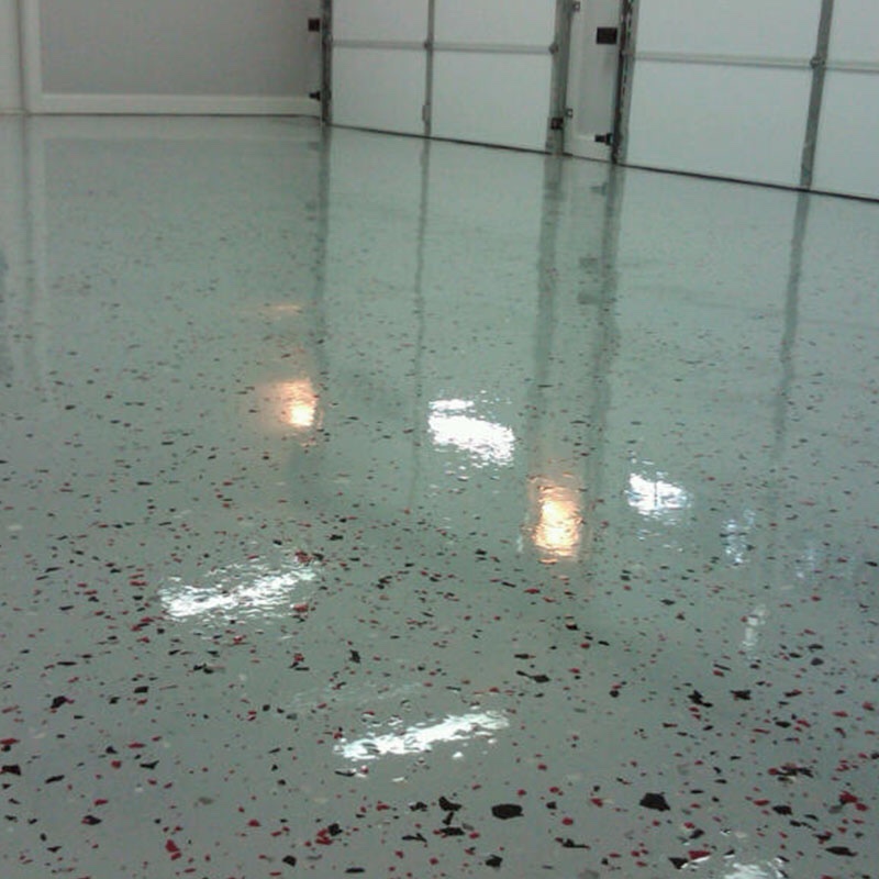

Oh that’s cheap compared to some of the stuff.
