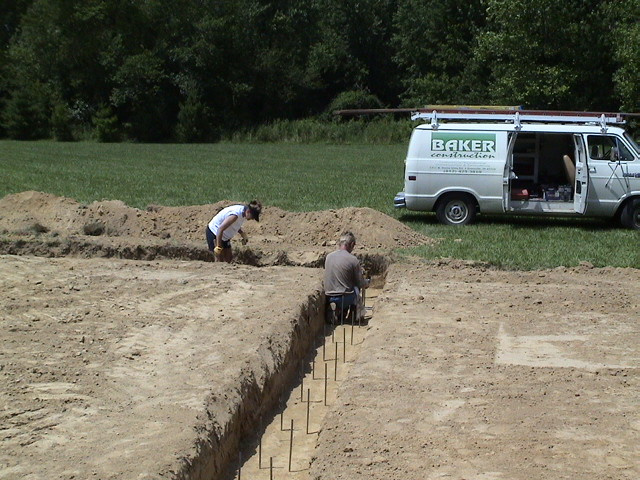

Here's what I mean about rebar pins and how to locate the rebar in the side of the block wall. This isn't a pad, it's footings I'm getting ready to pour in 2 days. See the 3 holes? You just make sure to pack plenty or concrete in the holes to help secure the rebar before you start the footings.
here's the front wall. 3) #5's in each trench. I just twist tie them to the vertical pins. All the pins are set to the top of the footings, so every 5-6 feet I have a set of "locator pins" to know how deep the footing concrete should be:

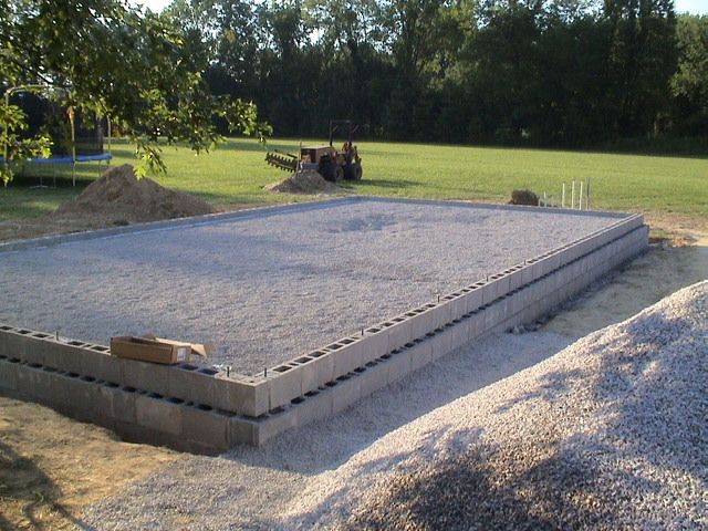

Nah "builder", you get your wife and good friend to do the work. You know, as the operator, you can't get off of your machine! Look here...

Builder said:
BTW: Those footings are too shallow for my zone, must be down south.
Well...actually, they are deeper than you'd think. That entire area is now filled about 36" above that current ground level. The footers were poured 24" wide X 14" deep with 4 runs of #6 rebar. The ground level is just over 3 blocks high from the top of the footers. What you don't see is the fill from digging the swimming pool plus an additional 18,000 sq. yards of dirt from digging the lake.
This picture may give you a bit better of a look. You can see where the brick ledge is and, maybe, you can see the three rows of block. I moved thousands of yards of dirt and poured just over 100 yards of concrete around the pool area in front of the pool house (which is what that footer is a picture of) The footer is a bit heavy for a pool house because it's a two story building.
