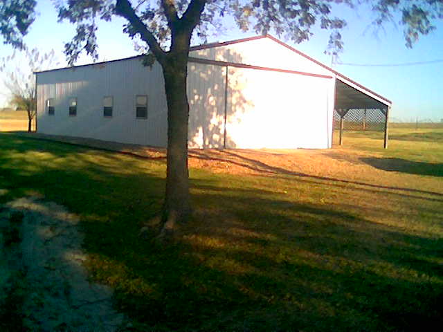

I had a 30x50 wood framed pole barn professionally built. I came in later and had a 5 1/2" (height of a 2x6) "floating" slab with #3 (3/8) rebar on 18" centers. The crete spec was 5 bag mix (5 bags of Portland cement per cubic yard). I was present when it was poured (fed the crew a BBQ lunch) and insisted the rebar was in the mud, not pressed down under it.....It paid off as mentioned later. I didn't think I would need a beam around and through the middle as the slab was floating and I figured it could follow the ground if.....when it moved, unlike a brick house with all the weight on the slab. Course a tin shell building isn't very heavy but it's in the ground, not on the slab. Turn key on the crete was under $6000 in Jan, 2005. I had the site prepared so it was just concrete materials and labor. Probably at least 1.5 x that cost today as for one thing, this area is growing, new interstate and toll roads going in as fast as you can blink, the sand and gravel trucks from Okla. are everywhere. It's a commodity in demand.
I built the shop on the side of a terrace...will load a pic at the end.....I think. With our changing weather patterns of the last few years the Houston Black Clay soil, well known for it's shrinking and swelling, has shrunk out from under parts of the slab and I am this day in the process of jacking my building back up and looking to a concrete mud pump to pump mud back under the slab to right the broken corners....worst is 5" down at the corner. The rebar has done it's job in keeping the broken pieces intact and not floating off. Knowing what I know now, having a beam poured would have held it and it probably wouldn't have cracked but the building would have still sunk. If you put your building on the slab, like a house, it will all move together but you have to secure your building to something and the higher (mines 12' at the top plate) and wider, the higher the wind load. Burying anchor points in the slab works great on metal framed buildings as you can just bolt up to it. However I have stacked one ton skids of feed and materials on it and that may have helped it's demise plus a 10k# JD tractor and my shop things.
I brought in the same kind of fill that is under large buildings in the area but it matters not when the soil under it shrinks. If I were on sandy loam I wouldn't be having this problem. Can't say about up north where you have freeze/thaw conditions to consider which probably as bad as my clay.
A building is never large enough. Once you get it you dream up all kinds of things to put in it. However, my 30x50' with 15x50' roof extension has served me well in retirement. It serves my farming and other necessities and interests and I haven't outgrown it. I get a lot of use out of the shed part which has a gravel floor. The deere is gone and my current Branson is kept under there with other things. I have a double side door 10x10 that gives me access midway down the building.
