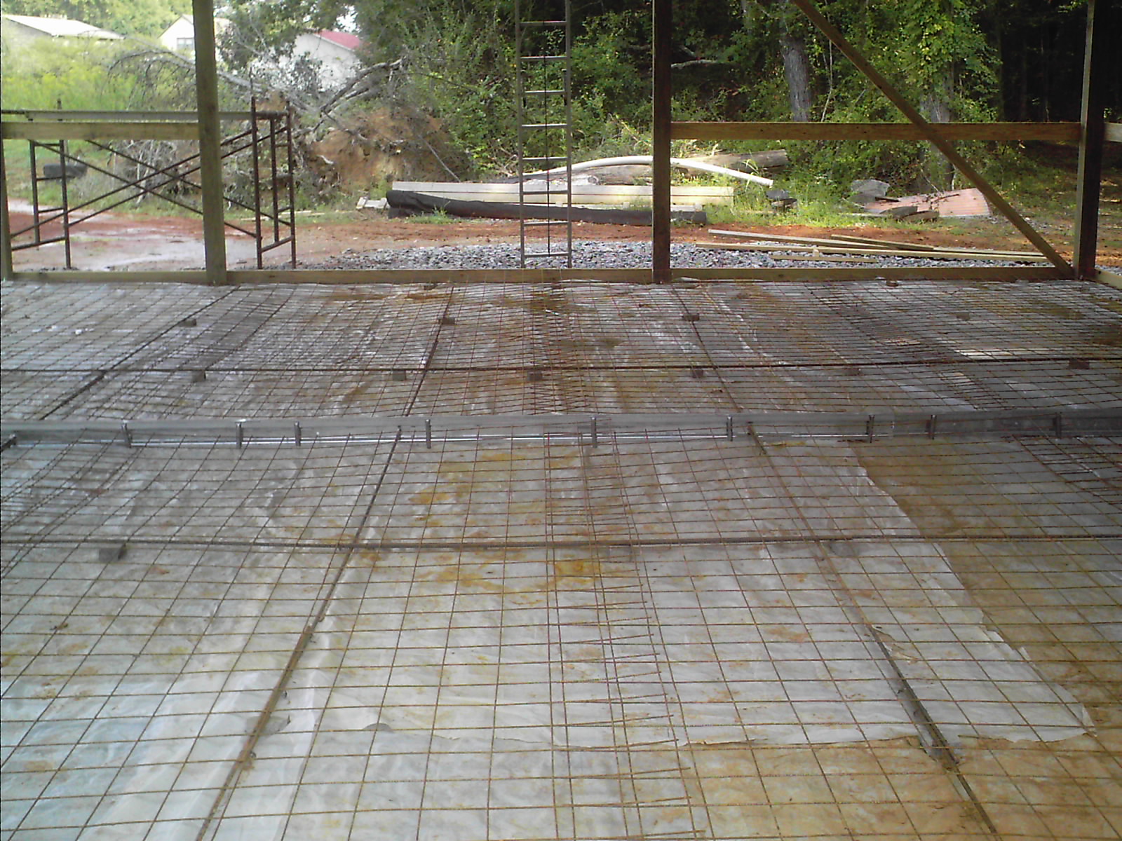

I went 6", rebar and remesh not the rolls.
I doubt there would be a problem with an RV on 4". I was concerned with backhoes, dozers etc that have some really heavy point loads.
I would at least go up to 4000 psi concrete, you are probably getting speced 3500
Problem with putting rebar in 4" concrete is it sometimes creates a weak point in itself if it get's to close top or bottom. If you think about it, 4" concrete is usually only 3 1/2" then put a 1/2" piece of rebar in there and you have 1.5" on each side if it is perfectly centered. 6" gives you a little more leeway to work with.
This is what I ended up with, not sure it is right, but nobody said it was not enough, and plenty said it was too much, but the only downside I heard was the extra money I "wasted". I figure if it cracks and comes apart now, I will feel I did everything reasonable. If I had done less, it would eat me up.

I think you have a nice layout there, but why space the rebar so far apart? It really won't do much with that kind of spacing. I go max 2' square spacing.
Been doing that for decades and no call backs. In fact, one of my customers stores MACK 10 wheelers on a floor I poured for him that way over 15 years ago. 5" thick, rebar on 2' centers and no cracks! :)
