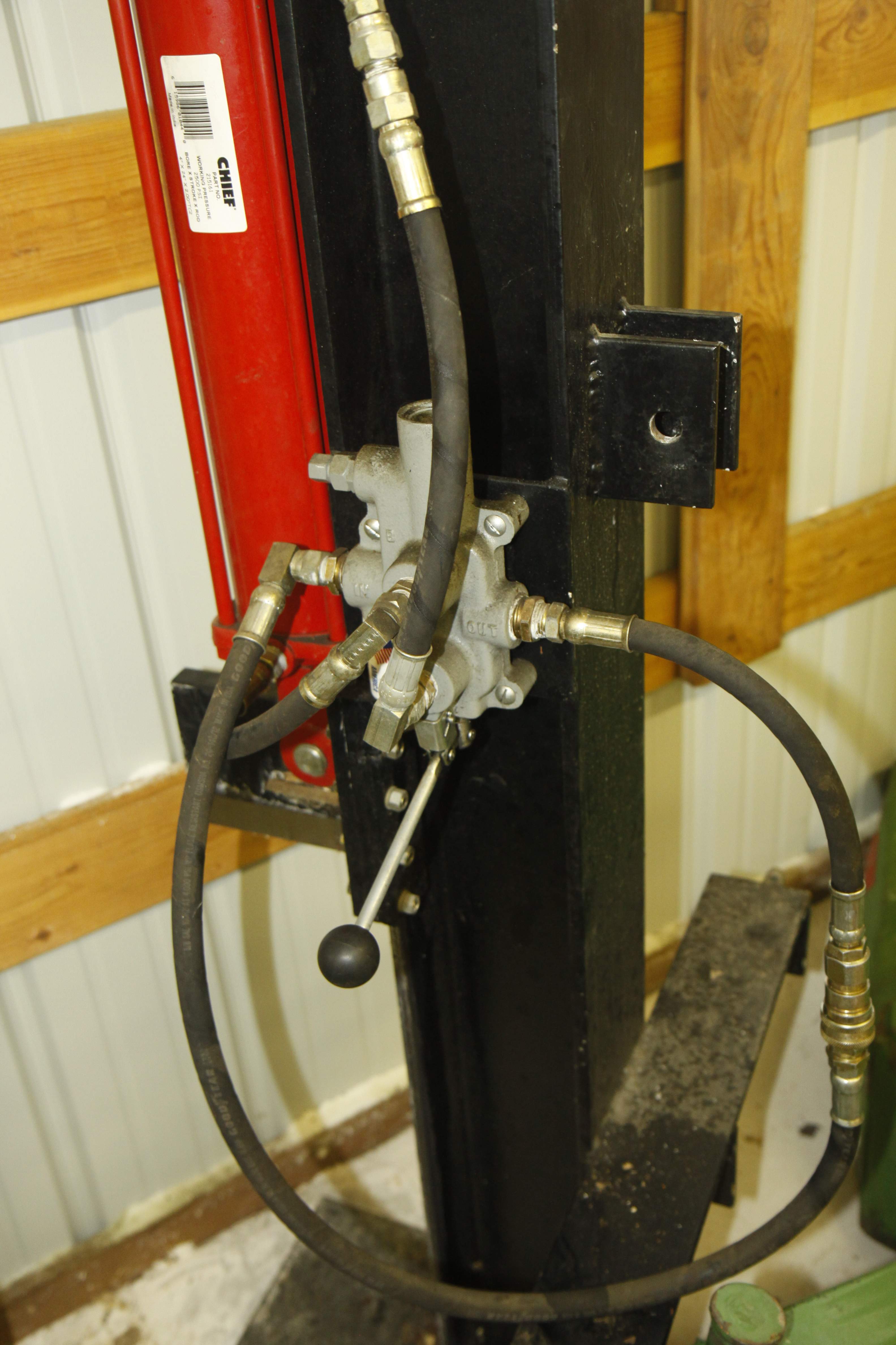

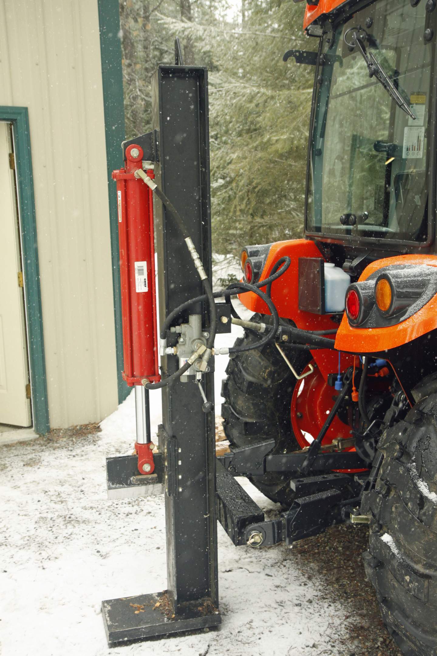

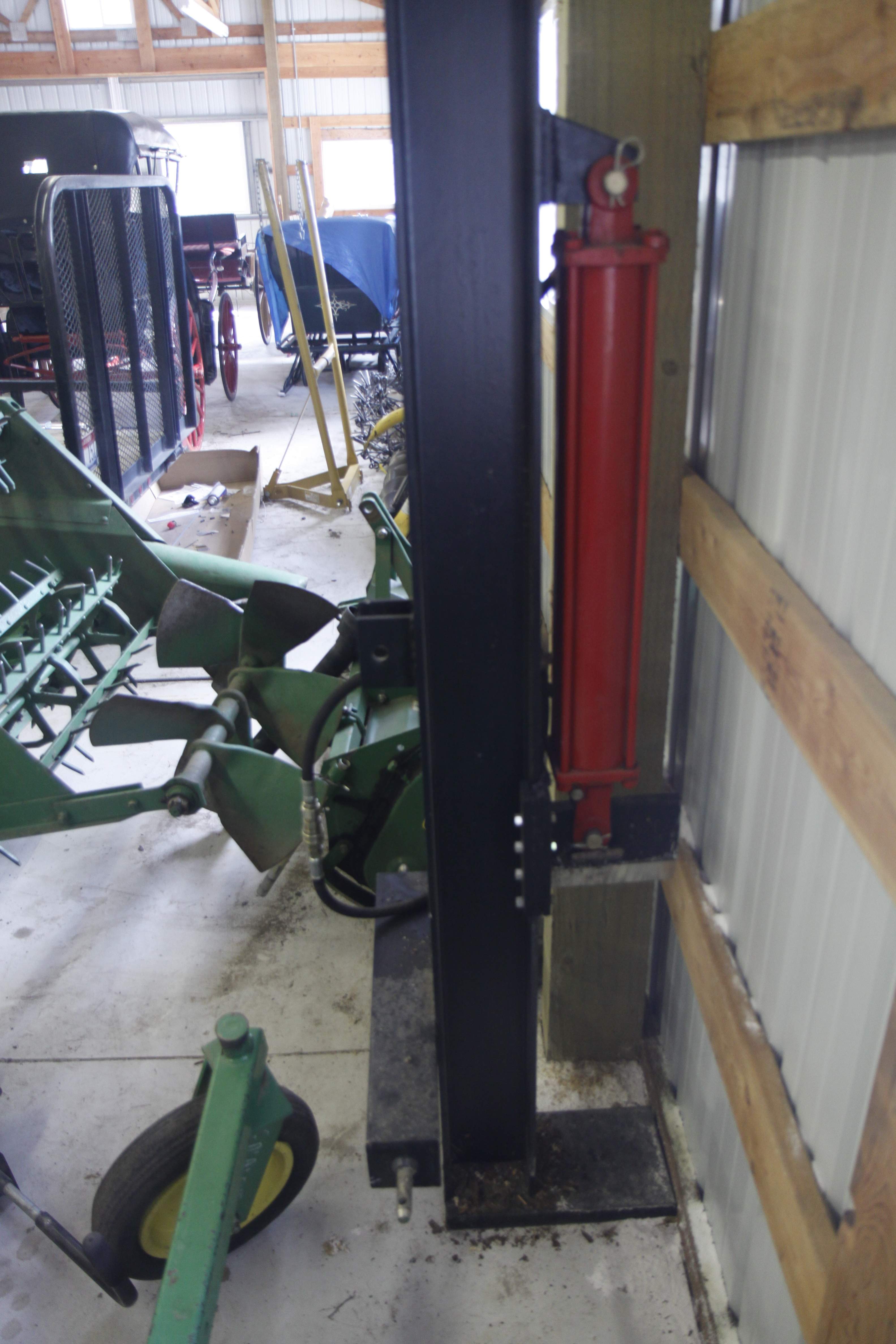

do you have rear remotes on your tractor. i dont think 3rd functions have a detent lock in them. you have to have a rear remote to operate the log splitter. on my kioti i have 2 rear remotes. one had a detent (lock) and the other does not. i use the non locking one for implements such as a snow plow that you want to move just a certain angle then stop. i use the detent remote for devices that need to constantly run like the log splitter.
personally i could care what hours are added to my DK45 cause thats what tractors are designed for...long run times. I have lots of smaller engines and they dont need much maintenance as i only use non ethanol fuel. but i want my splitter with me as i split wood out on the acreage. 3 point is easiest for me. i made my own maybe 15 years ago. as is stated, not fast but fast enough. and i still have all my fingers. _MG_4733.jpg _MG_4724.jpg splitter 6.jpg
personally i could care what hours are added to my DK45 cause thats what tractors are designed for...long run times. I have lots of smaller engines and they dont need much maintenance as i only use non ethanol fuel. but i want my splitter with me as i split wood out on the acreage. 3 point is easiest for me. i made my own maybe 15 years ago. as is stated, not fast but fast enough. and i still have all my fingers.View attachment 668431 View attachment 668432 View attachment 668433
Mine looks very similar to yours, except mine doesn't have the valve/handle on the splitter. Just the 2 hoses coming off the cylinder. So for mine, I use the spring remote, not the detent one. I fabricated a handle that slips over the lever, and comes out the rear of the tractor, for splitter operation. Pull to split, push to retract.
