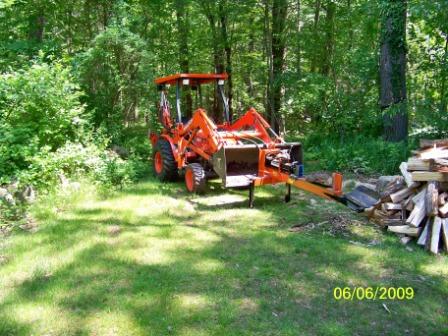

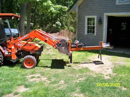

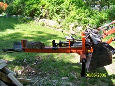

I run an adapted 3PT splitter on the front of my B21 from the BH connection and longer hoses. I bought the ramsplitter 25 ton and they put legs and a stand on it and can remove the stand and put the beam near the ground for the big logs.
I use the BH to lift and hold logs - cut about a half cord, then swap the hoses back to the splitter and start splitting.
