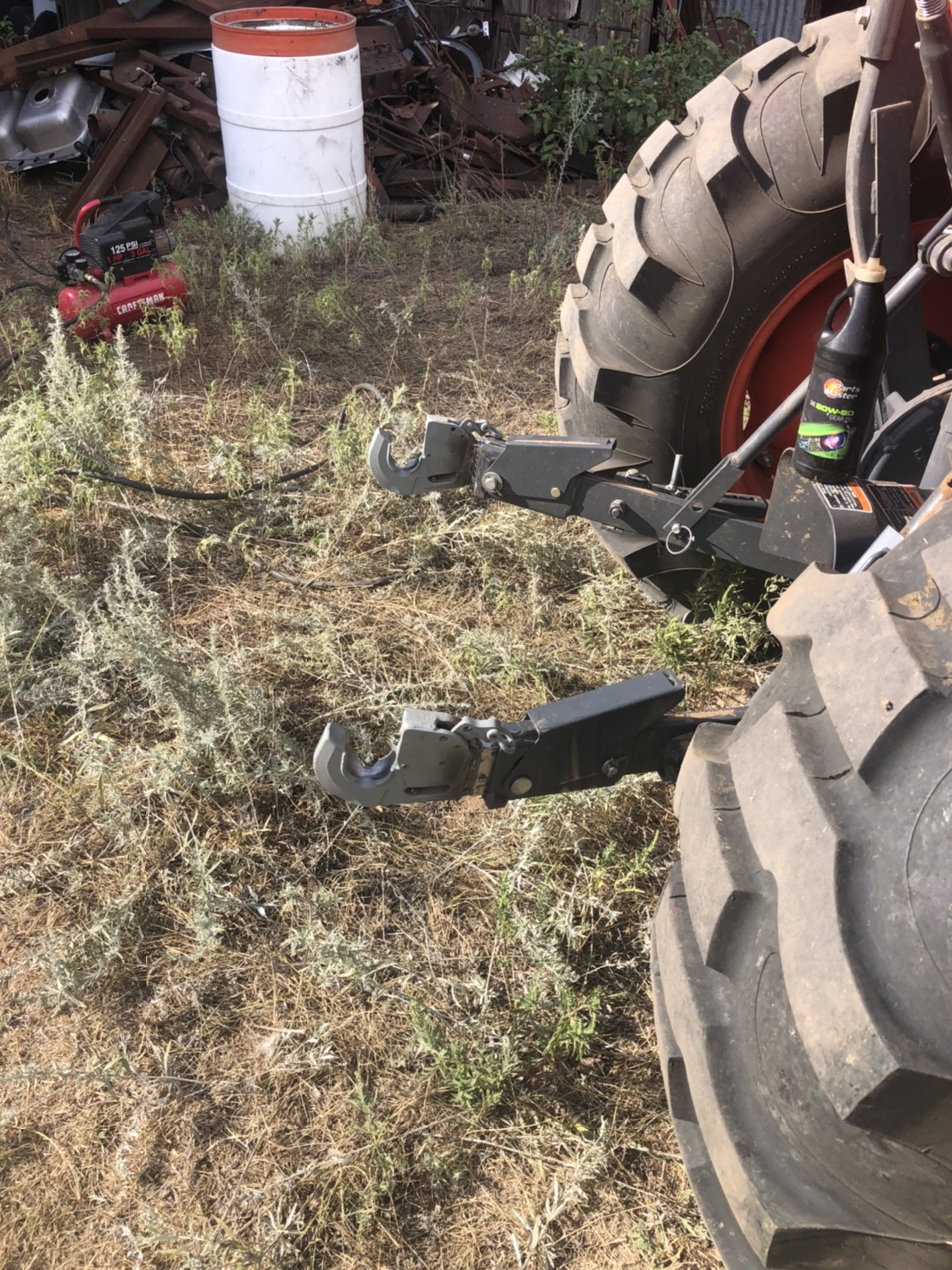

Been wanting to add these for several years and finally doing it. Ordered the weld on hooks and an assortment of balls from Fit-right hydraulics.
I have some class 1 and 2 as well as some nonstandard implements so decided on these. Ordering from Brian was quick and the hooks showed up well packaged.
Plan on fabricating new extendable links to weld the euro-hooks to.View attachment 749361

I called him and told him what tractor I was putting them on and which ball sockets I needed.
Been a while since I have added pictures so that may be the issue with the attachment.
They look like what agri store sells but fit-rite had them in stock.
I had seen on a previous post that he sold them.

Agree, trying to modify all my equipment to standard width was going to be more work than fabricating new ends , this also won’t ad much to the length of the arms. Hydraulic top link may be next on the list.
/ Adding euro three point hooks
Have had these on the tractor for a couple months , definitely worth it . Does extend the arms some so I may have to get a longer top link.

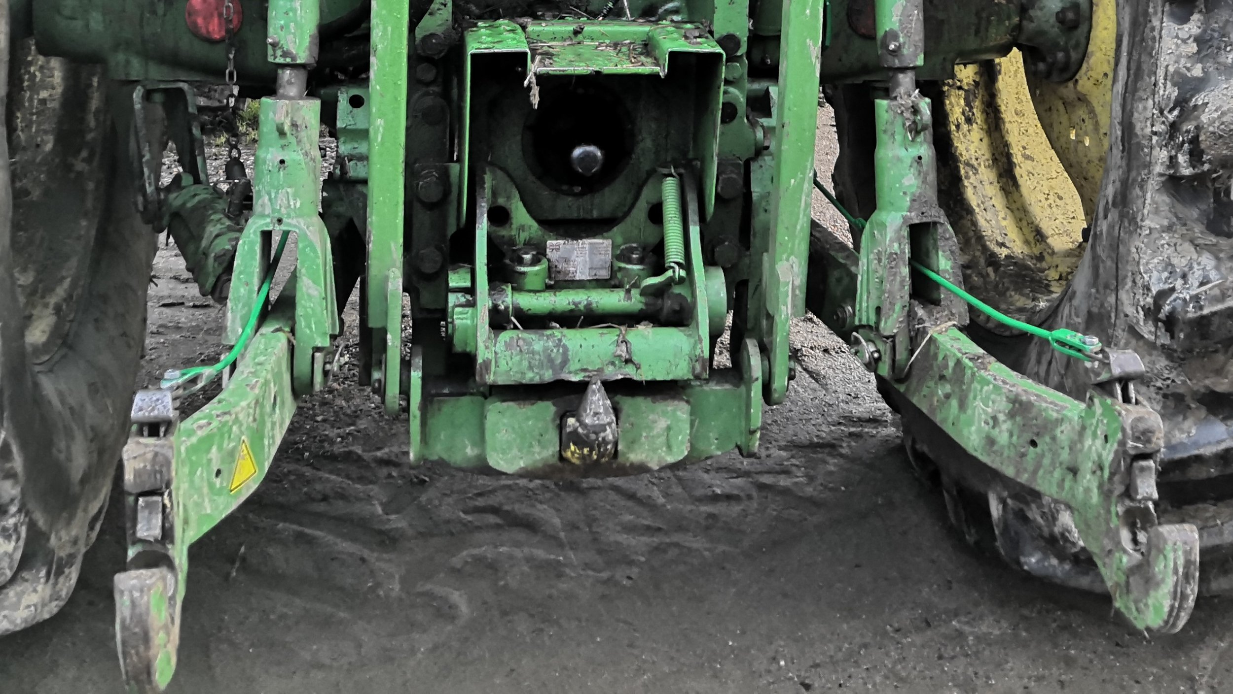

/ Adding euro three point hooks #17
QH is good if you have all your and your neighbors tools made with standards.
EURO HOOKS are not QH
But we can adjust them from the cabin very easy.
Some welding job.
I have made universal both QH and EURO HOOKS but I like light Euro Hooks much more.
QH weight is 50 kg, Euro hooks 10 kg.

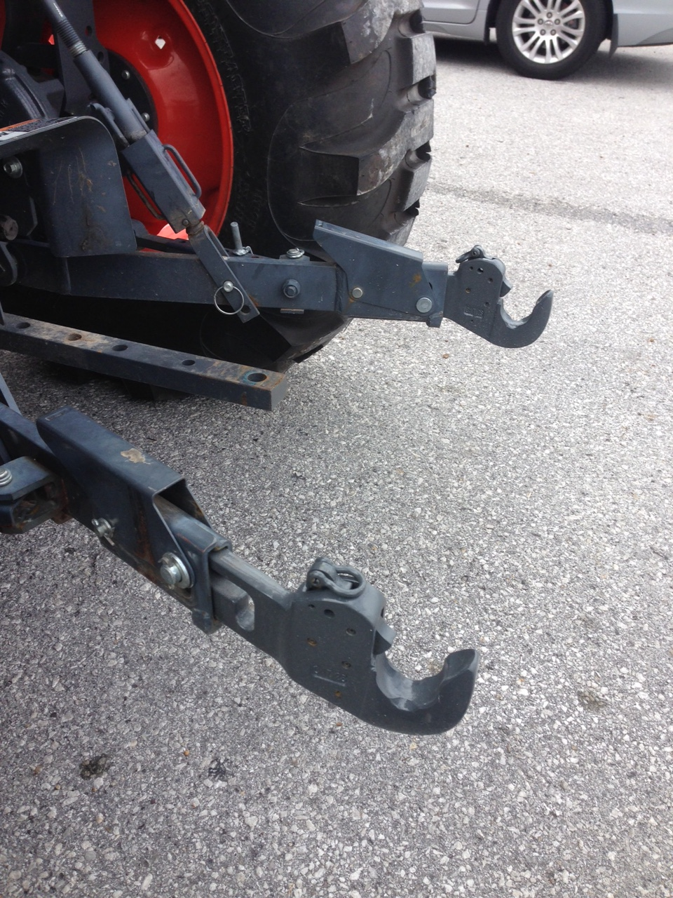

It's basically the lower arms with just the welded hooks.
You can buy a set from Fit Rite (@MtnViewRanch) or even send the arms to him and he will take care of welding the hooks.
Here is a picture of a LS M3.35:
/ Adding euro three point hooks #20
Hopefully Euro Hook conversion kits become available in the USA , I would most likely buy a set
So you need some of these. For your tractor you could go with either the straight cat 1 hooks or the cat 1-2 hooks.
Then it is also nice to have a top link to go along with the lower hooks.
Like ptsg mentioned, you can do the fabrication, or ship the extendable ends to me for fabrication.
