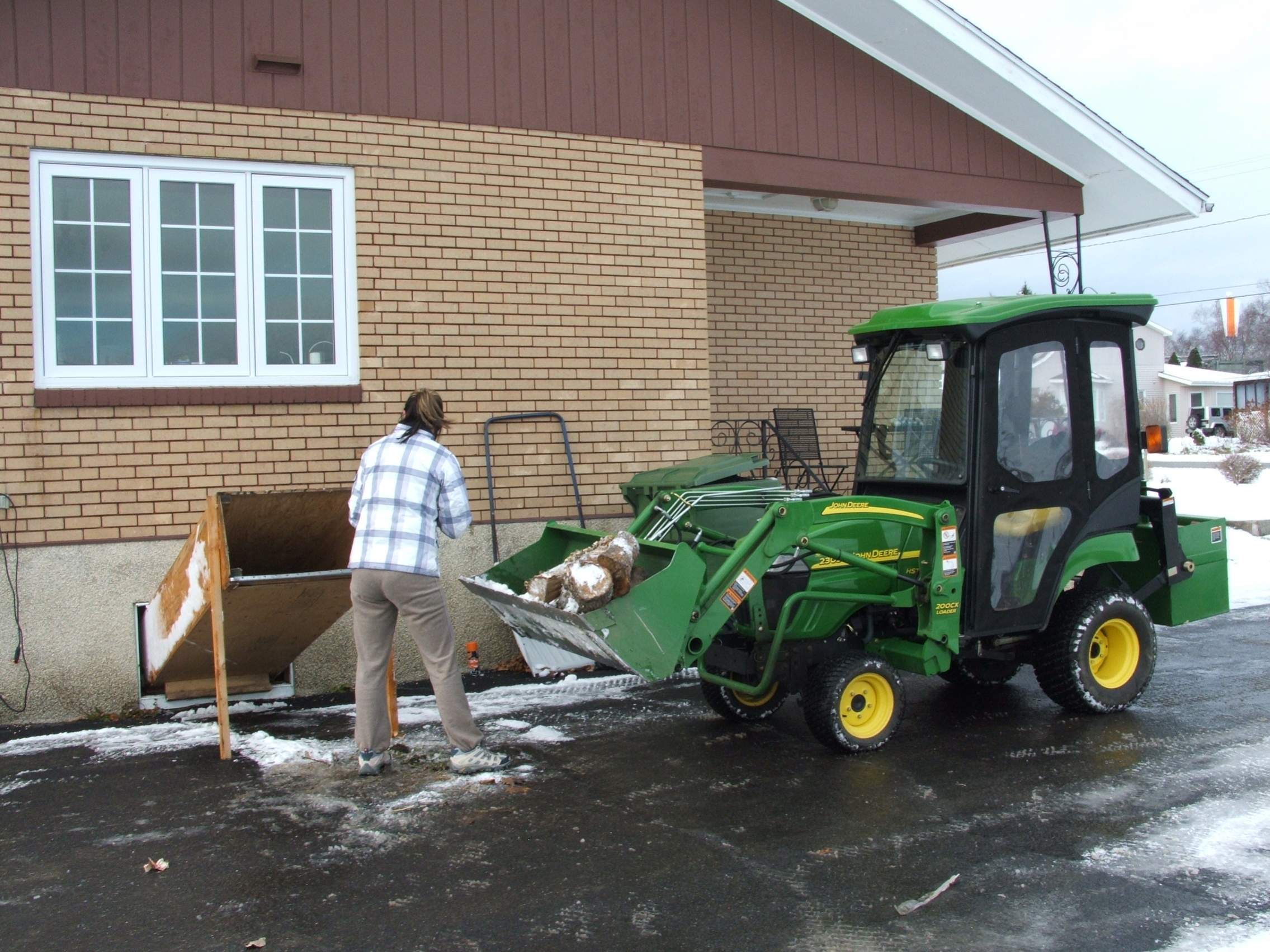

Agree, get the 200cx (parking stand). I paid $3277.00 (Can.) in 2008 and it included the ballast box ($216.00) IMO stick with the standard size bucket 49''. The 2305 max out around 700 lb. so believe me once you have that bucket full of gravel you will be close to your max. and you can add the pallet forks with the quick attach, you don't have to upgrade to the 53'', the quick attach is already included. Yes, you will need the ballast box. Have to agree with everybody else, it come on and of in minutes. I also bought a set of pallet forks and I use them as much as the bucket. The change from the bucket to the forks takes about 1 minute. Just 2 pins to remove and put back in. I've received and install my fel by myself. Not that hard to install if you have the place and the tools but you will need some help to unload and move things around. Total weight is 647 lb but keep in mind that the brackets and bucket are not attach together when it arrive. If you do buy one, you will probably use it more than you think. Once you have it you will find all kind of work for it. Park the wheel barrow. :laughing: Here's a couple of pics. In the trailer you can see the tiller, fel, and in the box is the snow blower.

Henri:
Are you at the other end of that chute, catching the firewood as she slides it down?:laughing::laughing::laughing:
/ Considering a FEL for my 2305 #6
Henri:
Are you kidding? The daughter is unloading and the wife is catching, I'm the OPERATOR. :thumbsup: ps. Don't let the wife read this. :eek:
