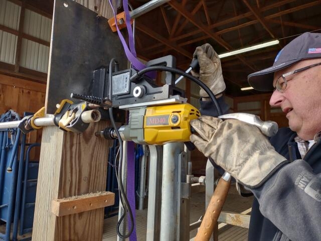

Same boat I was in. We had Hougens at work, but oy they're pricey and mine won't get used enough to justify the cost. I opted for one from Amazon - a Vevor MD40, and use Stick-Kut lube for steel. It's been very useful and works well. My BIL needed to drill 6 holes in a precise pattern through posts in his pole barn. There was a plate for opposite sides of the pole with holes for through bolts. I clamped a piece of steel to the post and used the twist drill chuck to establish location and "trueness". Then went the rest of the way with a handheld 1/2" drill.

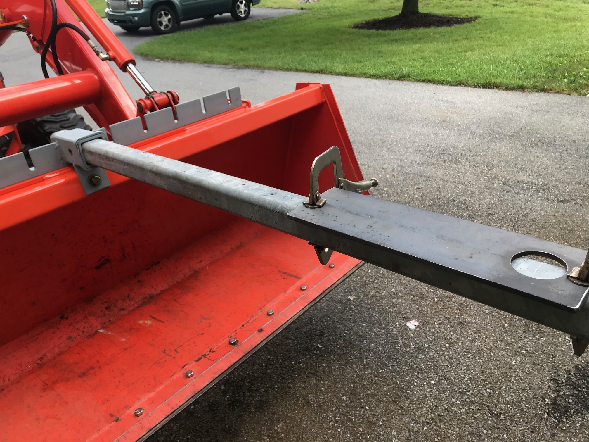

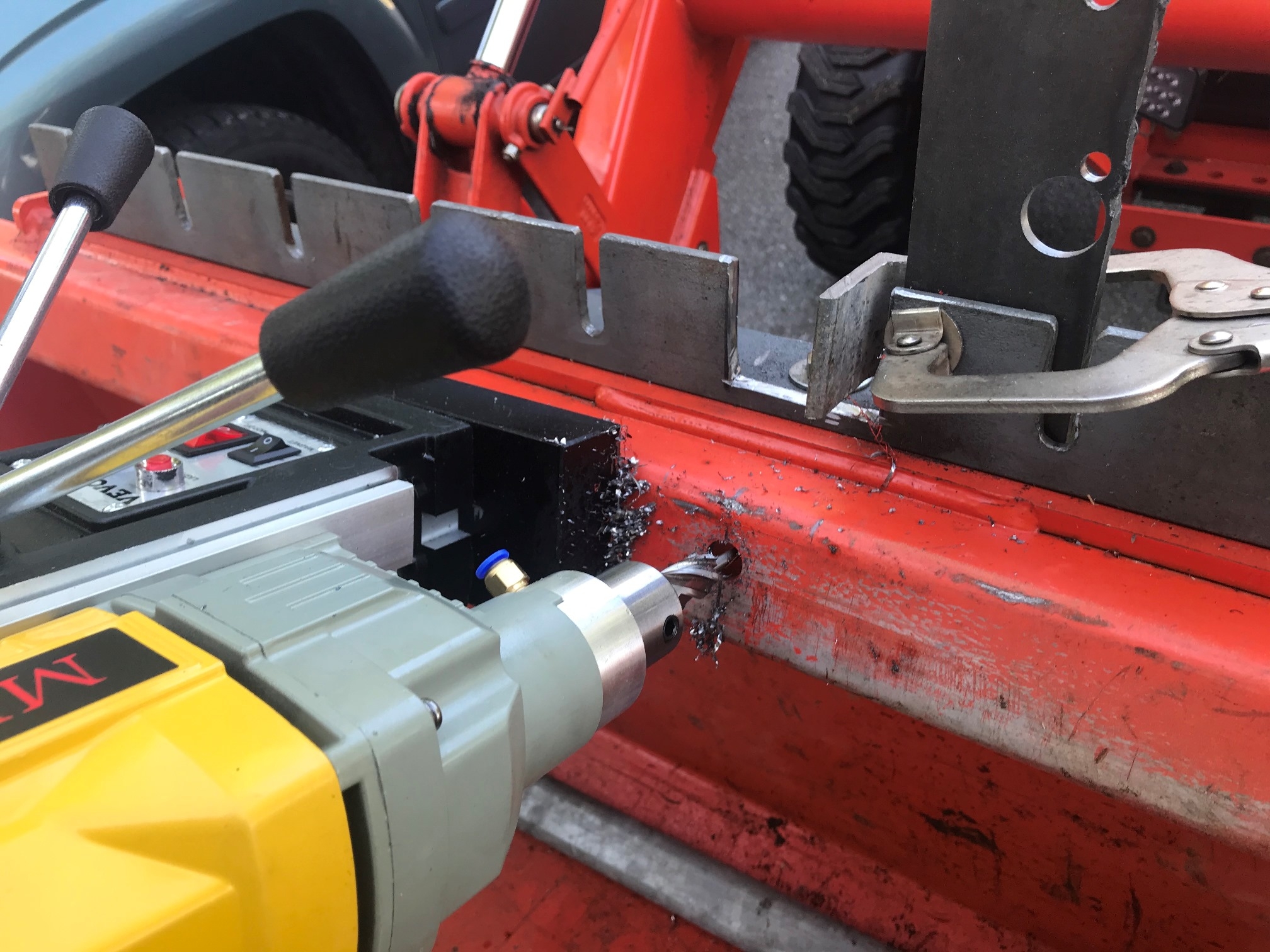

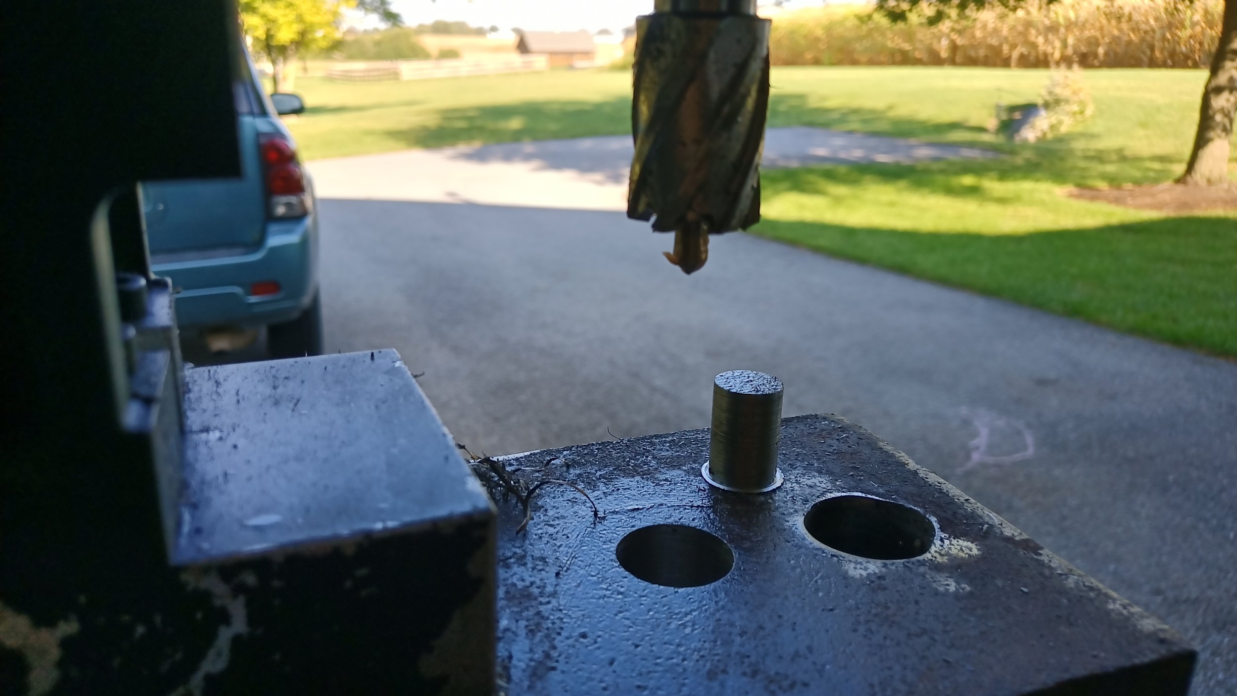

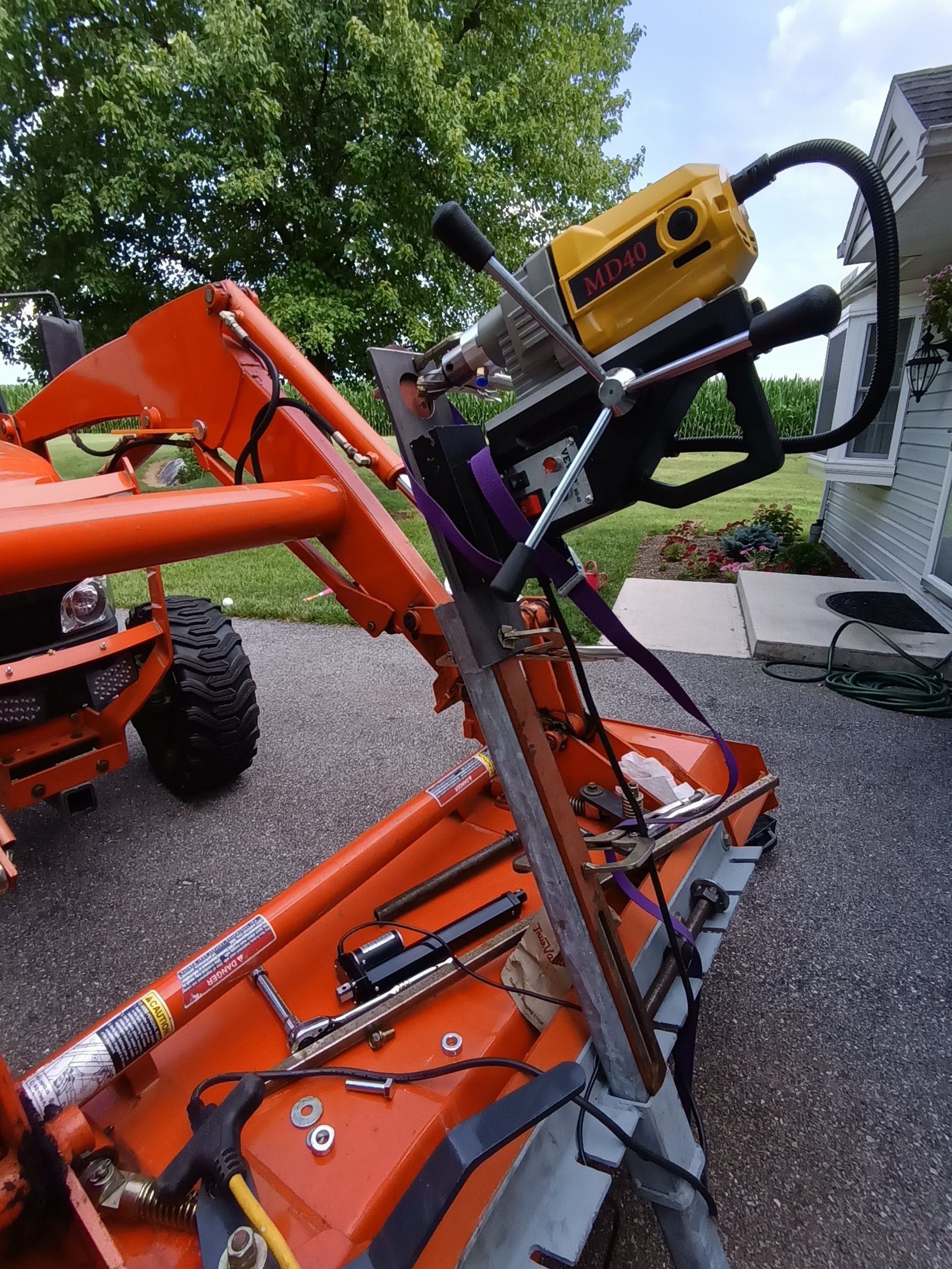

Few pics below. Drilling hole for gusset on the receiver hitch on the bucket. I was a little surprised the metal provided enough surface for the magnet. It was marginal - couldn't really bear down. Second pic is a 1"diameter hole through 1) thick steel. Very fast and easy. Third and last pics are a plate I made for drilling holes in things where the magnet won't work well. Just clamp it in place and drill through the big hole. Fourth pic is the post at my BIL's.
