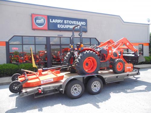

I am going to look at a package deal being offered by our local Kioti dealer. It is a DK4510 four wheel drive with FEL, quick attach loader, six foot bucket, five foot king kutter rotary cutter (pull type), king kutter box blade, and 18 foot dovetail tandem trailer all for $26,995. This seems like an extremely good deal. What do you guys think? I'm going to try and attach a photo off their website. DK4510.jpgDK4510_2.jpgDK4510_3.jpgDK4510_4.jpgDK4510_5.jpg

If the trailer has to be loaded that way to work, then it looks like it would have way too much tongue weight. The first thing I thought of when I read the package deal was that the trailer seemed too small/short.

That sounds like a great deal to me but the trailer sounds too small. Maybe trade up the trailer a bit for a few more bucks.

I figured it was "stuffed" on there that way just to get it home. I wouldn't think you'd be driving it around with the rotary attached on the back.

Might be a good deal but trailer included in the package may not be such a good deal. Looking at the first pic I agree the trailer is too short. It also looks like 5 lug wheels on the trailer so probably a 7K trailer. Tractor is 3390 + loader 1452 + mower 625 + box blade 415 = 5882 lbs. not counting binders and chains.
Trailer has to weigh more than 1118 lb. so with everything loaded on it's too much weight for that trailer IMHO.
