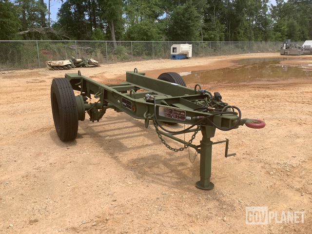

That trailer you are looking at could be fine, depends on how the wheels are attached, $200 seems a very good price. Before spending days making it right, load up 1.5x the weight you plan on having. (I've seen 6000 lbs on a 3000 lb axle). Check how badly the wheels bow out or flatten. Then hook it up and drive around in the worst of your local terrain as if you have a hot brush fire chasing you. If it survives, go for it.
Another option somewhere between a single axle and the M200 trailer would be a small beat up double axle horse trailer. These can be quite cheap, just cut the top off. Make sure it has working trailer brakes if your towing vehicle can't safely stop all that weight on a slope.

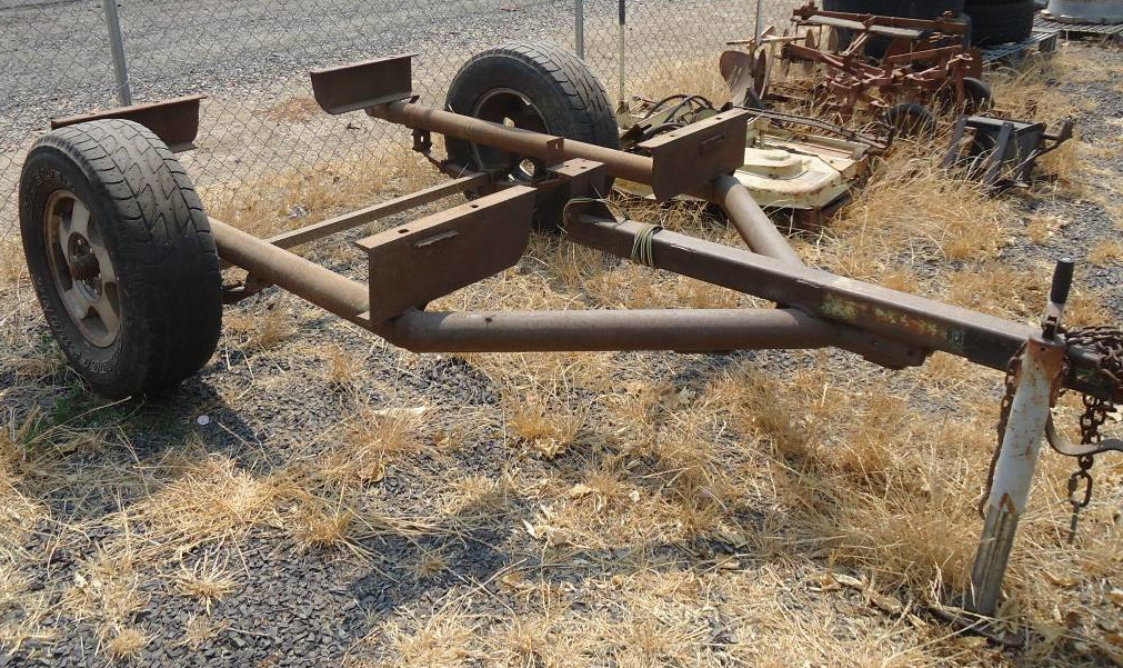

What kind of axle is it? Looks like a small size square rod. ?????
Looks like a 2" 2000 pound - unless it is simply a sq tube - either way, not good. Water is a heavy load. Probably will bend the first bump it hits. The heavy large pipes gives the impression it will load heavy, but that axle does not. Might want to look at the rating of those old tires. What did they load when new?

400 gallons of water is about 3,300 pounds. Be extremely careful of the balance point of the tank so it is tung heavy. I would pop for a two axel trailer minimum.

Do a bit of math!
Water weight is just shy of 8.5lbs per gallon.
For simple math I will use 8lbs/gallon
400 gallons
8
3200 lbs
(Yes it is low by almost 200lbs)
But you now have 300lbs for everything else using your 3500lbs guess at weight capacity.
Everything else is your pump, plumbing, hoses, and trailer frame weight (mist folks fail to include this one, but it is in the axle!)
Bottom line even using your axle capacity, you are way overloaded, then you are on rough terrain, which is hard on trailers.
I suggest looking for a 12k to 14k equipment trailer, even if it needs to be rebuilt, you have a much better base to carry 1000 gallons

The question is, how to determine a likely capacity of this trailer's axles? I see 6 lugs, but from the pic (the ad says nothing) I can't see much more - the brake drums look pretty small. 3500 pound capacity axle?
My thought is probably cut off the risers that held the pickup bed and weld some cross members directly to the round tube such that the flatbed is as low as can be (probably limited to the height of the tongue tube, unless we cut that back a foot and tie it to a new crossmember there). I'm able to do some welding (up to 3/16" mild steel with the current mig rig, but I'm willing to upgrade to weld heavier stuff if I find the appropriate project that requires it (oh no! don't make me buy a better welder!)).
Given that my use would be entirely low speed and very local (ie, pulled my tractor or my truck on my land or immediately adjacent), how tight would you stick to the capacity?
Looks typical of a fuel cube trailer to me and the cube bolted on would be part of the strength so it would only be deigned to carry 1000 litres but would probably carry a lot more if only on your property but there could be the time you just want to "pop down the road with it". May be not.
