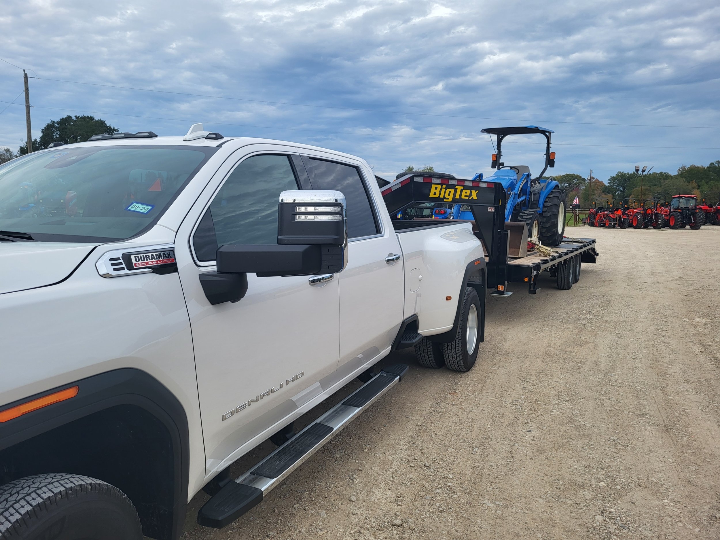

Brother just picked up a BigTex GN with 2 megaramps, deck over for his business.
Tow vehicle is his Super Duty so all good in power and braking.
Towing home empty was the worst ride ever and no comparison to the ease of towing my 12k bumper pull PJ
The bumper pull PJ spoiled more than we thought because it's a dream to pull empty or loaded compared to the new GN
Problem best described as chattering going down the freeway for truck and trailer...
Hoping loaded will be better?

You are the first person I’ve heard say that a gooseneck towed rougher than a bumper pull. My experience is both a better ride and handling with any gooseneck I have owned or used. My gooseneck stock trailer tows so nice that I have to be careful and keep reminding myself that I’m towing a trailer. But the stock trailer is heavier than a flatbed, so that probably makes the difference. No trailer tows smoothly when empty.

Appreciate the response...
Maybe some sort of harmonic between truck and trailer and road bed?
Towed a large 32 5th wheel travel trailer and it also towed better.
The GN is new to us and first time towing was the 70 miles from the dealer.

I think you will notice a big difference with weight on the trailer.

Yes, every truck and trailer combo can be different. What exactly are the specs on the truck and the trailer? Where is the ball mounted in the bed of the truck, the exact placement in relation to the rear axle?
