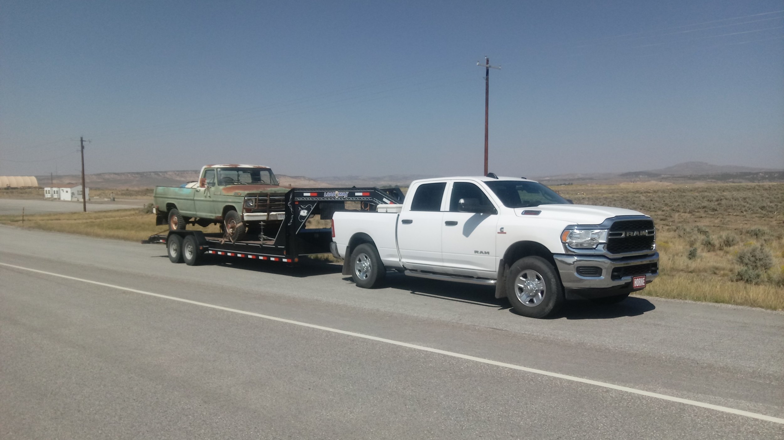

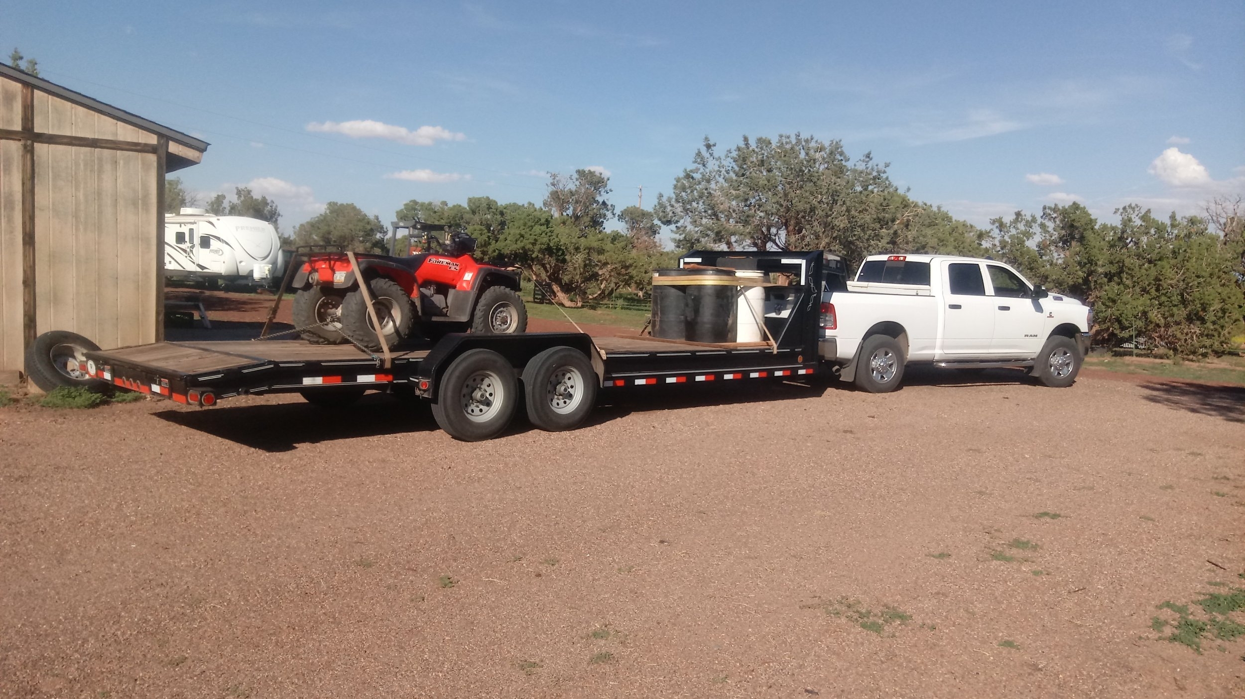

What I have found over the years with different trucks and trailers, is, the balls location. If it is too far forward, the harmonic frequency seems to rear its ugly head. I can't really explain it. It seems to only happen under light throttle, pulling. Hard pulling, coasting and easy cruise, all is well. My '21 with the factory hitch is smooth. My other three trucks that I mounted the hitch on:D, buck. I have them all forward quite a bit. The Ram is almost centered.
