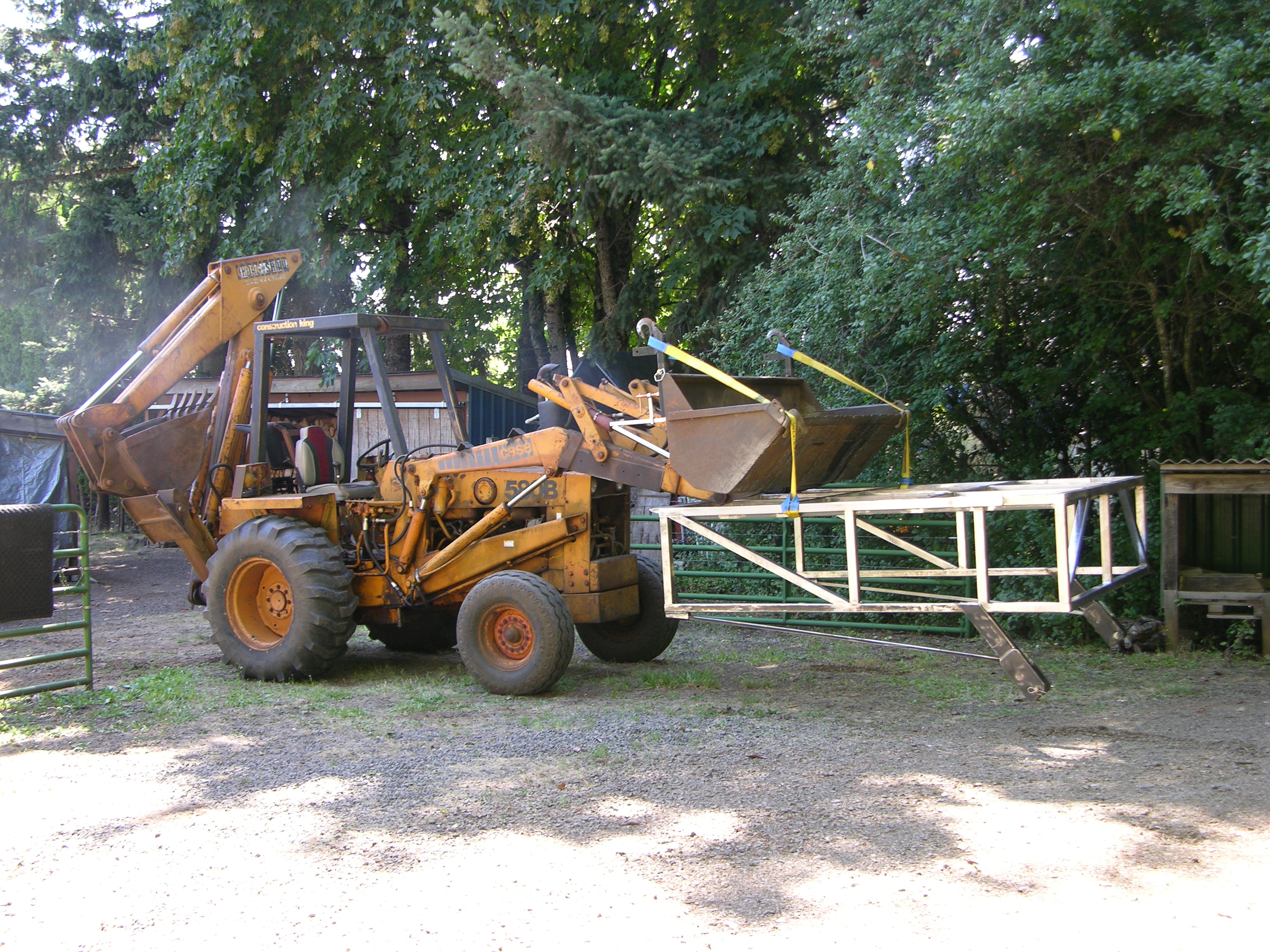

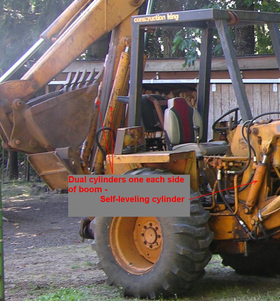

OK, I kinda buried the numbers in my usual blather :rolleyes:
Hoe cylinders -
2 Stabilizers
2 Swing cyls
2 Boom cyls (one each side)
1 Stick(dipper) cyl
1 Bucket cyl
Loader cylinders -
2 Lift cyls
2 Curl cyls
1 Auto level cyl. (Oh, and don't ask me exactly how it works, maybe I'll know when I'm done with ALL of 'em :rolleyes:)
Here's a pic from the brush bucket build, and a marked up version -
Clear as mud, right??!? Steve

Ok first and foremost question is how exactly does that self leveling cylinder suppose to work...........
2 Boom cyls (one each side)<<<I didn't see those ones before, do they same thing as this one?>>>>>> 1 Stick(dipper) cyl Next time I see a backhoe I'll take a closer look, to me sounds like that tractor has overdosed on hydraulic cylinders.

"Ok first and foremost question is how exactly does that self leveling cylinder suppose to work"
There ya go again, I just asked ya NOT to ask me :confused2: - actually, I DO know how it works; just not how to explain it well enough in a short time, and I gotta get up fairly early manana and go get a spare motor for the manlift; but I'll give it a shot manana sometime...
"2 Boom cyls (one each side)<<<I didn't see those ones before, do they same thing as this one?>>>>>> 1 Stick(dipper) cyl Next time I see a backhoe I'll take a closer look, to me sounds like that tractor has overdosed on hydraulic cylinders."
Only by one or two; it is one of the earlier construction type hoes, newer ones went to a single boom cylinder that's bigger diameter, makes plumbing simpler -
Think of a backhoe as just part of a human body - if you plant your feet (stabilizers) and twist your body at the waist (the turret, ran by the swing cyls) you can rotate.
Now, check out your ARM - the upper arm bone (the boom) has its own "muscles" to raise or lower - then the lower arm bone(s) have THEIR muscles (AKA cylinders) and finally, your wrist and hand (the bucket) needs ITS "muscle", AKA cylinder- so at the very least, a hoe needs THREE cylinders just for its "ARM" - Then there's one more cylinder for each "leg"/stabilizer, and the two SWING cylinders to rotate the entire "arm" so you can dump where you're NOT digging :thumbsup:
Chew on that a bit, and we'll get into self-leveling manana... Steve
   / Container Weld Shop build - #325
It is physically connected to the lift circuit so it moves in and out when the arms go up and down, but it is also hydraulically connected to the bucket cylinders.
As such, when the loader arms go up, it forces the leveling cylinder to extend which moves enough hydraulic fluid to make the bucket dump just enough to stay level (in theory).

Aaron, that's at LEAST as clear and concise an explanation as I coulda managed even when I'm NOT sleep-deprived - thanks...
And you're correct about the "in theory" part; mine doesn't quite live up to the theory, so I'm hoping that when that particular "alligator" gets to the top of the pond, a new kit will move theory and fact closer together :rolleyes: ...Steve
   / Container Weld Shop build - #327
Aaron Z
Ok connected to the hydraulic system, that makes some since, I mean when I see it connected to the FEL like the lift cylinders are, I was thinkinking that makes no since how can that keep the bucket level while lifting...........
