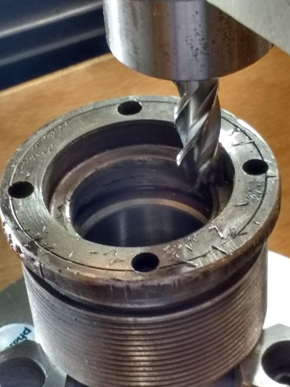

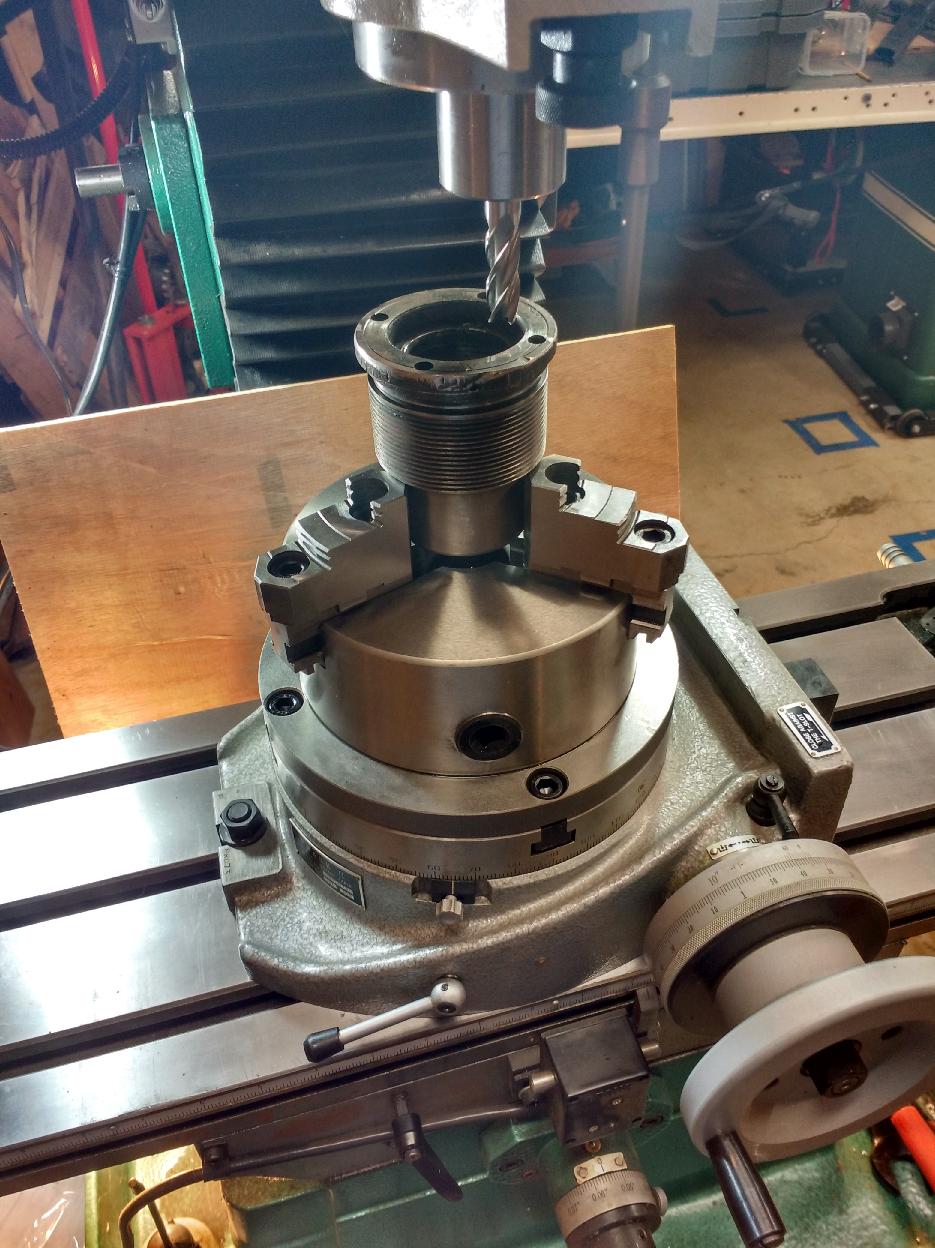

Since the afore-mentioned lathe STILL hasn't happened (for the reasons mentioned) today I used the rotary table/chuck to clean up the outer seal pocket in the gland nut of the cylinder I'm working on - There were a couple of rough spots due to removing the old seal's steel cup with a cold chisel :eek:
centering was a bit tricky, but I got it close and went slow; result wasn't perfect, but good enough the seal should stay put and not leak; therefore it's good enough :rolleyes:
The setup - RoTblSetup.JPG - That big handle on the rotary table turns the table 4 degrees per handle rotation - A lesson immediately learned was that I should have moved the main table so the cutter was on the LEFT side of the pocket, or turned the rotation crank the OPPOSITE direction to avoid "climb" cutting :rolleyes:

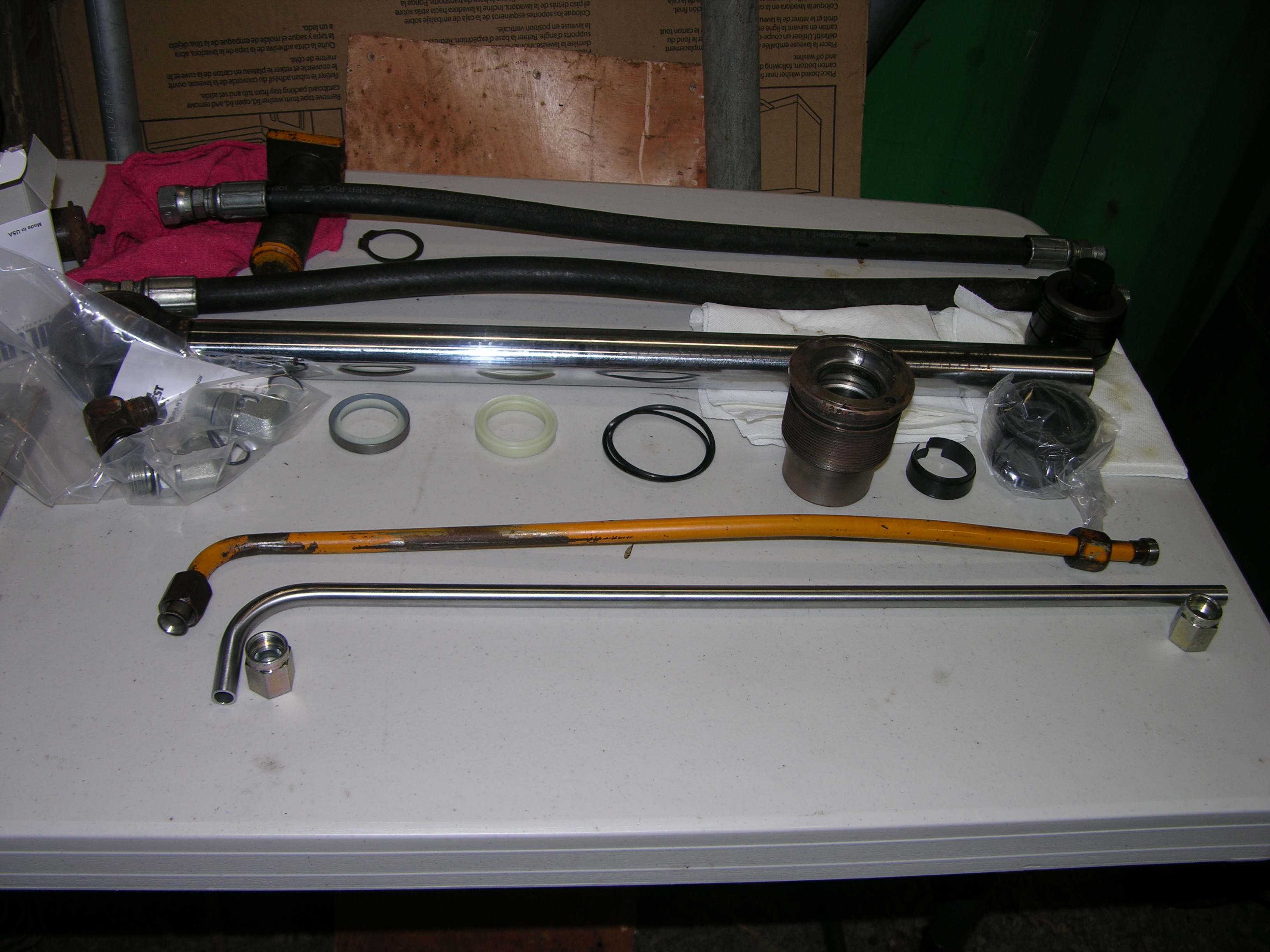

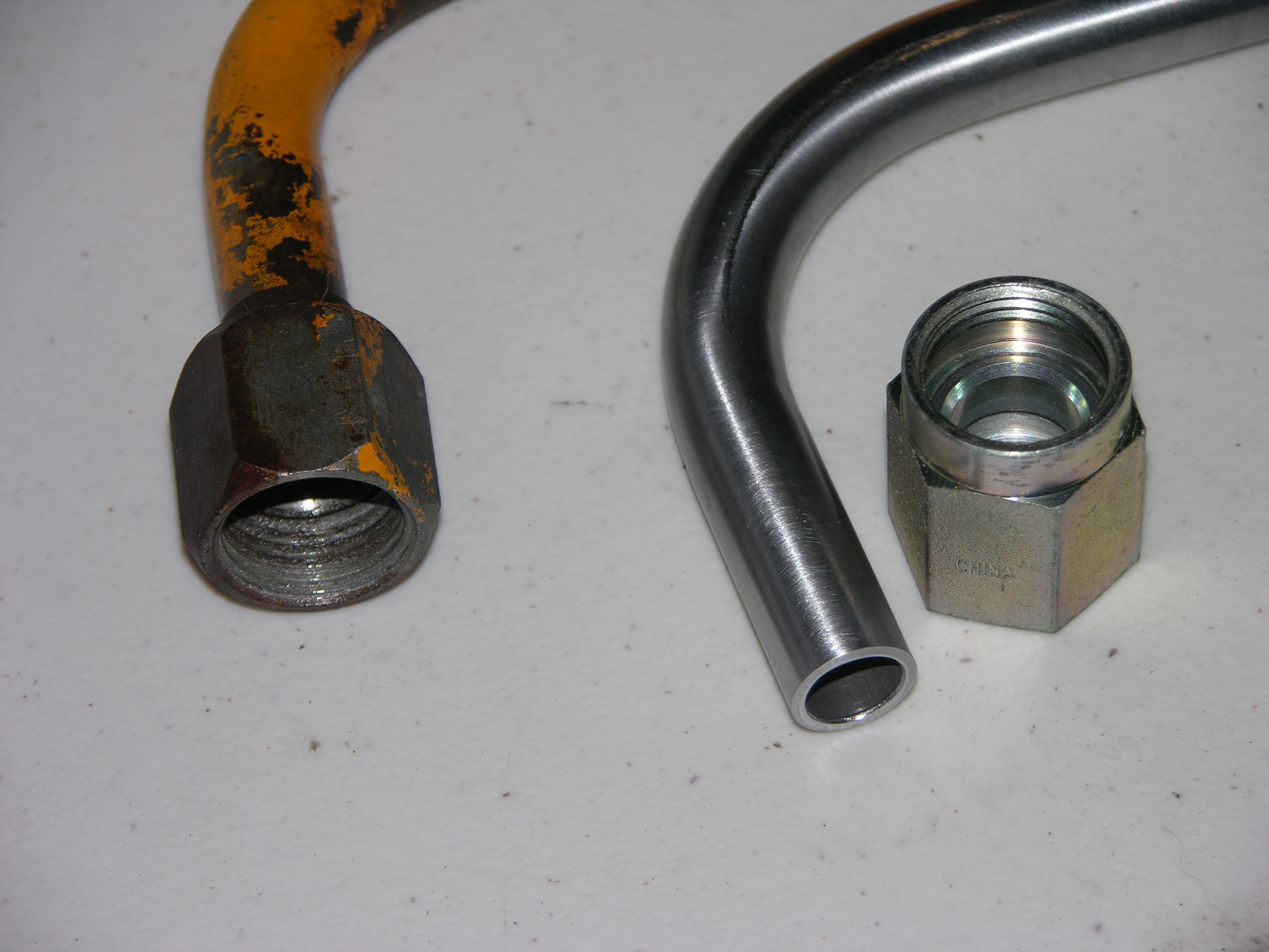

All the relevant pieces, including the new steel tube that brings the rear port up next to the front port (including 2 "convert-a-flare" fittings - basically a swage fitting whose ferrule is shaped like a JIC flare - saves having to TIG a separate piece and/or flare the actual tubing - DSCN3273.JPG
The old and new tubes; nut on the old one didn't wanna come off, so replaced tube AND the ORB/JIC elbow at the rear of the cylinder - DSCN3274.JPG

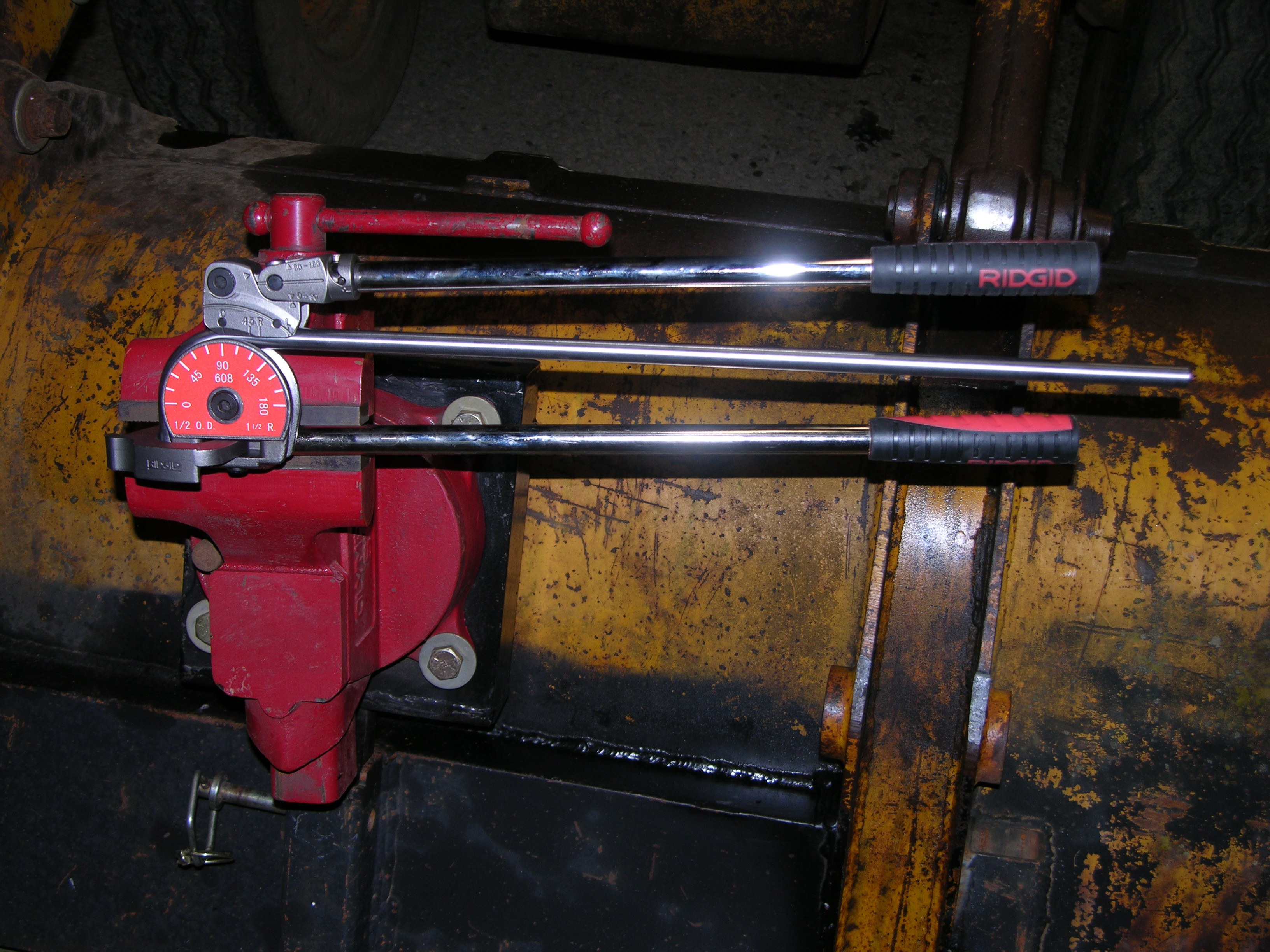

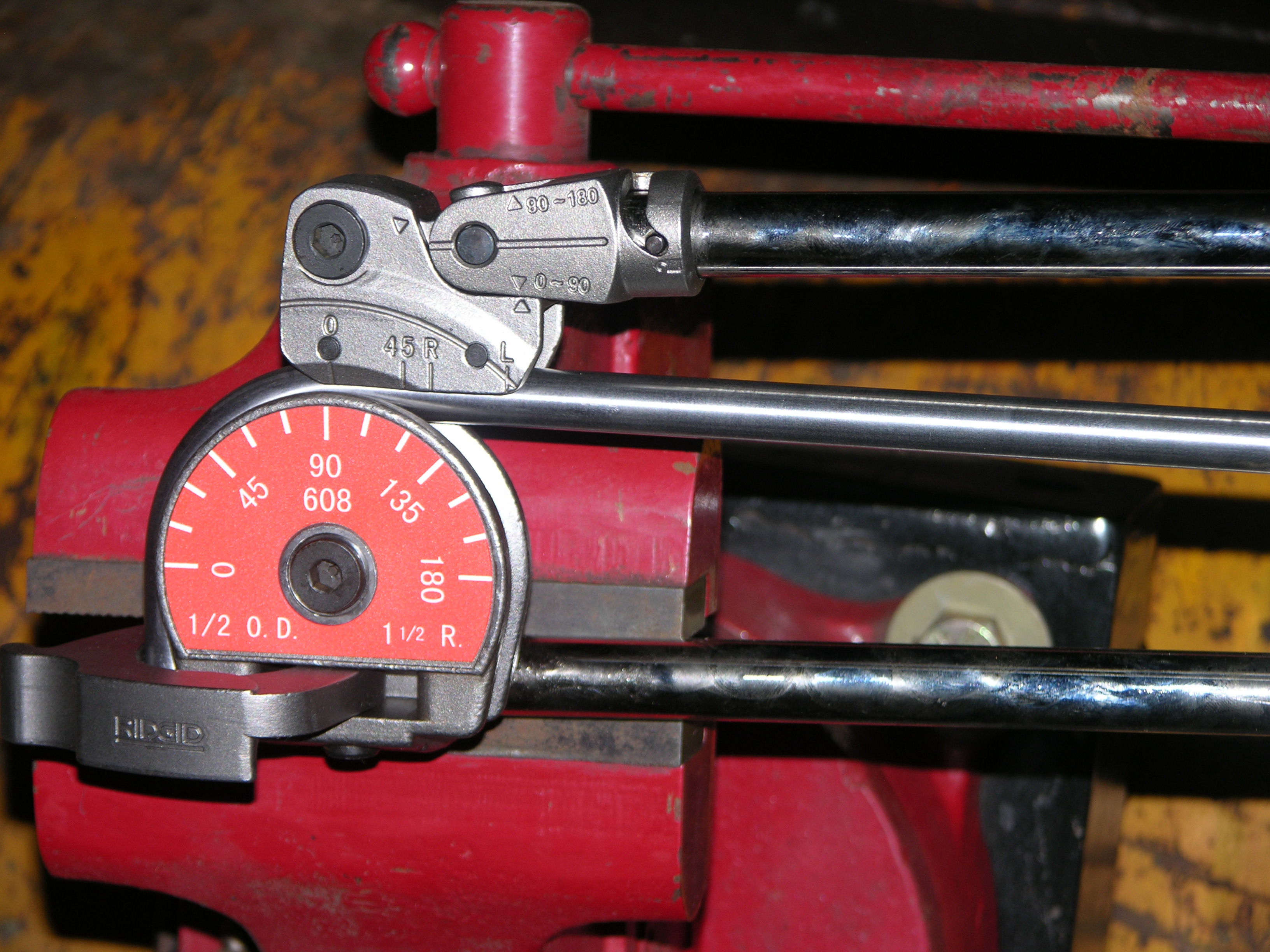

The new tube @ 90 degrees - different materials and thicknesses take a different amount of "over-bending" to get them to stay @ the angle you want; this one is 1/2" .050" wall IIRC, and it needed just over 3 degrees "over" to end up @ 90 - DSCN3275.JPG DSCN3276.JPG - For 1/2" steel and stainless tube, a roller type bender is MUCH easier and does a nicer job - this is the one I use
RIDGID 3848 Model 68 Heavy-Duty Pipe Bender, 1/2-inch Tubing Bender - Hand Tool Sets - Amazon.com
I might not have spent that much, but I have a LOT of projects coming up that will use 1/2" tube and some that want 3/4"...

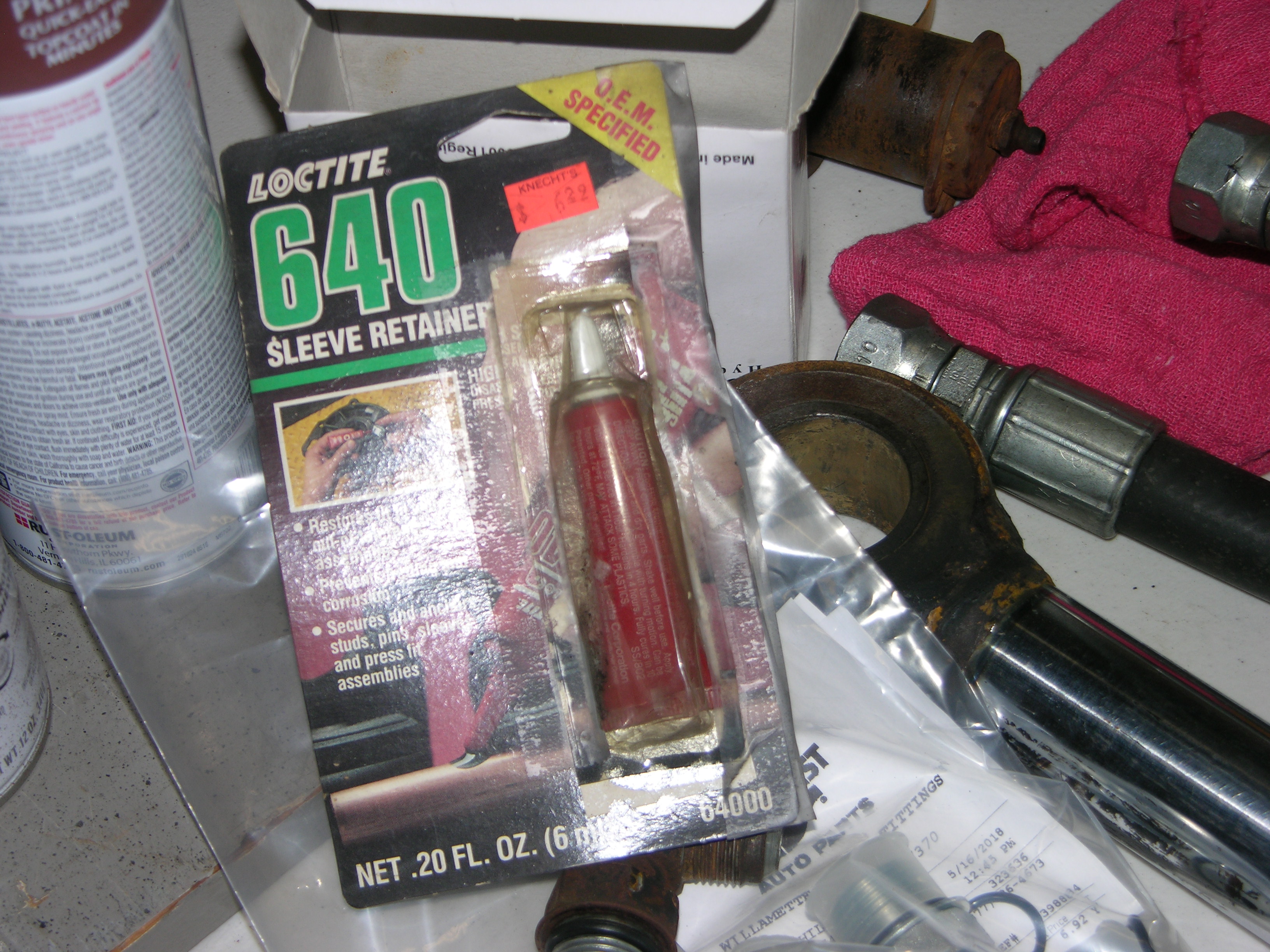

Here's the stuff I'll use to keep the outer dust seal in place (just a precaution since I took a teeny bit out of the pocket when doing the cleanup on the gland) - DSCN3277.JPG

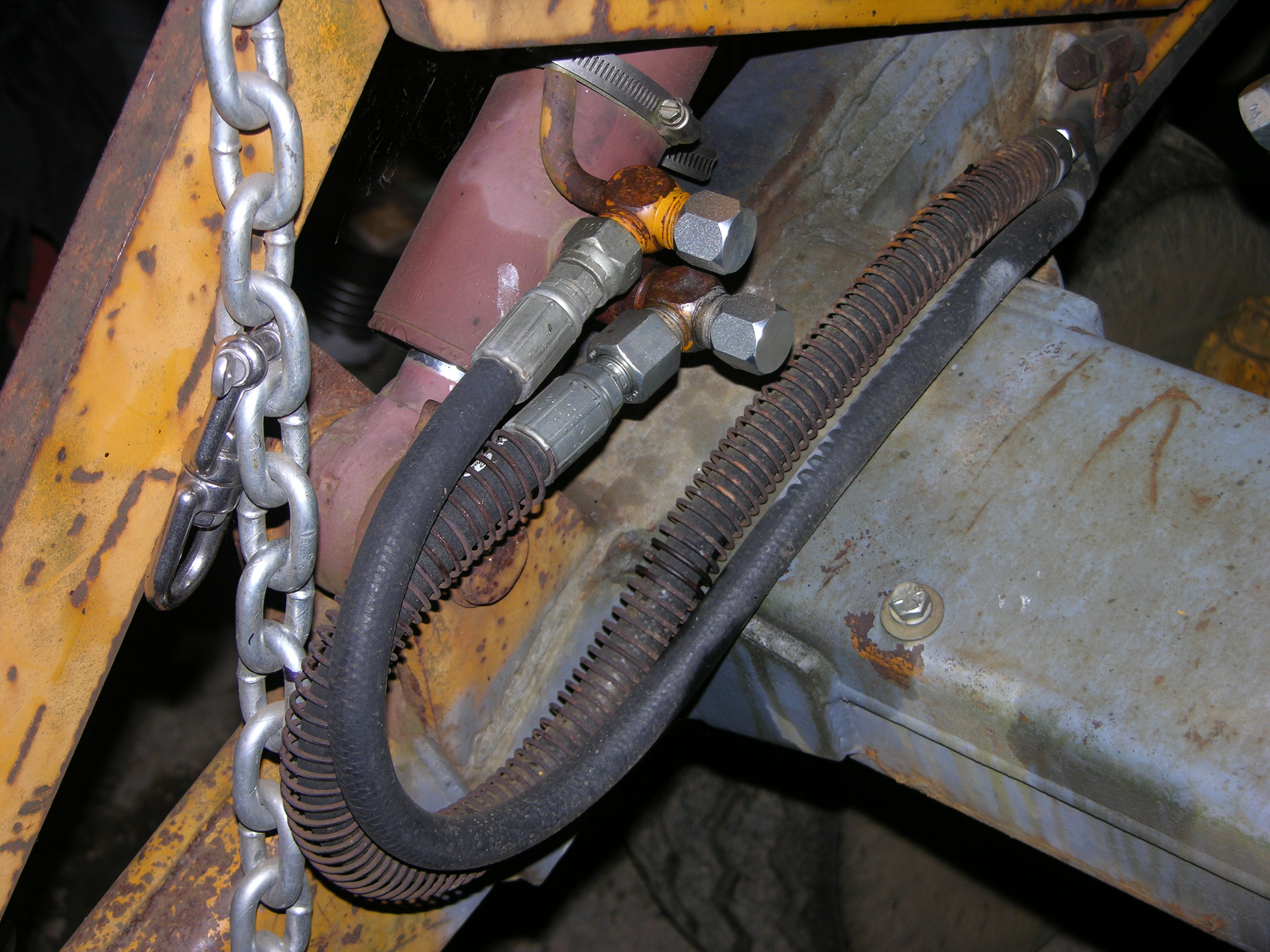

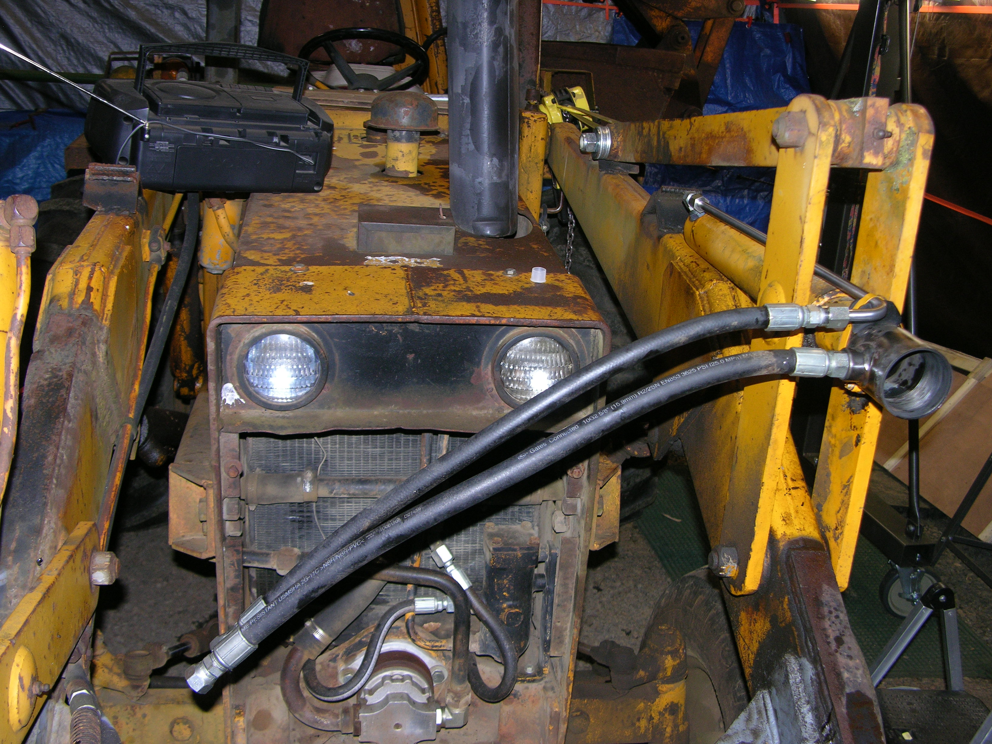

Got the crossover hoses (between the 2 curl cylinders) hooked up on one end - DSCN3278.JPG -
And this (the two JIC caps come off) is where they go, AFTER all the guts are back in the cylinder and the mechanical linkage is hooked back up - DSCN3279.JPG

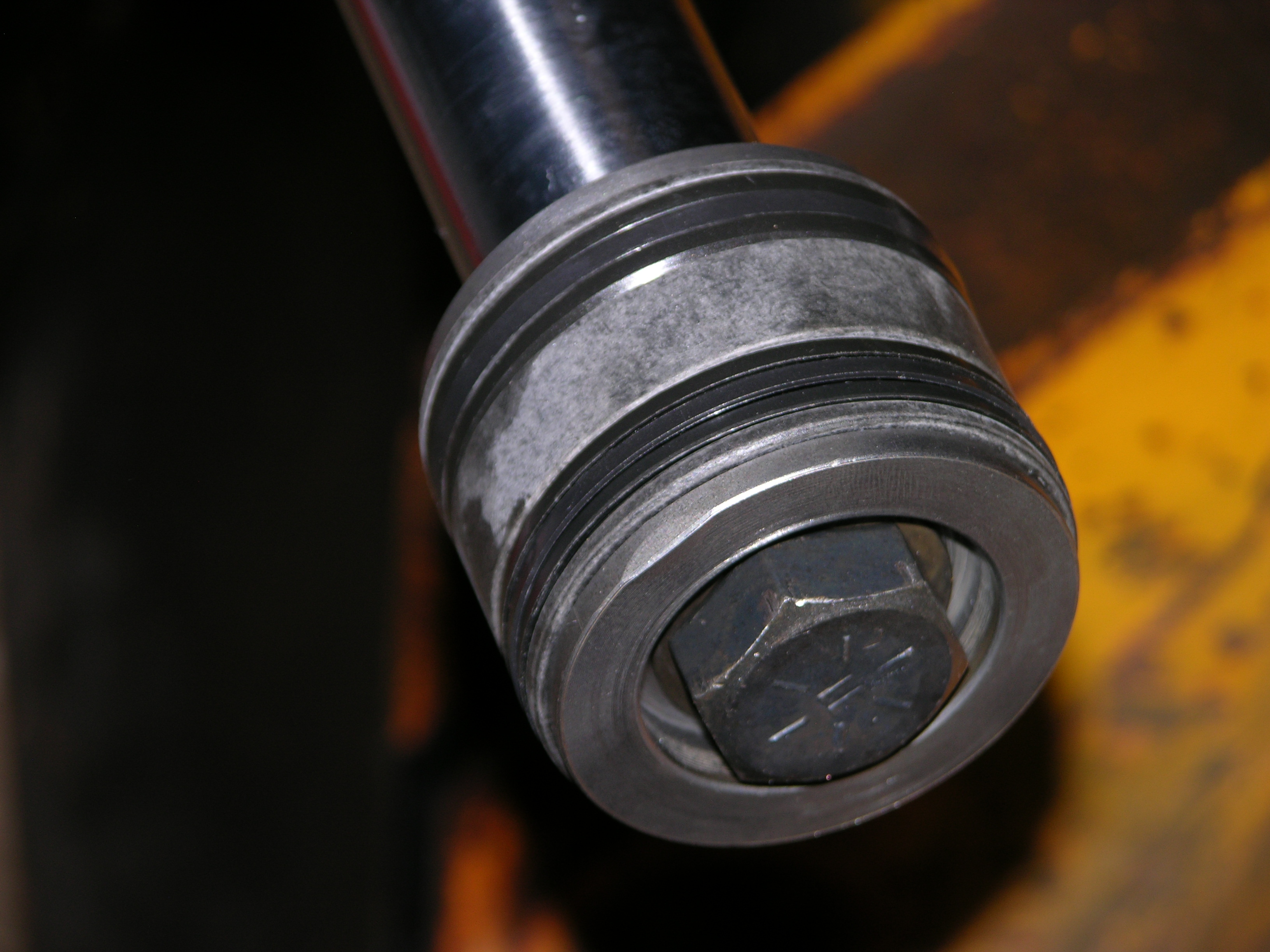

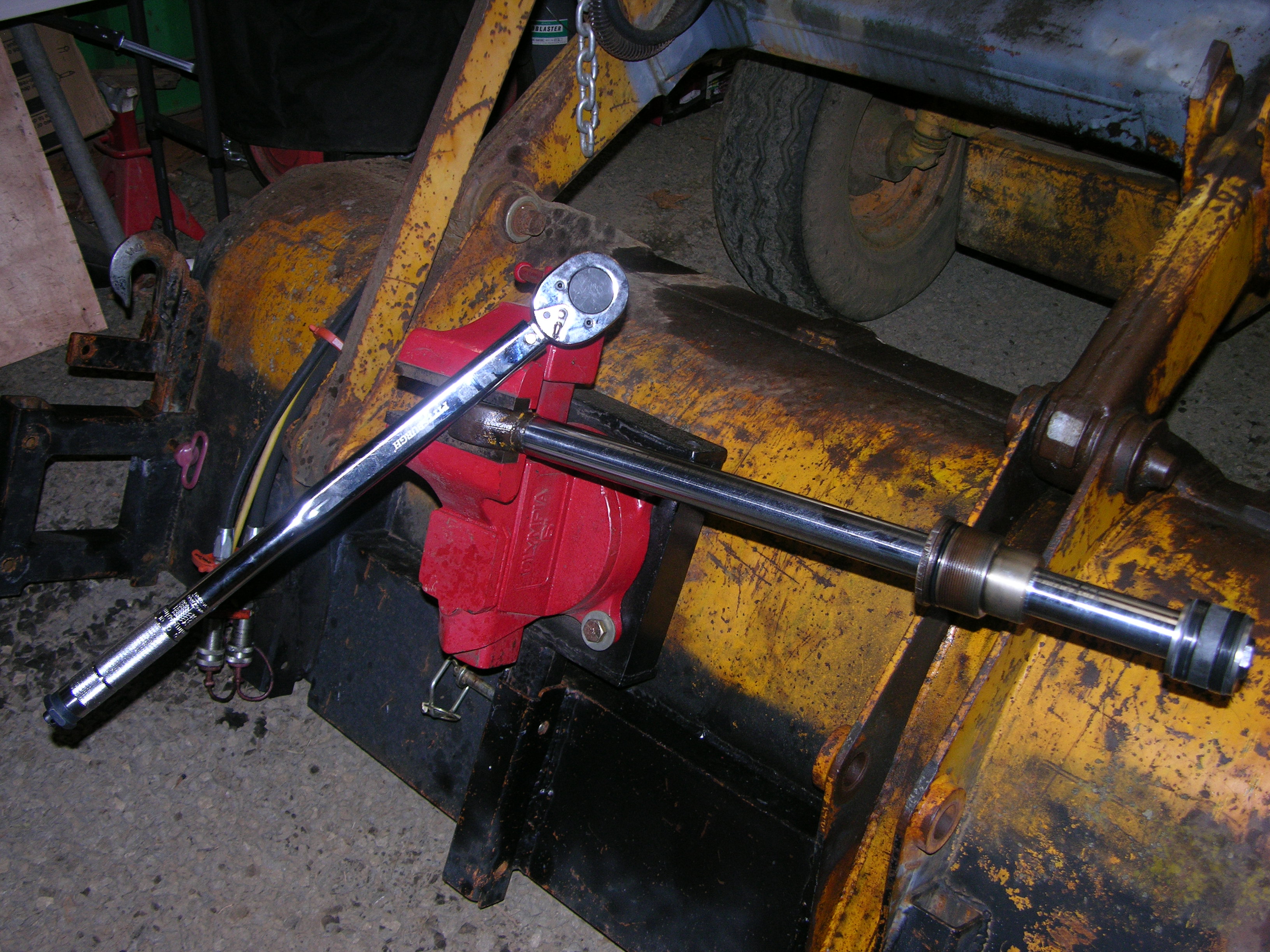

Well, as usual the older I get the faster I USED to be :rolleyes: - did get a bit done tho, here's the rod with all new seals, piston torqued to 210 ft lbs - DSCN3280.JPG

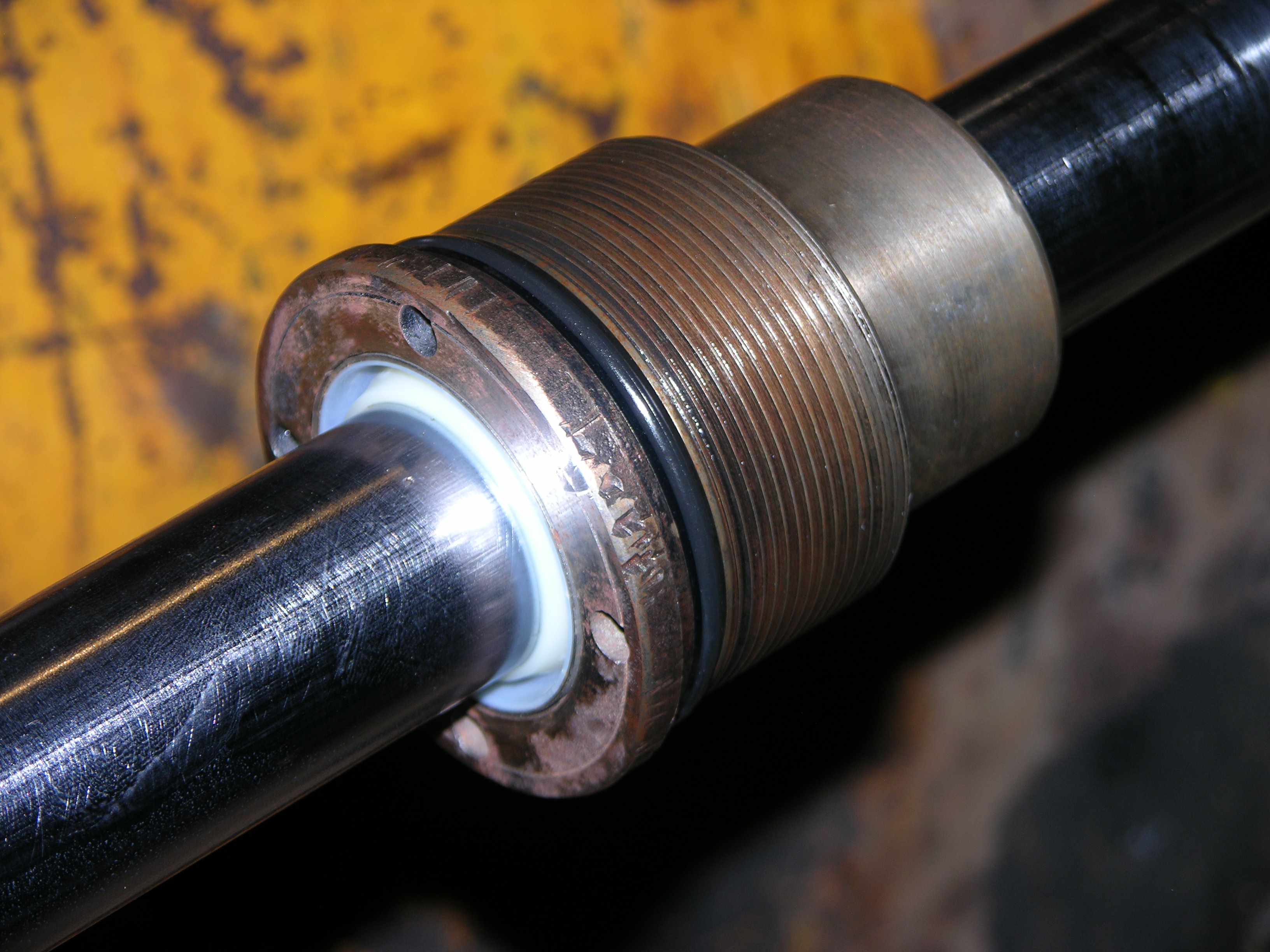

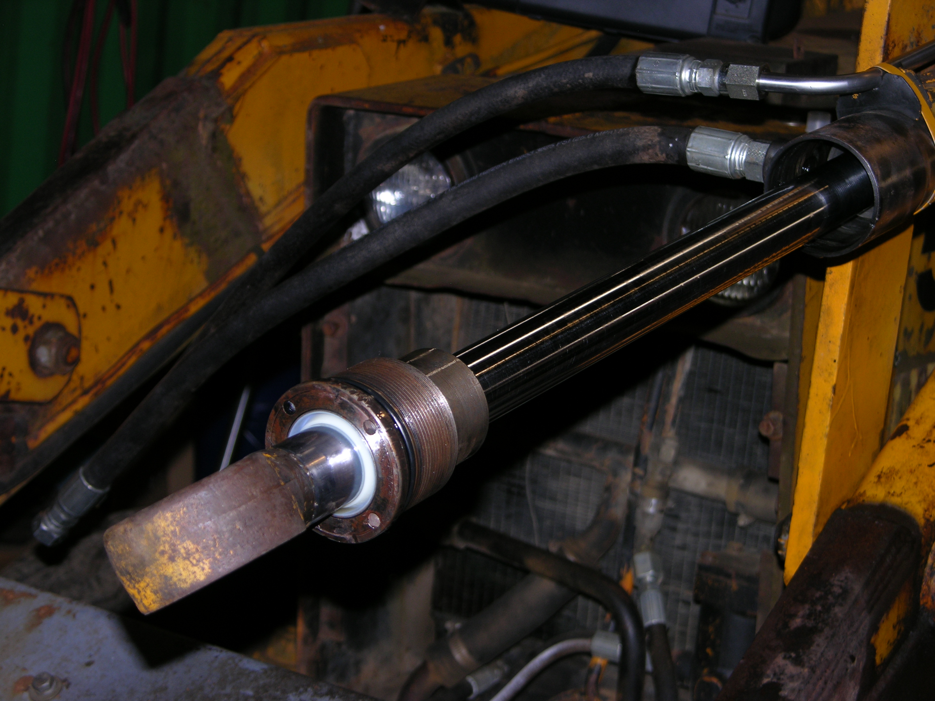

Gland nut, new outer wiper and front O rings showing - DSCN3281.JPG - BTW, that seal installation tool kit changed that operation from at least a half hour, down to about 30 SECONDS...
Rod went back into the cylinder barrel only as far as the belled out section, then got stubborn - DSCN3283.JPG -

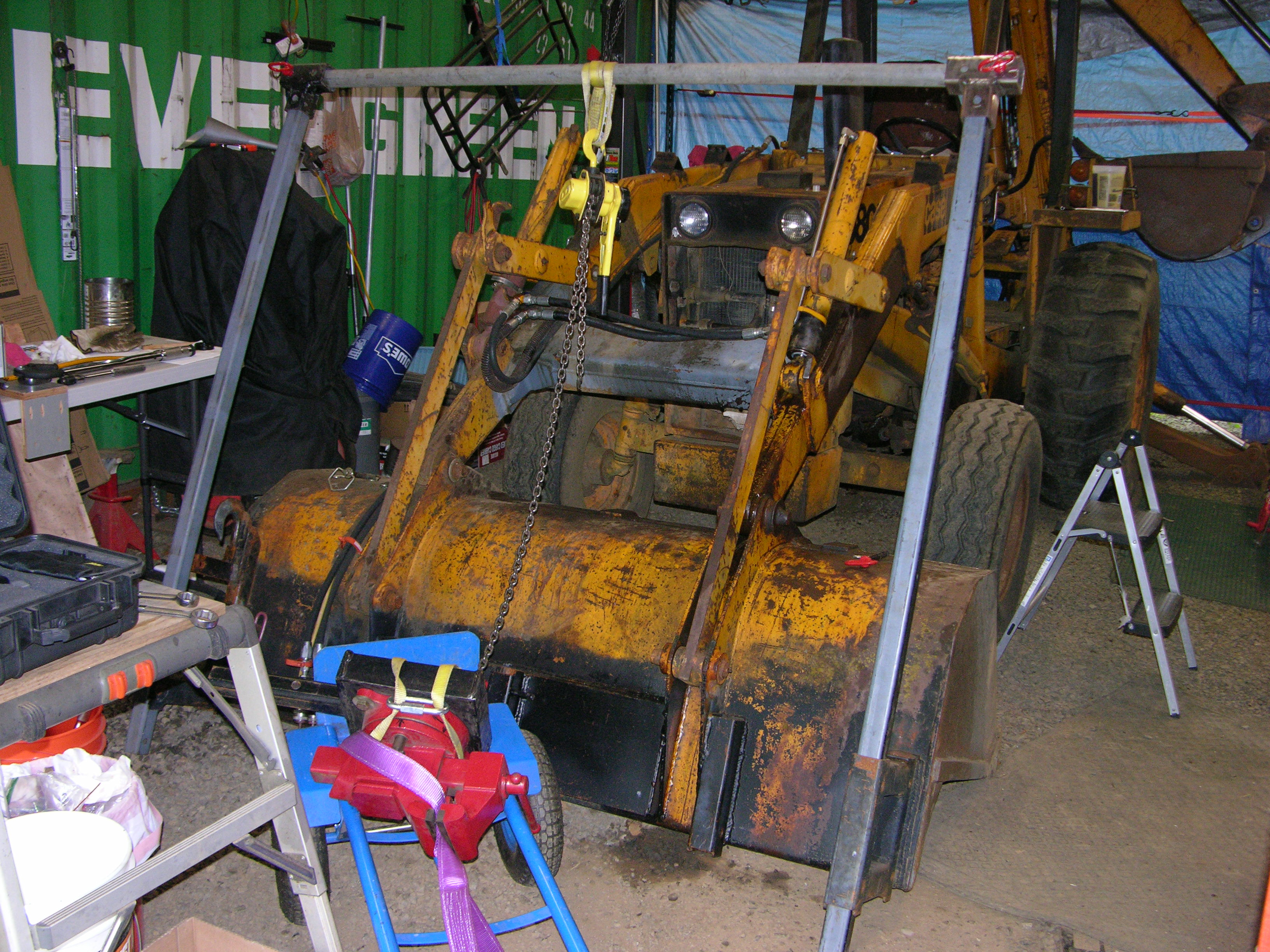

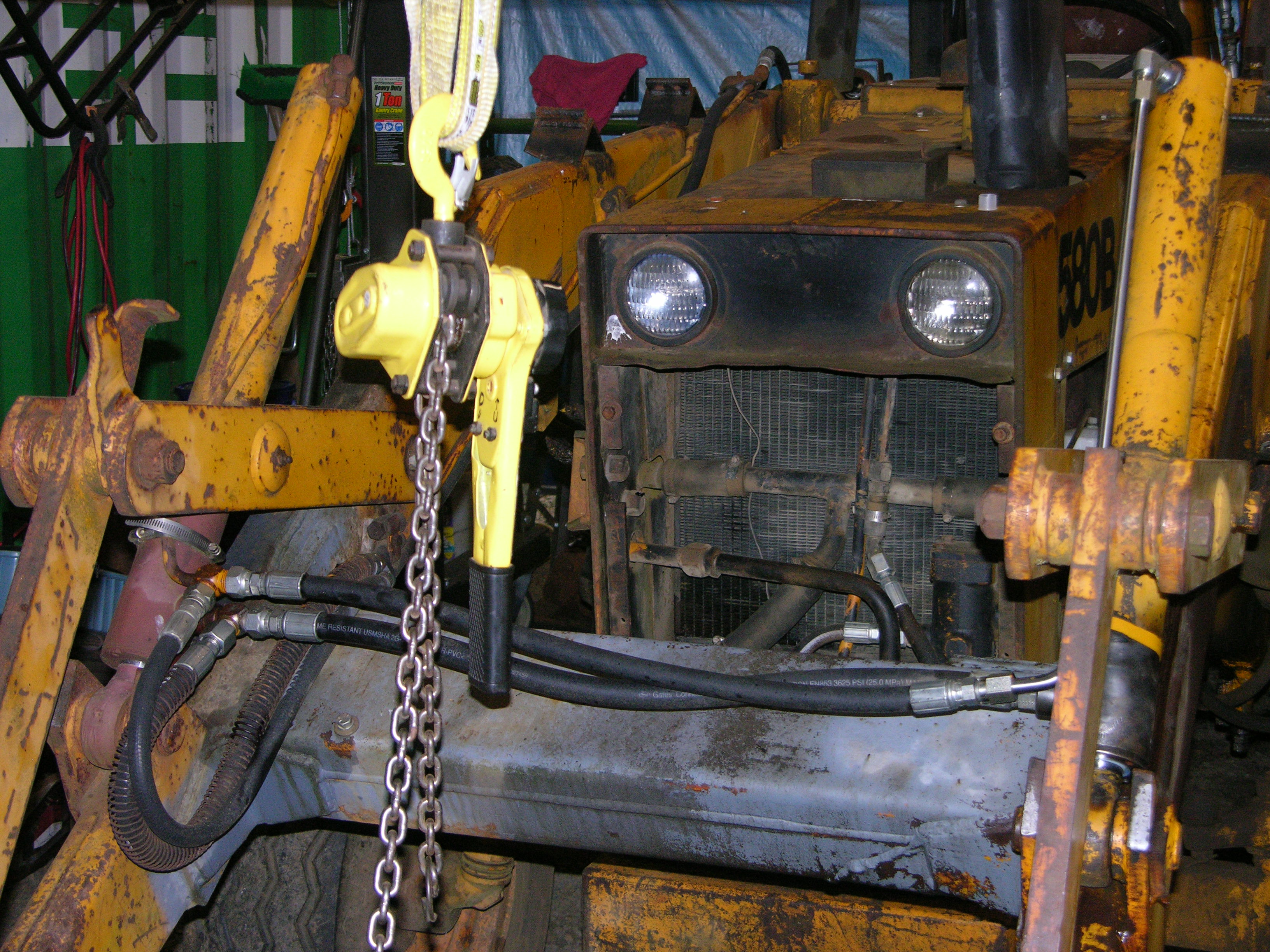

So I got MORE stubborn, managed to tilt the cylinder bellcrank back far enough to get the pin end of the rod pinned into its location, then the comealong to force the bellcrank FORWARD, forcing the piston further into the barrel.
Tomorrow I'll remove the comealong and that long linkage bar; that'll give me room to slide the gland up to the cylinder barrel and get it screwed in and torqued - after that I can use the hydraulics to even things up and reconnect all the linkages without dumping fluid on the floor... Steve

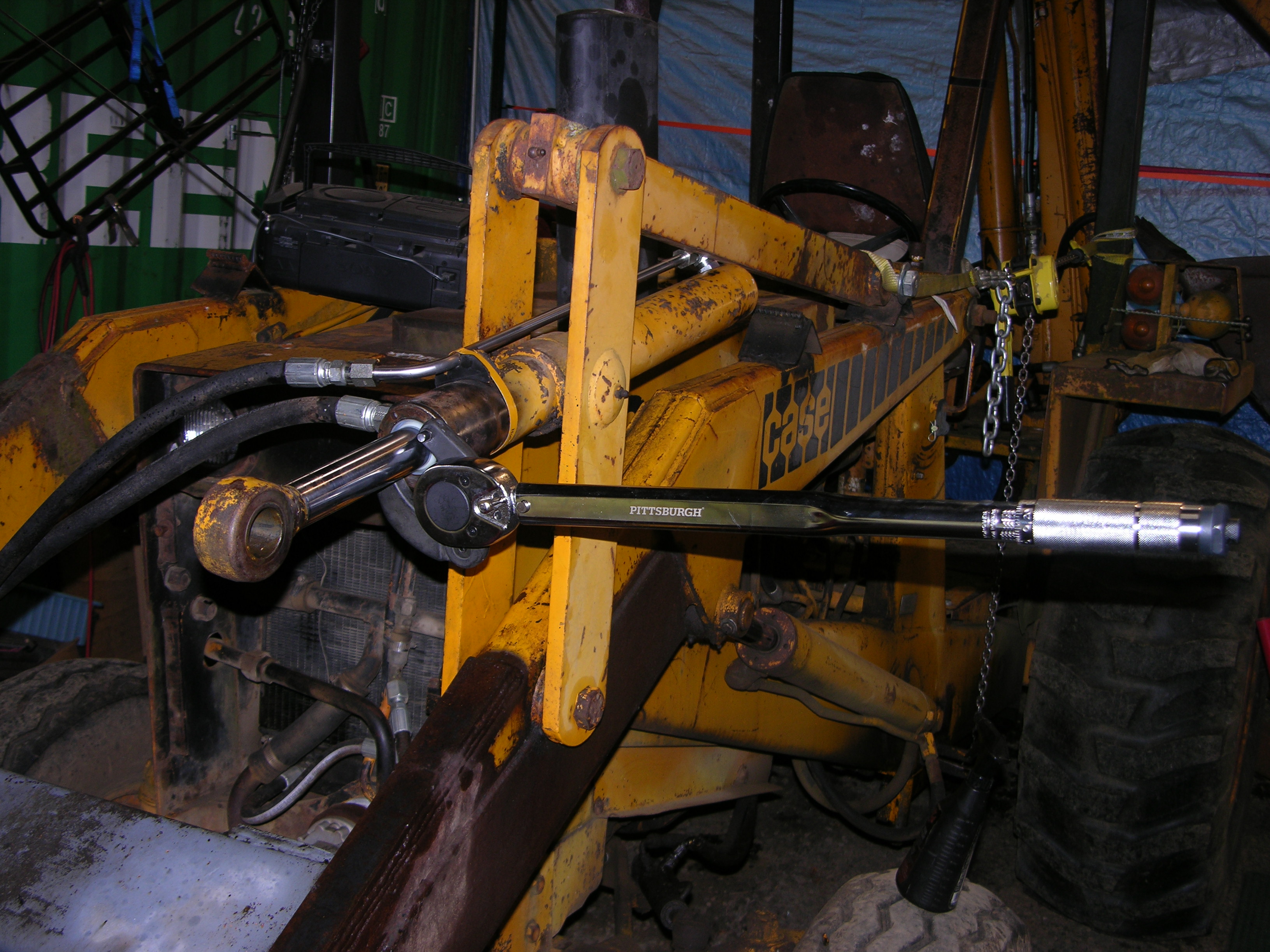

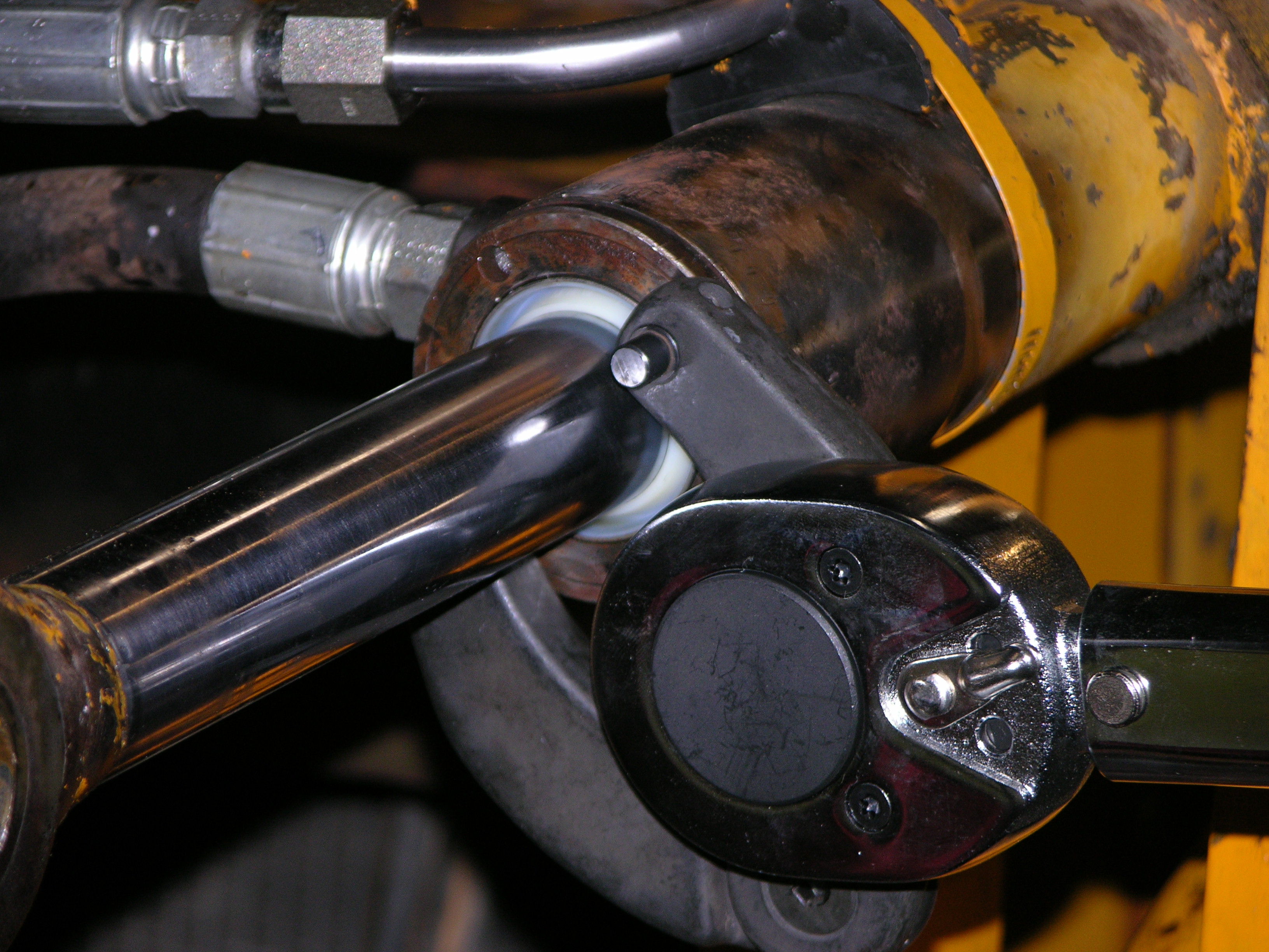

Today went well; here's the gland nut, tightened and torqued to 150 ft lbs - DSCN3285.JPG
Good thing the head of my 3/4" torque wrench isn't any wider :rolleyes: - DSCN3286.JPG

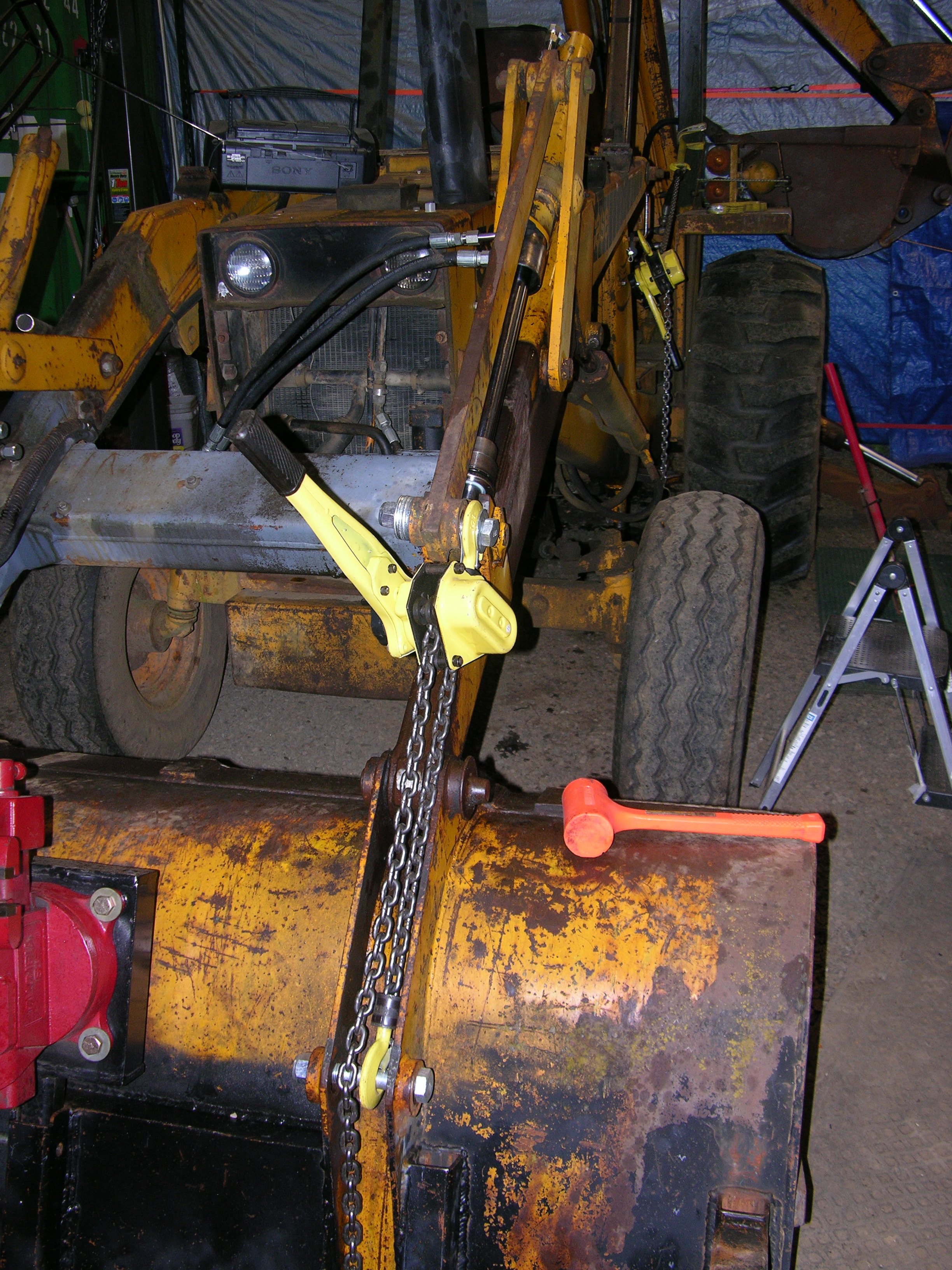

Took two comealongs and some straps to pull the linkage down far enough to retract the cylinder and get both pins replaced - DSCN3288.JPG
