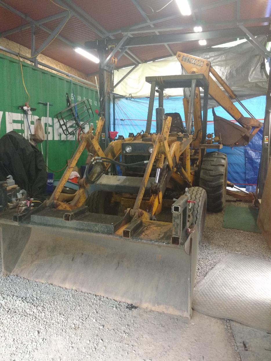

Awright, if'n yer gonna WHINE about it...

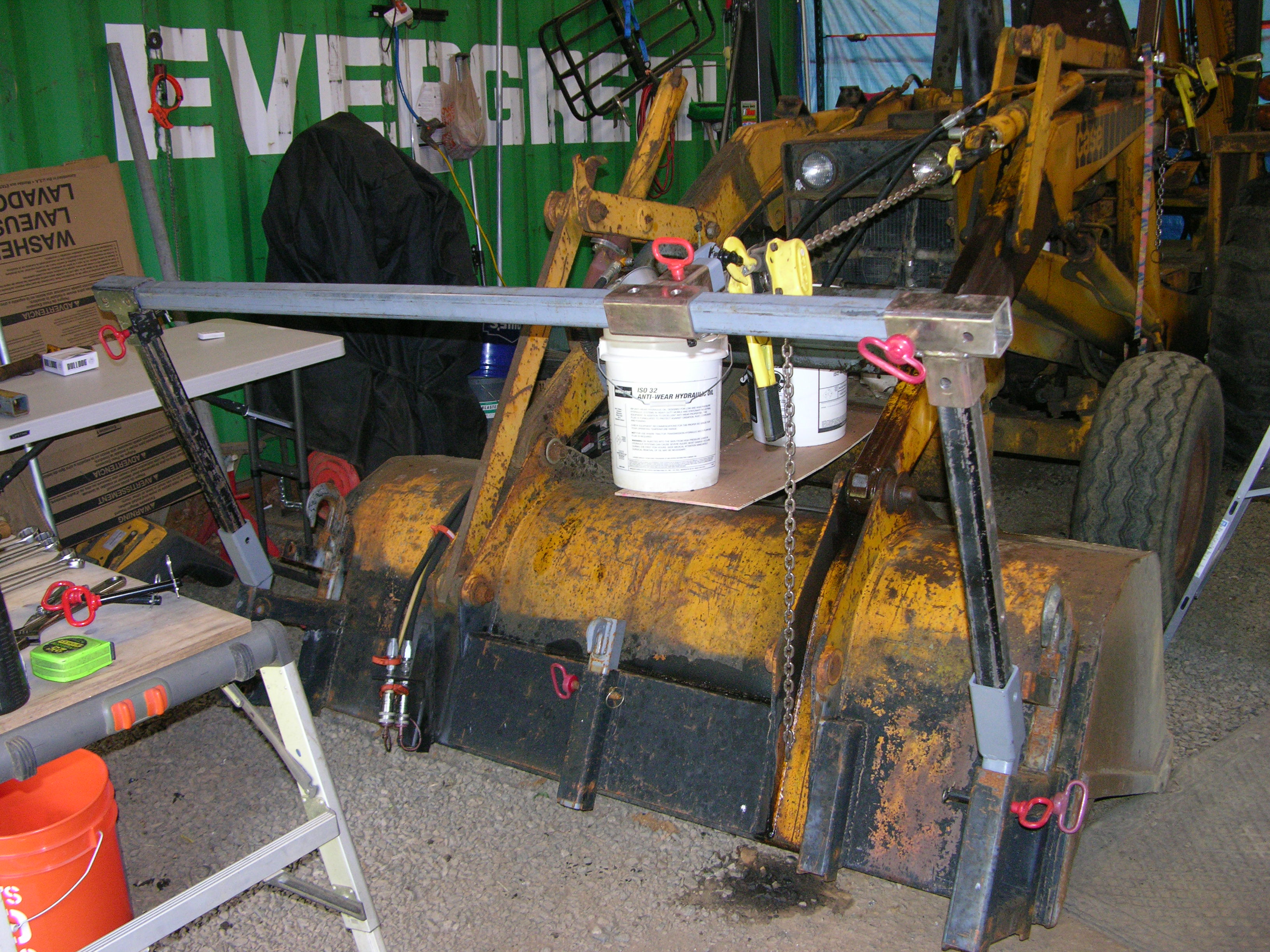

'bout all I got for now, rearranged enough stuff to get the 580 in to the "Lowes Bucket Store-room and Crane Bay", nuthin' much else is gonna happen til I get at least the "drivers side" Curl cylinder to quit thinkin' it's a race horse with a bladder problem :rolleyes: -
Hard to tell, but there's about 1-1/2 foot clearance at the hoe end, about 3' at the FEL end and maybe 4" headroom (if I don't try to move the crane toward the hoe end, that is)
That curl cylinder's the only VITAL one for now, but ALL but 5 of the other 13 cylinders need kits ( got 'em in stock) - I did the hoe swings and stabilizers a few years ago, along with ONE of the FEL curl cylinders. That was followed by extensive shoulder surgery and muscle re-attachment, then a year on 70% followed by retirement...
There's 13 cylinders total on that machine, so only 8 more to go :confused:
If I don't fix that other Curl cylinder, it'll dump bags of Sakrete on my toes instead of holding 'em at chest height so my life's only a "comotose" (rhymes with swell) instead of a LIVING one 😆 ...Steve

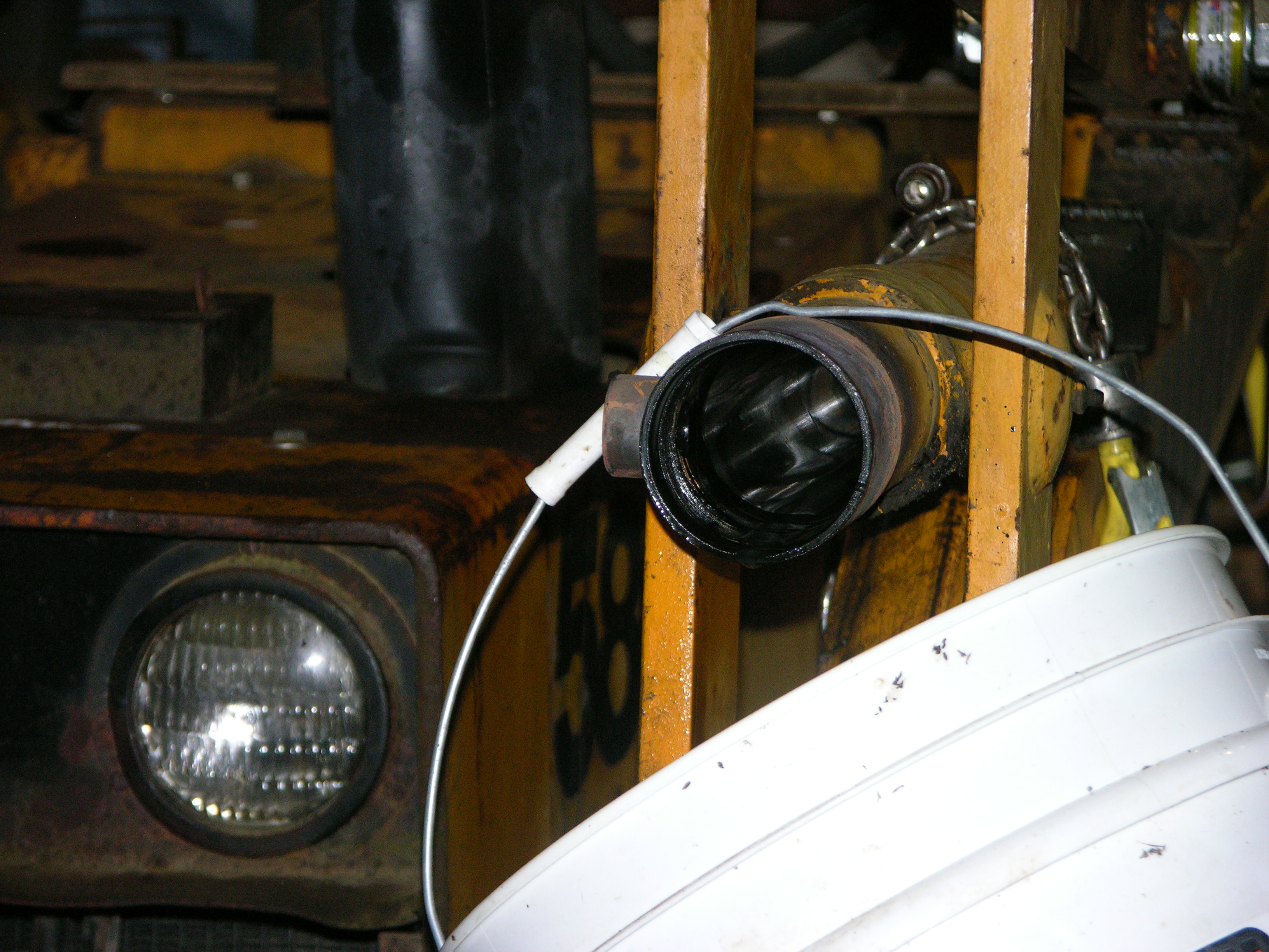

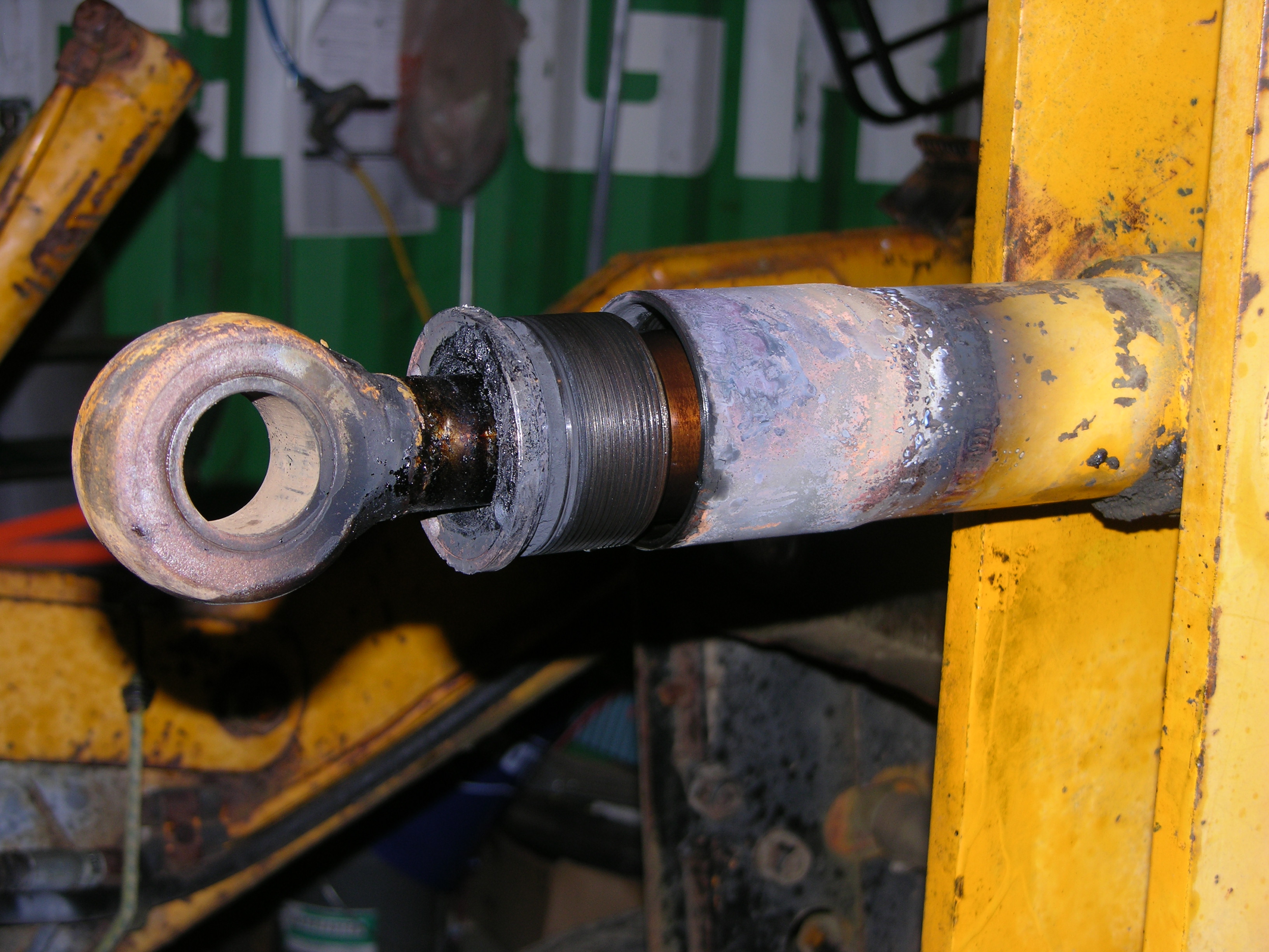

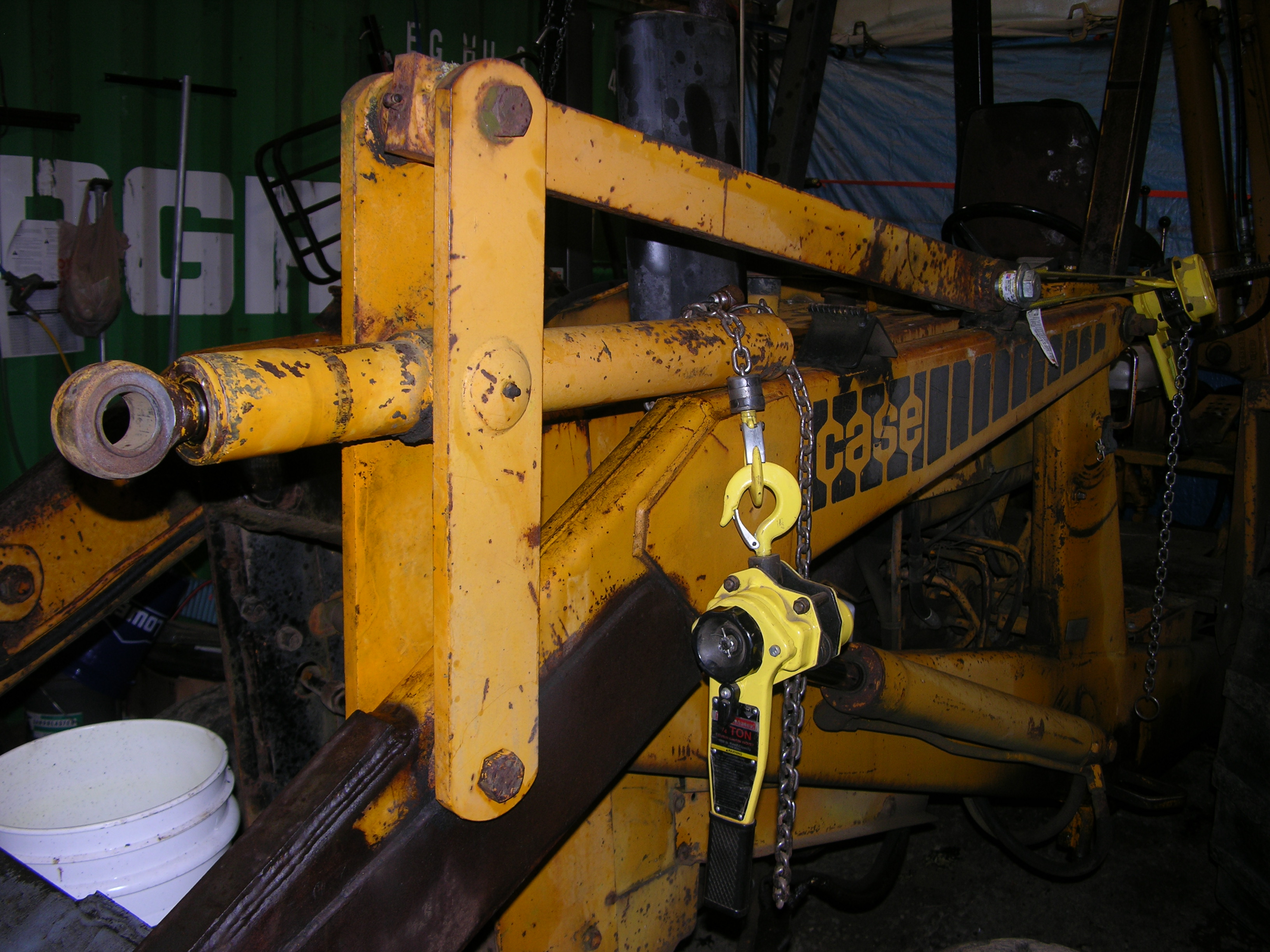

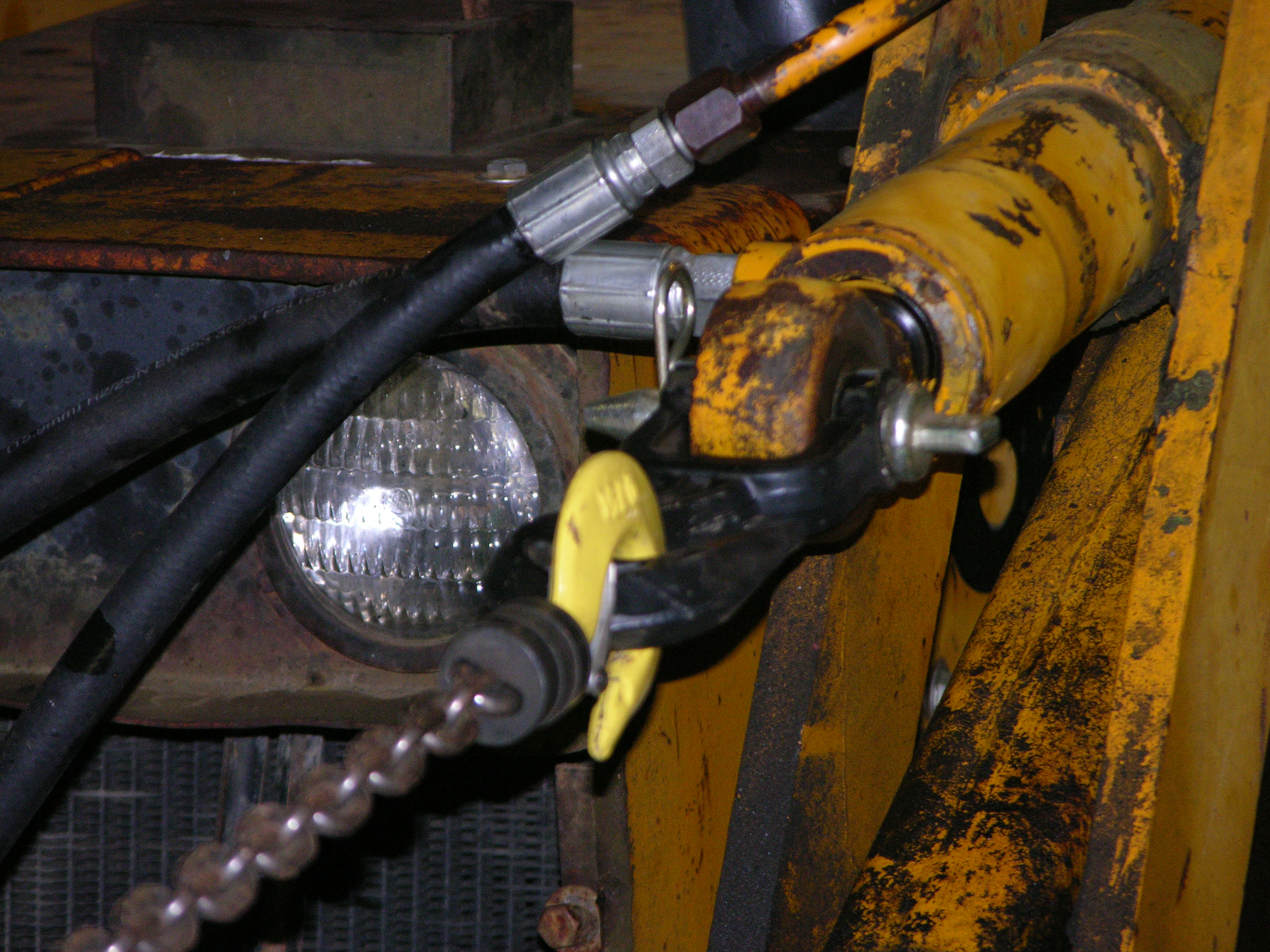

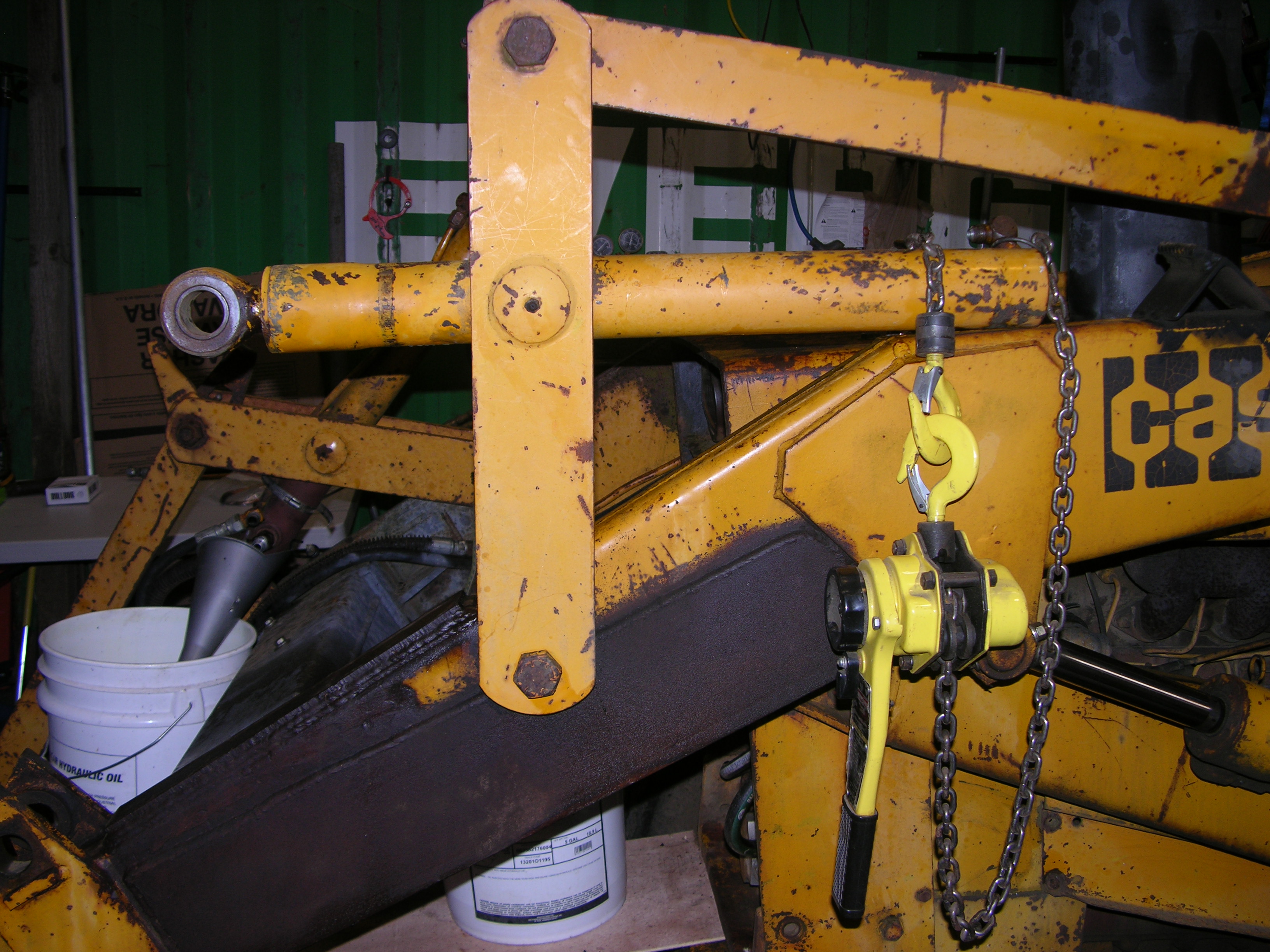

So today, since I'd run out of excuses I started on the "leakin' Lena curl cylinder" - at one point in time I had 3 chain comealongs in use, more of the "tinker toys", tried to get the gland nut to loosen up cold using the "official spanner wrench", obviously designed by the same idiot who thought dinky little holes in the end of the gland were gonna work after 40 years of not comin' apart - didn't work THIS time EITHER -
Then out comes the air hammer and a 1" round hammer bit, went all around the face of the gland and all around the barrel of the cylinder where the (about 2" long) threads are on the gland - spanner tool back on the gland, 18" 3/4 drive breaker bar and 3 foot cheater, ain't gonna move (and yes, I DID remove the little screw that locks things in place) -

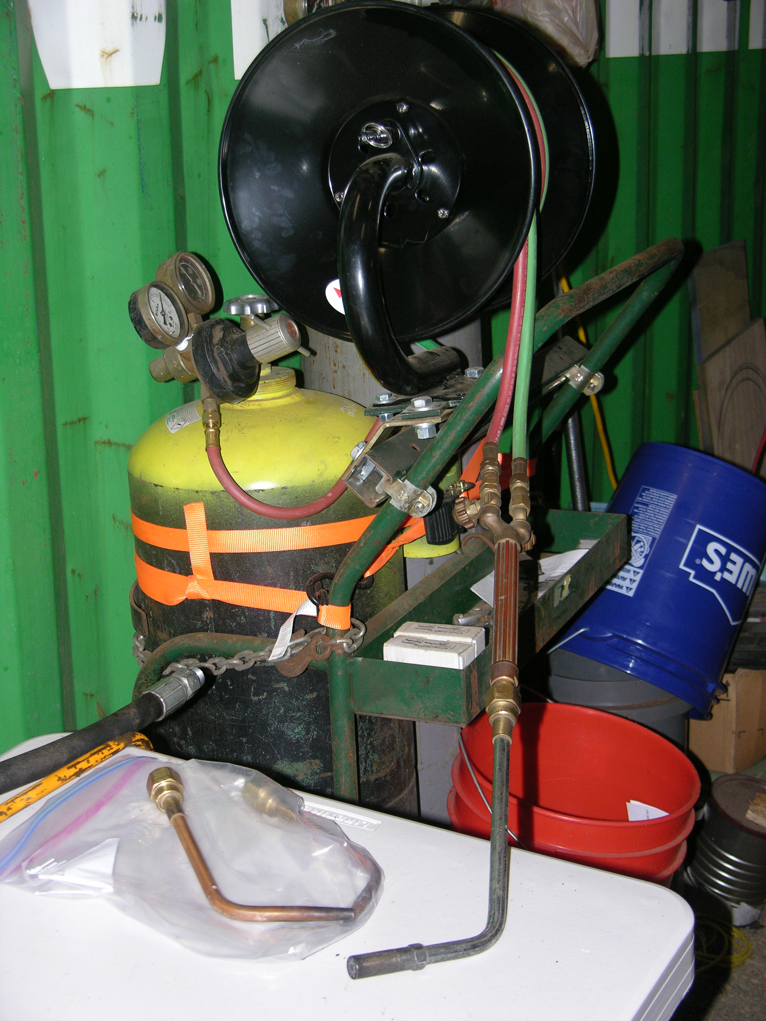

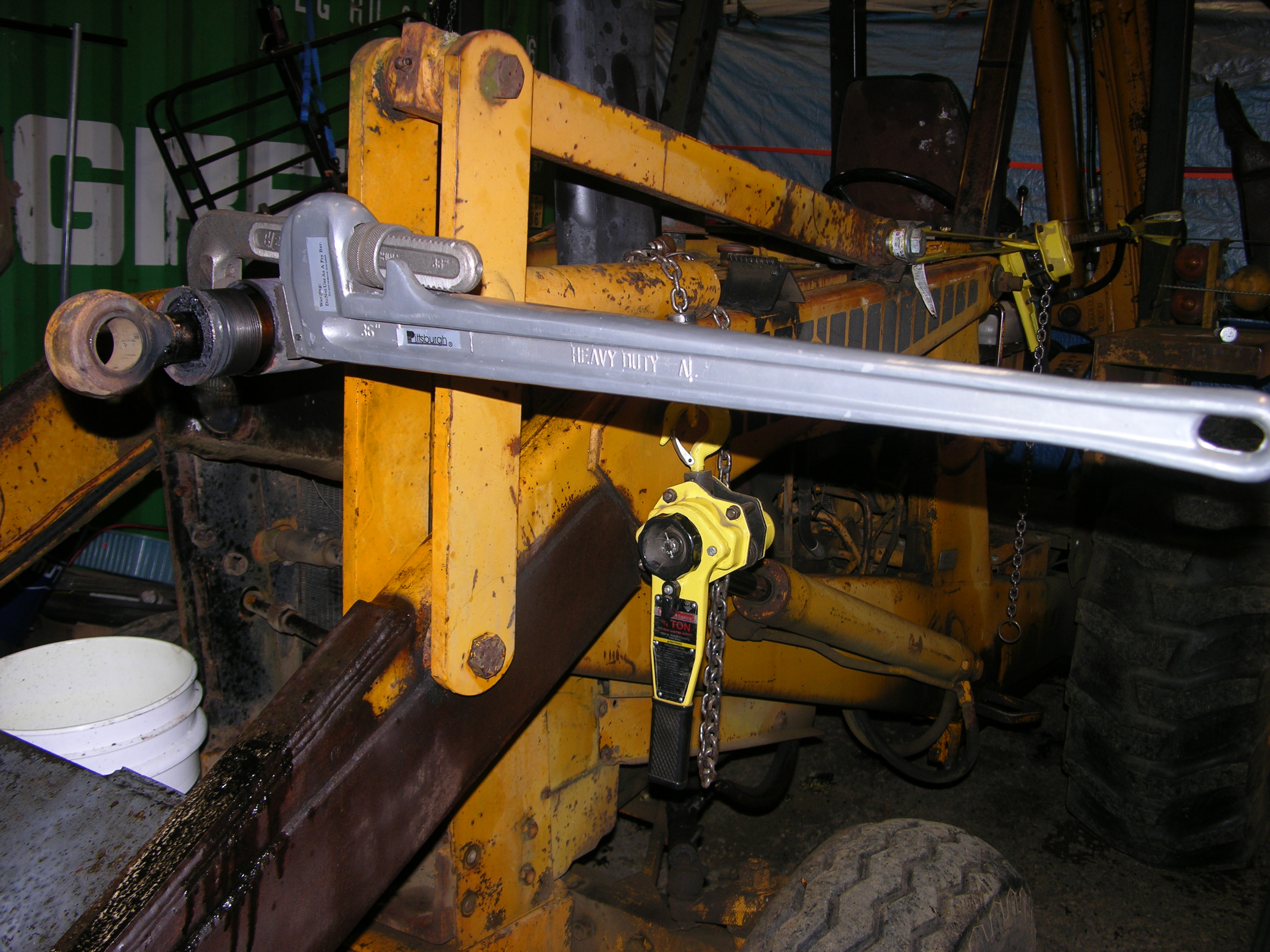

Moved on to the tried and true "hot wrench and pipe wrench" combo - the OTHER side I did several years ago LEFT HANDED, just used a #7 tip on the torch and the 3' pipe wrench, STILL took a while to get it started -
So THIS time I stuck a rosebud on the torch, Ac @ 12 psi and O2 @ 25, neutral flame and tried to heat up JUST THE CYLINDER BARREL WHERE THE THREADS ARE INSIDE - got it pretty warm, dull to medium cherry in places, caught the old seals on fire, IR temp gun showed just under 900F when I checked - heavy weld gloves, slipped the pipe wrench on the (about 1/4" thick) gland face expecting to hafta lean into it pretty good (even with TWO arms this time :rolleyes:) - sucker just unscrewed almost by HAND - in fact, I cooled things off more with air ('bout 400F), grabbed the gland with one hand and unscrewed it the last 1-1/2" THAT way :eek:
No complaints, just surprised - guess I know how the OTHER 8 are gonna get done...
Anyway, here's the skinny -
More of the tinker toys in action, only way I could get a straight line pull to get the rod out - first time was just to dump the extra oil out of the cylinder, the hoses still attached and dumped into those (not blue) buckets -

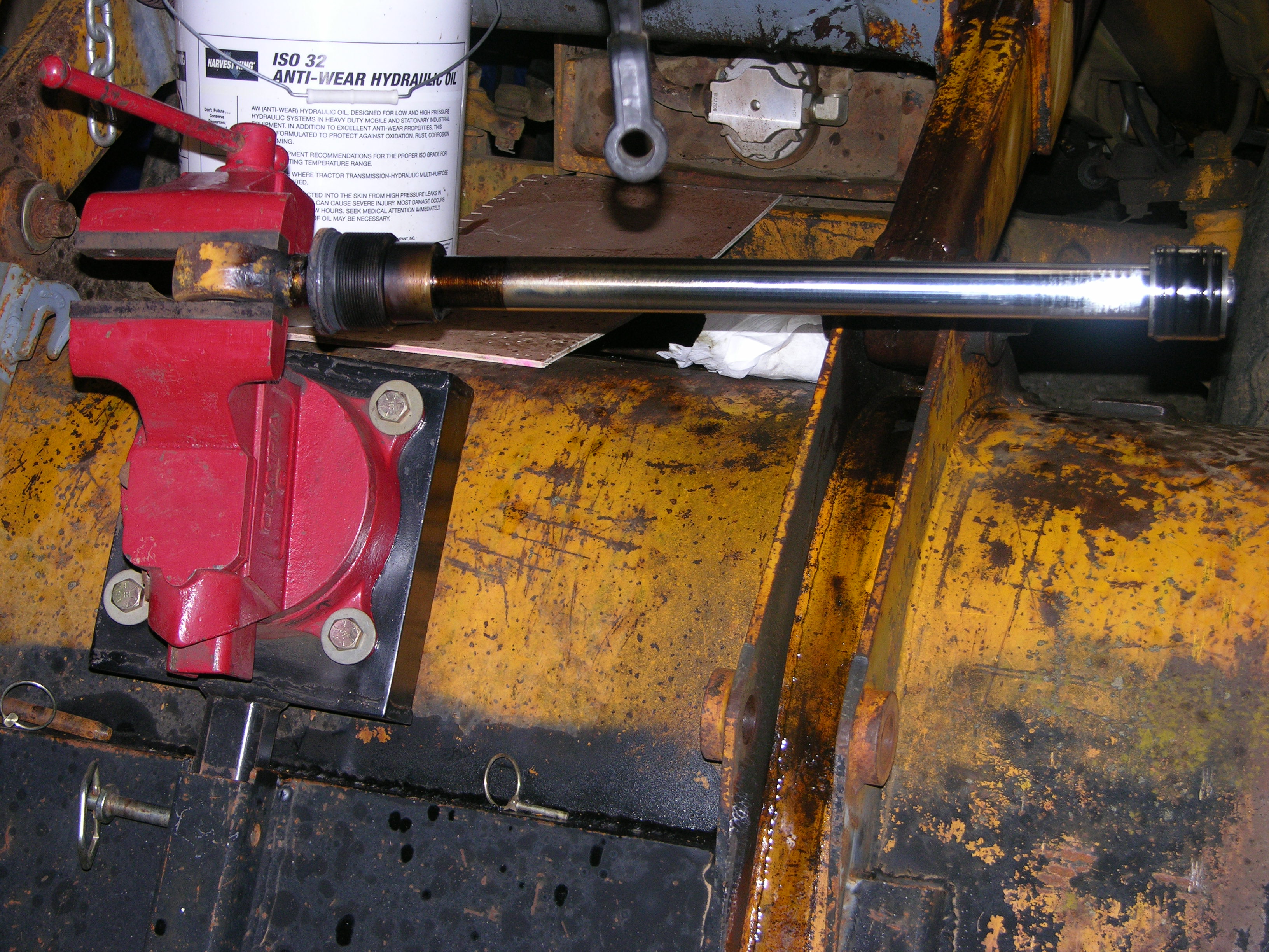

Rod out and back in, 2 comealongs locking everything together at a good angle for heating - any time I need to heat a gland nut I ALWAYS run the rod all the way IN first, that way the piston seals don't melt and make a bigger mess further inside the tube...
Might not've needed quite that much :laughing: -
Handle coulda been about half that long (THIS time), but the shorter ones aren't DEEP enough (and NO, that's NOT quite where it wuz used, just a photo op -
Might need a little clean-up; no biggie, CRC carb cleaner cuts the melted seal stuff pretty good -
Rod/gland/piston, clamped in one of the heavier (97#) tinker toys, ready to disassemble (typically 450-500 lbs torque on the piston nut), clean up, new kit installed - the vise is good for it (used it before for this), and the 1" impact should get it off no problem -
Probably only get things cleaned up manana, Mom's day stuff - also, I found a tool kit that "folds" those NOT fun internal gland seals into their grooves much easier, might just wait til it gets here to re-assemble... Steve

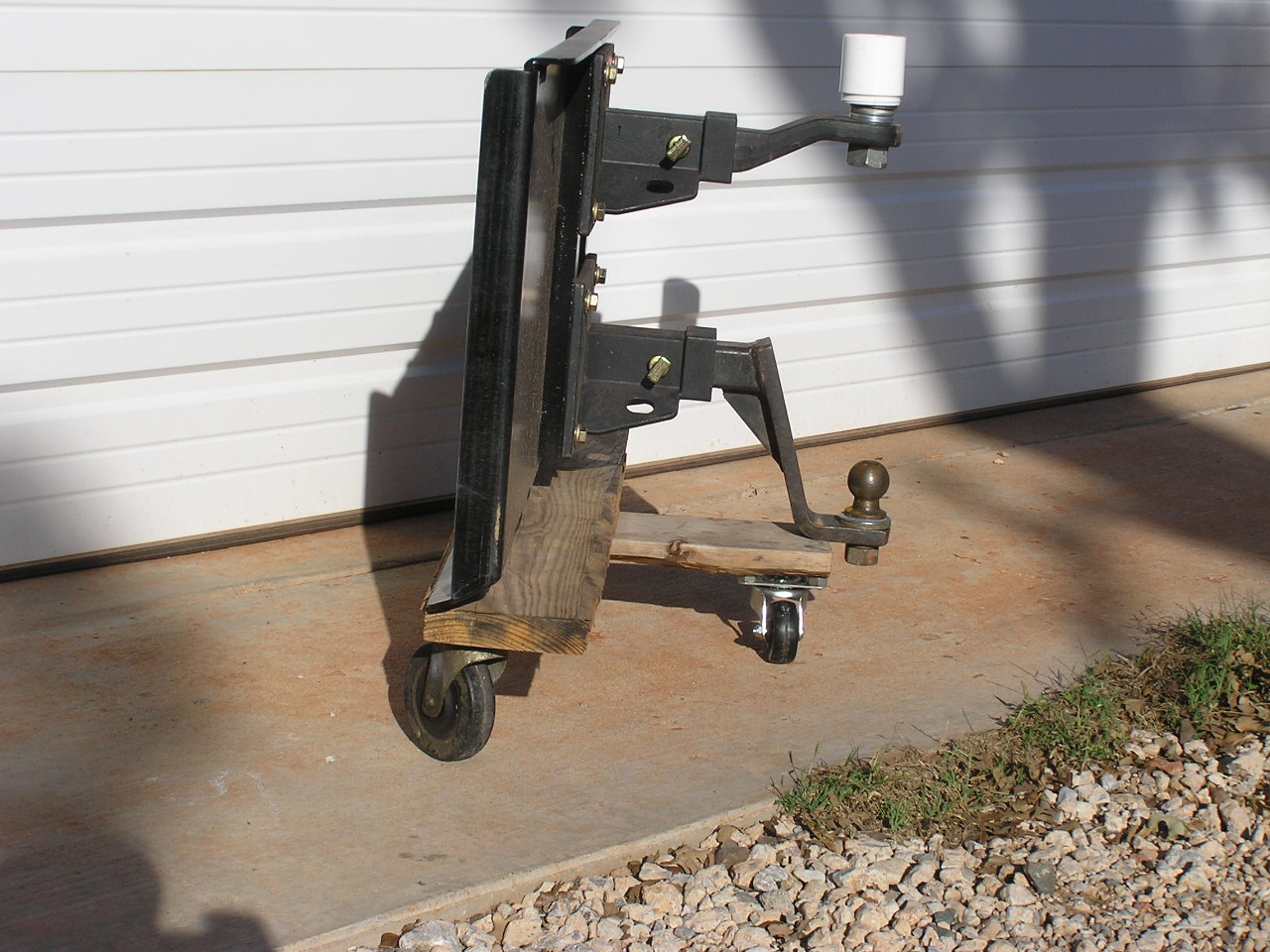

I sure like your tinker toy idea. :thumbsup:

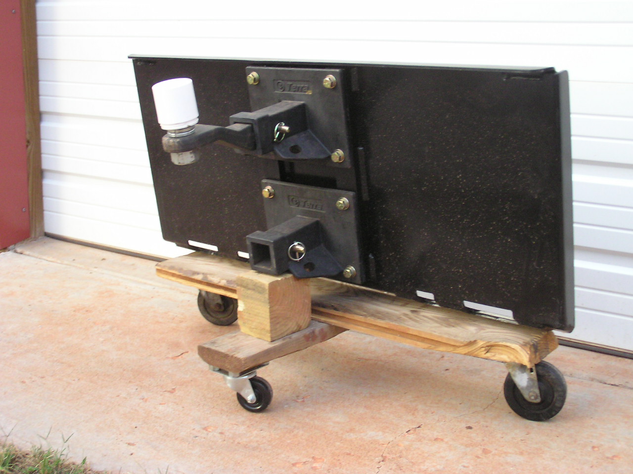

I could add vertical receiver tubes to the outside edges of my Eterra Dual Hitch Receiver:
It is heavy duty, extra strong:
3500 pounds hitch weight on the top hitch:

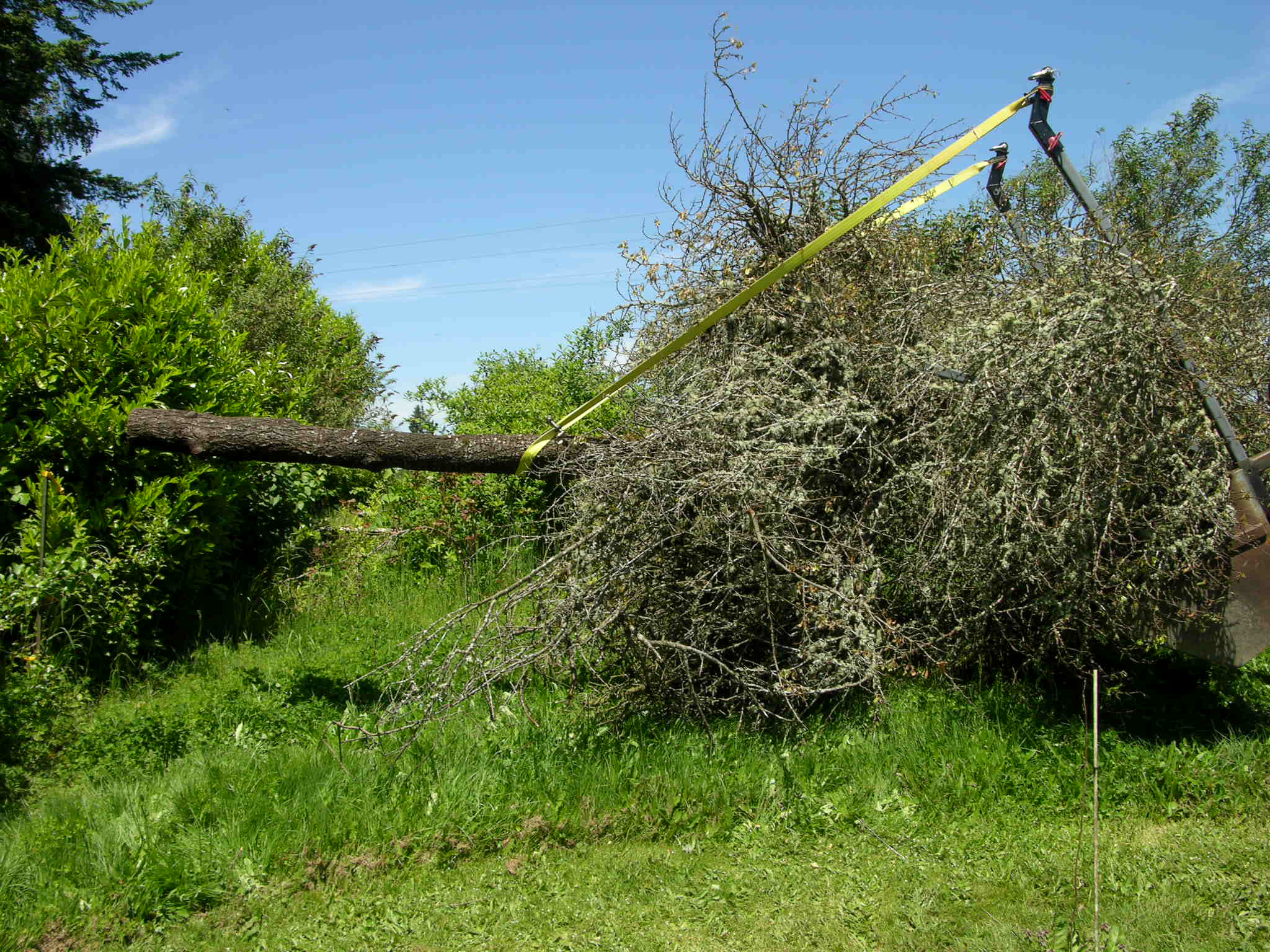

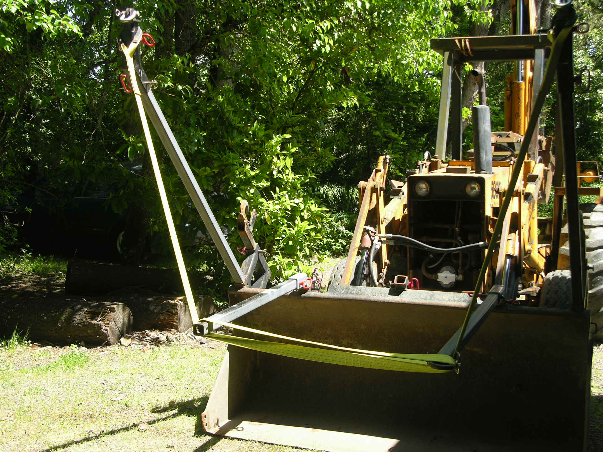

Last year after a heavy wind, I found a volunteer prune tree (near neighbor's fence) laid over into his yard - cleanup, even with my 6'x8'x2' brush bucket, woulda been a mess, so I used a pair of 45* adapters, 2 4' tubes (like a bale spear) and 2 6' tubes for spreaders, then picked up the whole tree (minus the root ball) and moved it over to my burn pile (so I wouldn't hafta move the mess TWICE :D ) then cut up the pieces I'd use for firewood.
Cleanup (HIS yard) consisted of picking up 3-4 twigs :thumbsup:
Your ssqa receiver and telehandler would be an even MORE versatile combo, I'd say GO for it... Steve

Yup I'd say you had enough heat, so you used that giant monkey wrench on the you call it Gland Nut, got it. The last picture is the rod with seals on the end, how do they come off, I'm assuming you're going to change everything? This whole cylinder rebuild looks strange with no blue buckets in sight, maybe your projects are bucket color coded, white buckets for tractor repair, that's something I'd do, I color code everything with type and markers..................
