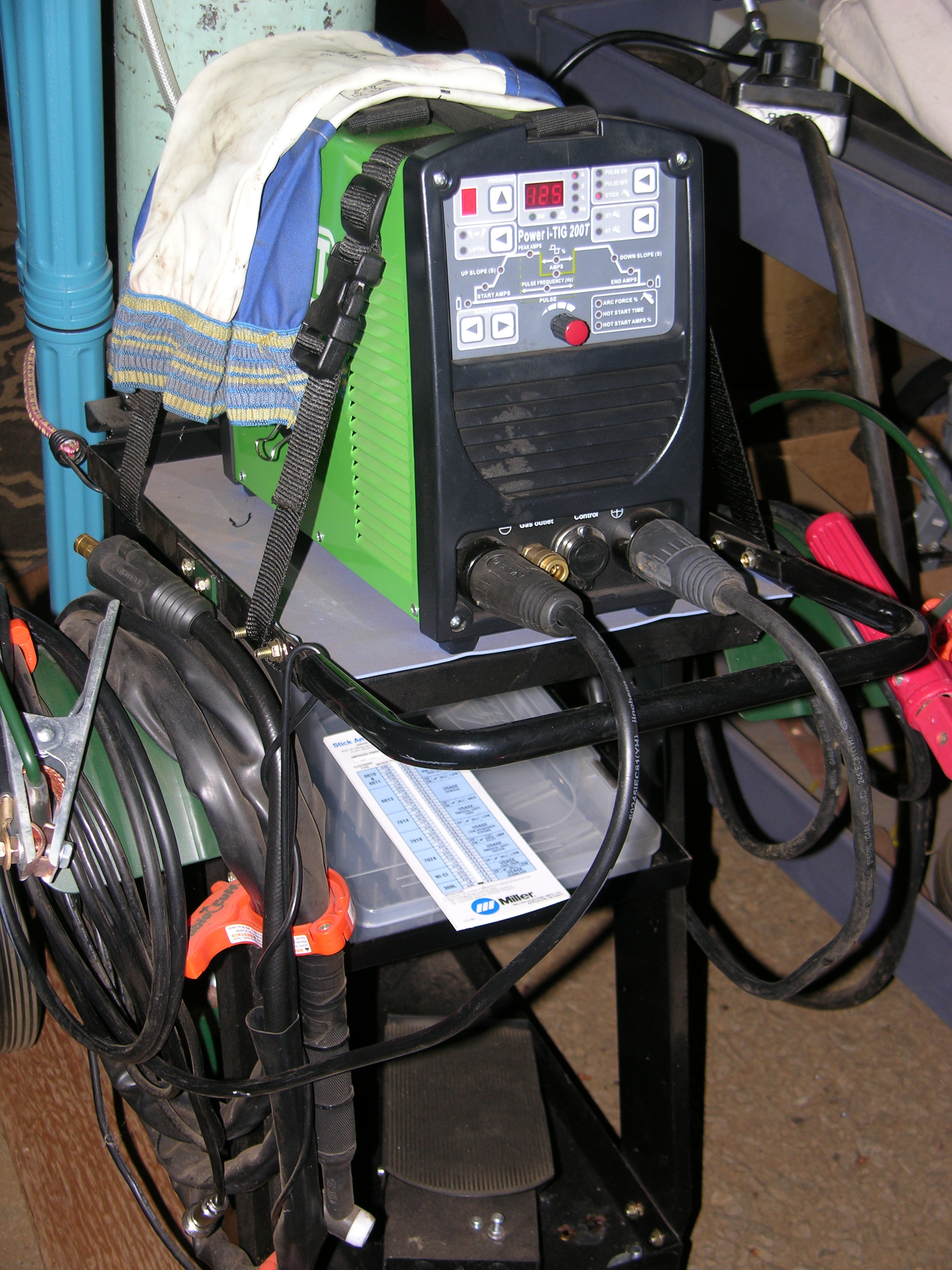

Well, looks like manana's gonna be "critter cap" day, I'll cut 1/4" plate to cover all the holes in both ends of all the tubes (perfect job for the PM45 and a straight edge) - DSCN3357.JPG Found some 40-year old 1/8" 7014 rod; it's been about 10 years since I used stick for ANYTHING (5/32" 7018 modding my Gannon box so it'd work with the quick hitch) - so I was a bit leary of trying it without some "re-remembering", but - DSCN3353.JPG DSCN3355.JPG DSCN3356.JPG - Those welds in the last 3 pics were all done with OLD 7014 rod and this - DSCN3359.JPG
All the more impressive to me considering 40 year old rod, 10 years since I'd even TOUCHED a stick machine :thumbsup: - I gave it a little bit of hot start (.8 seconds @ +14%) and a little bit of "arc force", AKA "dig" ? (I think 10%) - and it just laid down easy like I re-remember NEW 7014 used to do 40 years ago :rolleyes:

For some stuff, I can see a LOT more stick welds in my future (did I mention this little turkey weighs a whopping 18 pounds? Or, that for stick welds that and some leads is all you need? Or that I'd forgotten how nice it can be to have a FAN on you without getting bird crap welds??!?

Oh, almost forgot - the ONLY complaint I have with the "little green monster" - same as with ALL new welding machines; the LEADS are too dang short (like, barely 10 feet each) - I thought I'd already SOLVED that one when I bought it, but turns out all I did was BUY a couple feet of lead and enough connectors to make 2 ADAPTERS for the stick part - so it probably won't be long til I dig out that stuff and make it so my 100 feet of stick weld leads can work on THIS machine too... Steve

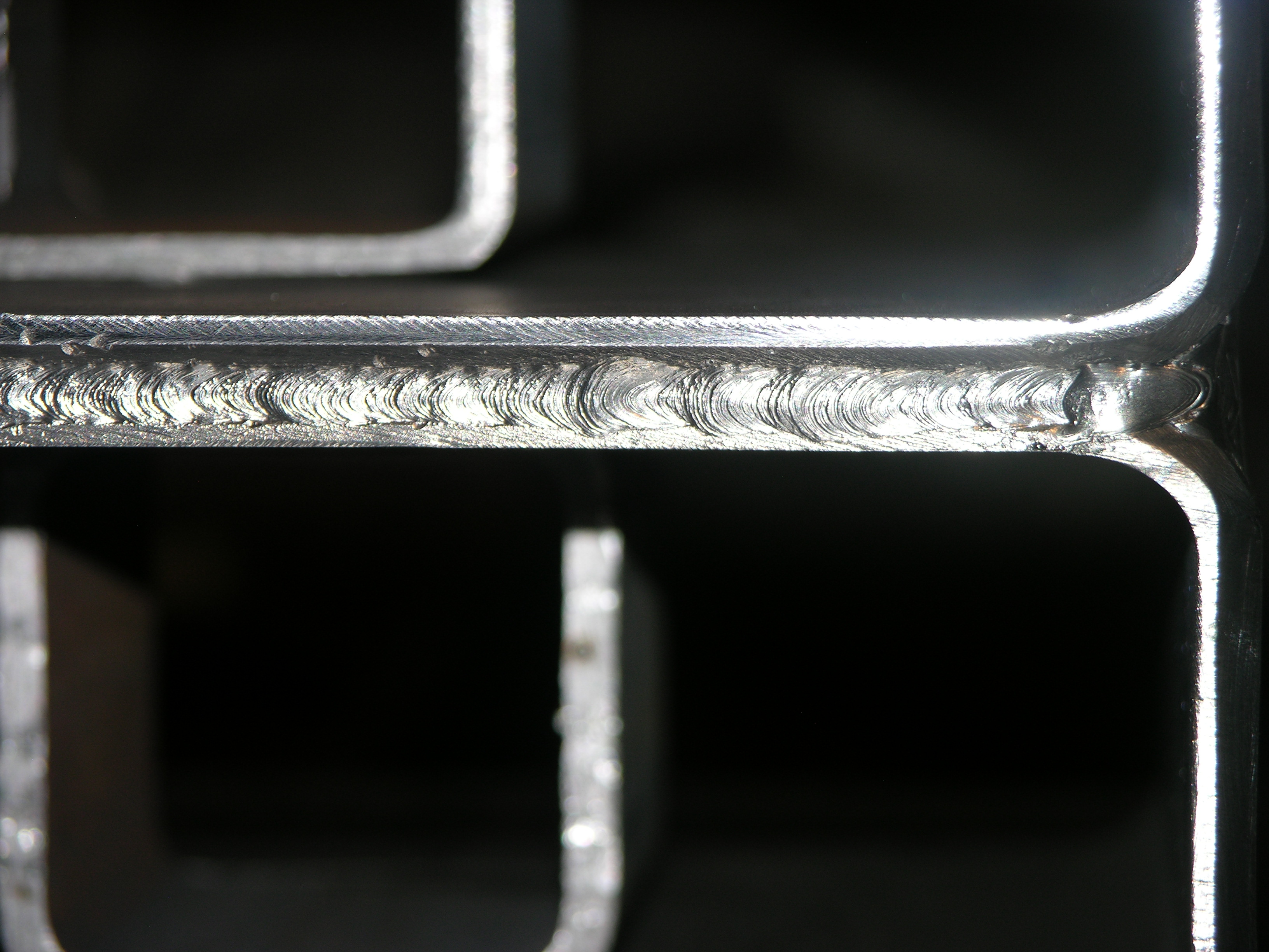

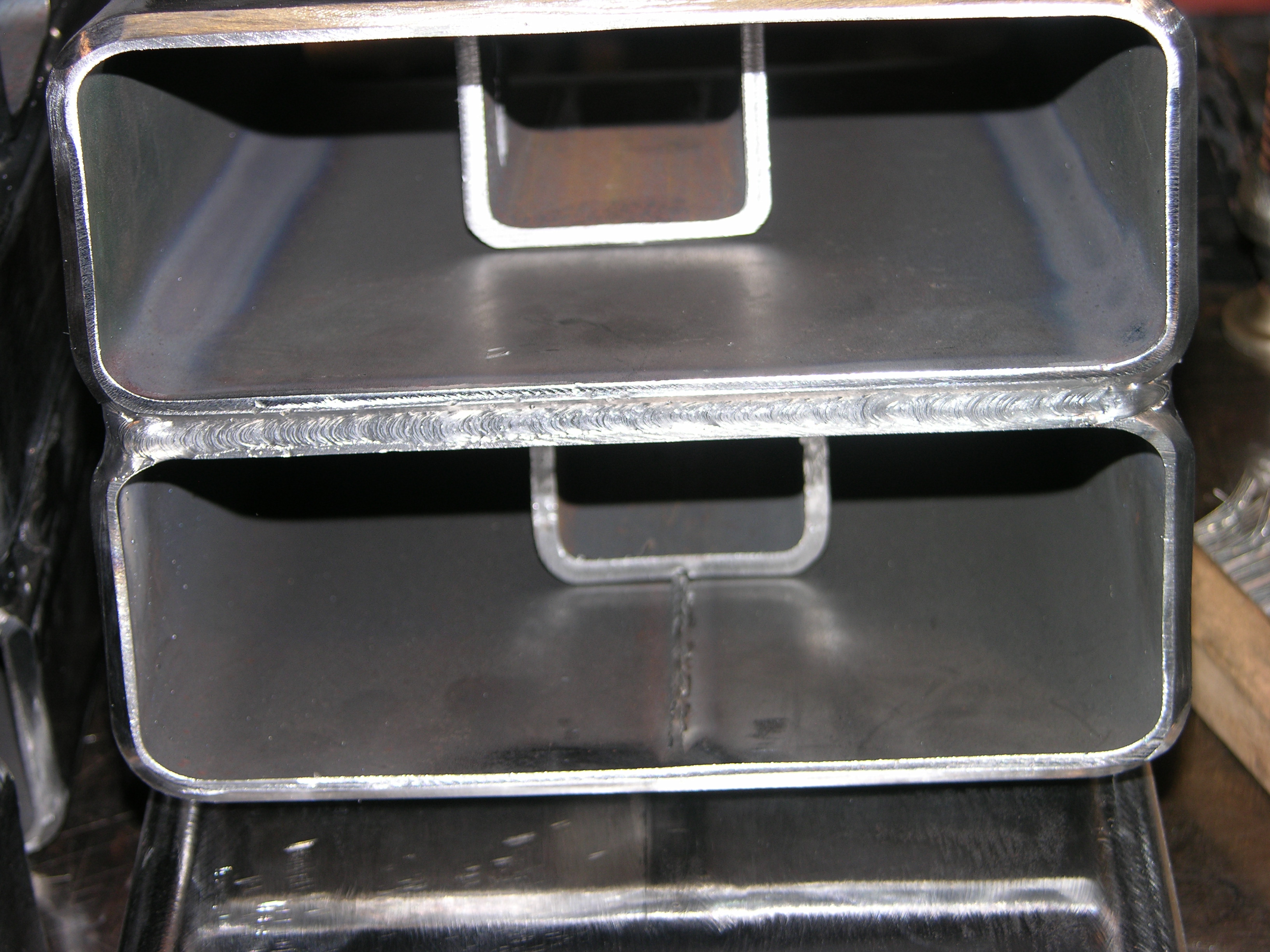

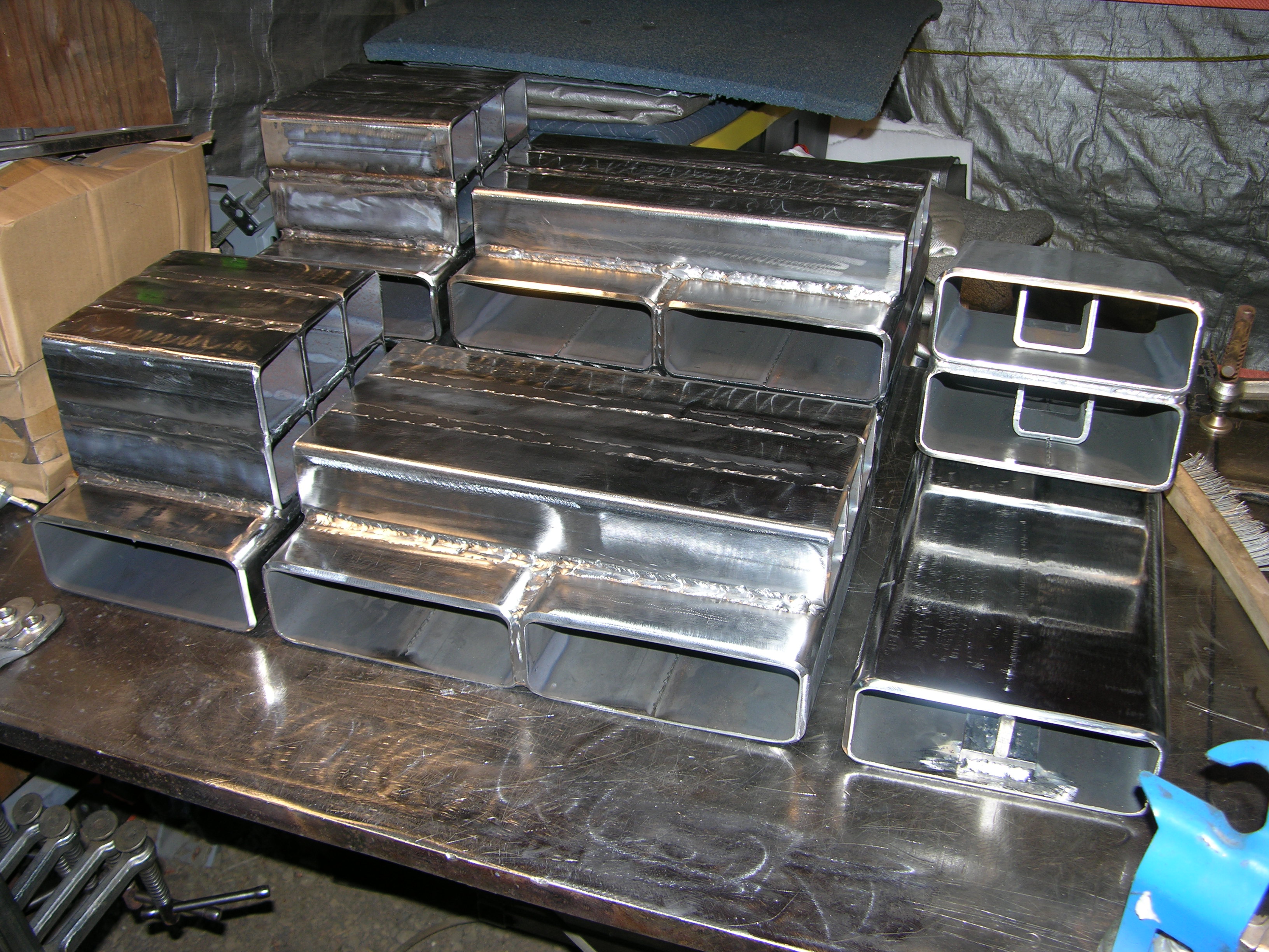

So far I got about 70% of the tubes welded up (not including the "critter keeper-outers") - one of the "pyramids" is just two of the 3x8x 12" long tubes stacked; it seemed to me like it might be a little "squishy" with no smaller sized tubes bridging 'em, so I took a couple 4" cutoffs of the 2.5" tube, beveled one end a bit, ground a little groove down the middle (to clear the seam welds), and pressed 'em into the centers of those two 3x8 tubes with the hydraulic press - that should solve that "squishy center" thang :thumbsup:

Now that I got this quote sniped an picked a part, IF IF IF there ever was a time to take a picture, so am I to understand that you pressed a smaller square tube into another square that it just barely fit? I dont understand, where's that picture? I tried that and I couldn't do it without my biggest sledge hammer, I just ended up getting one piece stuck inside another part way in, had to go with a thinner walled outside piece.
I checked the specs on that Everlast welder, says 160 welding amps on stick, that's a little on the low side. barely enough for 5/32 if that. Now if memory serves, years ago according to my accurate welding speed measurements, one Mississippi two Mississippi or was it one Maniac two..........anywho I figured it would take a 5/32 7014 rod to weld faster than .030 70s and a 3/16 7014 rod to weld faster than .035 70s, with the 5/32 I'd have my Century AC DC 250 amp set around 150-170-ish welding amps, 3/16 I'd set it about 230-240-ish amps, I thought 7014 welded slightly better on AC then DC reverse, maybe because it's not a penetrating. rod

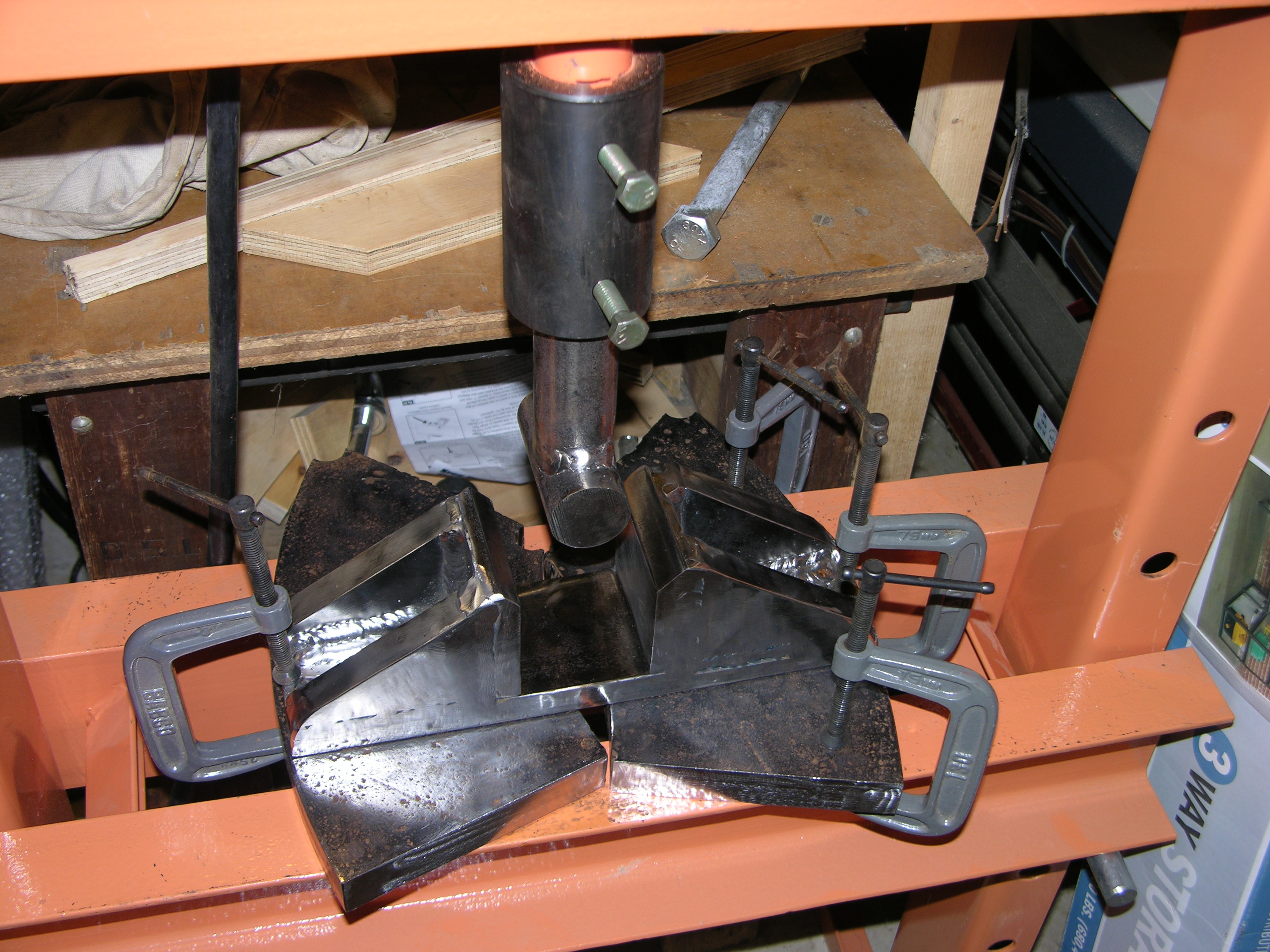

One of these (minus the "U" bracket jig) - DSCN1288.JPG - In my case, it's a 20 ton press - the tubing in question is 3" wide, - 1/2" for 2 quarter-inch walls leaves 2-1/2" for the 2-1/2" tubing that I pushed inside - as you probably found out, the electrically welded SEAM gets in your way. My need was just to beef up the wide tubes so they wouldn't crush, so I used a zip disk and did a small "furrow" down the side of the small tube (it's still1/4" wall, so no biggie) - then I ground a short bevel across the end of the small tube on 2 sides so it'd START a little easier, I lined up my "furrow" with the weld seam on the bigger tube, couple taps with a small (32 oz) hammer, set the whole thing on the press, used that "Tee" pusher in the pic, and held the air on the air/hydraulic jack til it looked halfway there...
No welding necessary, there's enough tension to keep it from moving since any force is only gonna be trying to squeeze things closer together, NOT push the small tube back out sideways...
On the big tube with the Tee bar welded inside - contrary to Terry's assertion that I have half the west coast's supply of steel :laughing:, I actually ran OUT of the 2.5" heavy wall tube, so took 11" long pieces of 1/2" FB and 3/8" FB and stitched 'em together with "greenie" for some center support. All the stacks with the 2.5" tubes running CROSSWAYS shouldn't NEED internal support 'cause the 3 cross tubes are supported by (and bridge between) the vertical walls of the big tubes. (I hope :rolleyes:)
And yeah, it woulda been nice if the STICK side of "greenie" was 200 amps too, but I mainly bought it for the TIG - didja watch Mark's 3 vids? I doubt I'm ever gonna need to weld with less than 3 amps :eek: - I got a bunch of 5/32 7018, I'll probly run the stick up to 160 and see what it does - even at full output it still has a 35% duty cycle, which should mean I can weld 3-1/2 minutes out of ten. 'Nuff to run a stick or two before running the needle gun/wire brush while "greenie" catches its breath, etc...
As nice as these inverters run stick, I might add one of the Powerarc 300's later on; but there's a few other toys higher on the drool chart than that... Steve

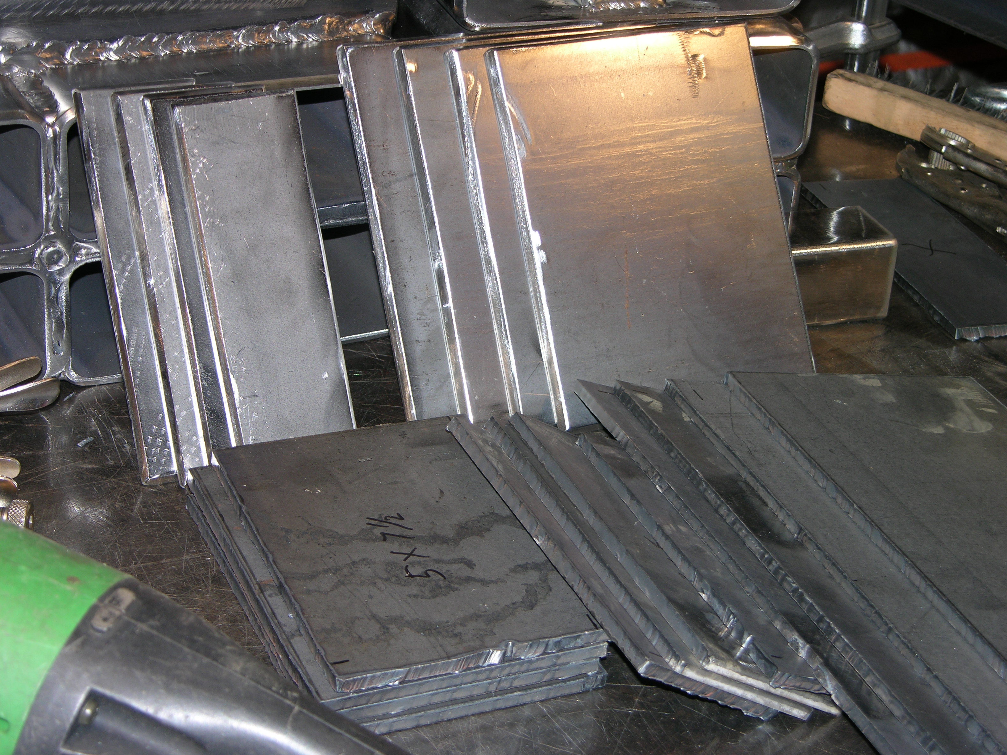

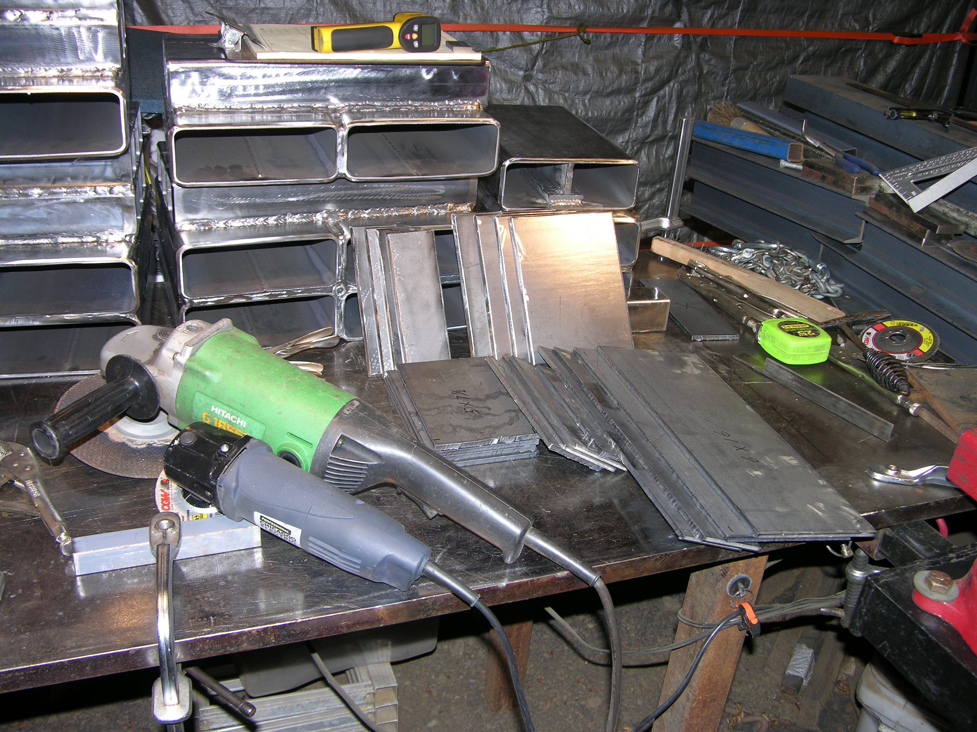

I got all 20 of the 1/4" cap pieces cut today, and 8 of 'em de-glazed, beveled and ready to weld on - my plasma DSCN1514.JPG cuts 1/4" steel at 60 IPM, which makes it real handy to just lay a ruler along the back edge of the 1" angle I use for a guide - DSCN3360.JPG ever since my military time I can count seconds accurate within about 1 second per minute, so I just hold the torch against the guide and move it past the inch marks at one per second - works pretty good - DSCN3362.JPG DSCN3363.JPG - The ones standing up against the pyramids are the finished ones...
