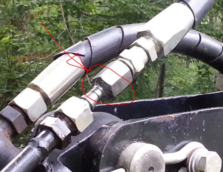

Update:
I turned the entire valve around and ran into some problems. After I welded the new mounting plate, I could not fit the valve back inside...finally it fit. Now I have about two hours of seat time on it. It's both FAST and PRECISE...Amazing. I'm having a problem with the boom dropping too fast. I think the OEM application for this valve was for a smaller BH despite the fact I've rearranged the orifices in the valve stack. In fact , I'm now thinking about inserting an adjustable restrictor valve in the boom dump cylinder discharge. I need more seat time. The new valve makes it faster and more precise so my plan it get some hours on it first. A new suprise was the boom "float" I'm learning about.
A big PLUS is the swing: The Chinese valve forced me to bump the stick and hope for the best. Now I can nudge the swing precisely a 1/2" or so with no trouble. The control of this DINOIL valve is great!

hi steve when you installed the new valve how did you go from metric fittings on the cylinders to the JIC or NPT fittings on the prince spool valve? I've seen adapters but there $34 a piece times 14
   / Convert Chinese Backhoe to Prince BH Control Valve Assembly?
#45
I used screw-on adaptors from Ranch Hand on all but one cylinder. For that one cylinder I'd already changed over the hose by welding on a male JIC as per image below. This was done by removing the China ORFS female end from the Chinese hose and welding it to a male JIC. From there I made up my own hose using common "reusable hose ends".
