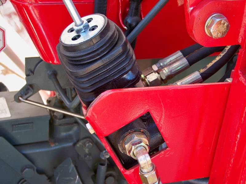

I tried again. almost broke the stick off.
I guess the cheap VTEKS loader just didn't think it was necessary

Do you have a joystick valve for your loader, or a valve with two levers?
How old is the tractor?
On the bottom of the valve, do you see a cap like device with two screws.
This joystick valve from Prince, is just an example of what a float assembly might look like. There are some little balls that drop in a groove when you are in float. If they are rusty or dirt is blocking the float action, you will need to inspect, clean and lube.
Look on page 7

Hi J J
Not sure of the brand of the valve.
I looked at the link and my valve does not have the extra levers.
I will try to get some useable pictures of it to post.
Old Gray market 80s 1500d.
:thumbsup:Loader probably put on in Korea or Vietnam.Just guessing.

J J
Just for your enjoyment.:laughing:

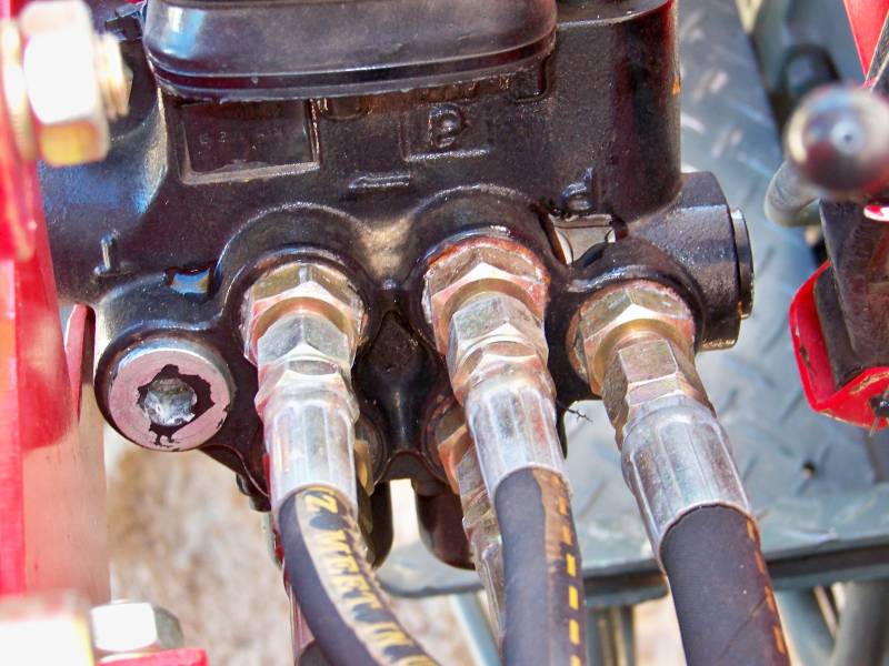

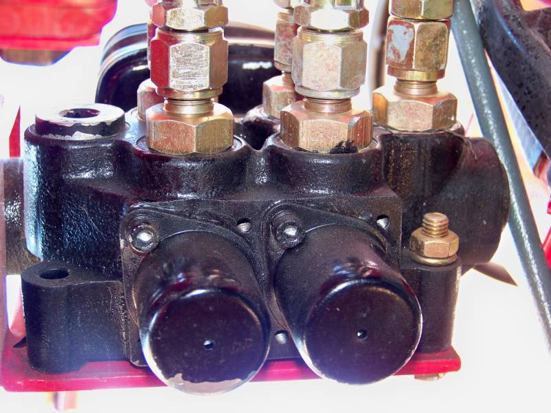

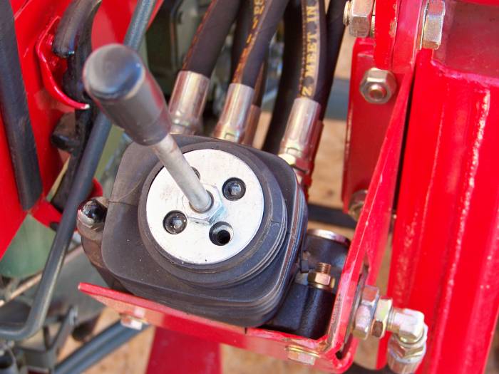

Pictures of my loader valve.
Can you tell what I have?:confused2:
Bottom  view3.jpg Bottom
from front3.jpgFront
Right side toward loader3.jpgRight Side
Top View3.jpgTop
/ Convert Joystick #15
In the top picture, it looks like you have a bolt miss. Is it? That might not let the valve work right.
/ Convert Joystick #16
Have you removed the caps on the lift spool to check the condition of the parts under the caps.
The picture I posted above, is an example of a detent assembly. If you remove the cap, be careful as springs and steel balls may spring out. have a magnet close by or a rag over the cap when removing.
You may not have a float, but most loader valves do.
I also noticed a valve body bolt missing. Sometimes, loose bolts or over tighten bolts will cause a valve not to work correctly.

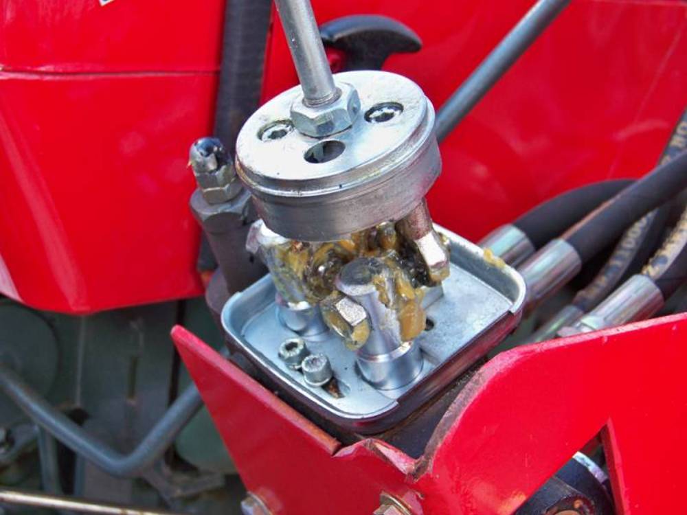

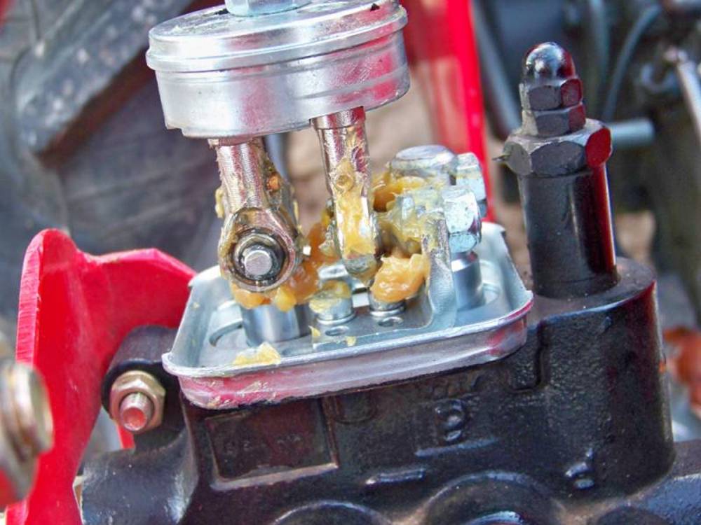

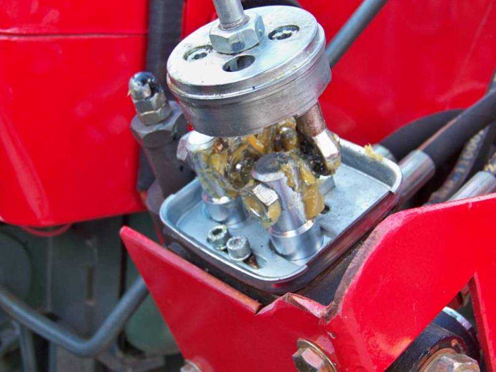

Well I was worried about the screw missing in the Valve cover.
I took the boot off and took a few pictures.
I don't know why the hole is empty but there is nothing for a screw to thread into.
See attached pics
/ Convert Joystick #20
The missing bolt I was talking about is on the valve body.
Post # 14 left side. There is a bolt and nut on the right side.
Those two holes on the top plate with the lever attached, is probably for use if the other holes get worn out.
