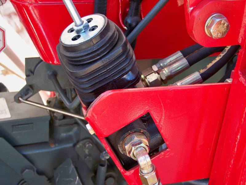

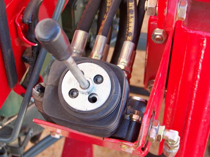

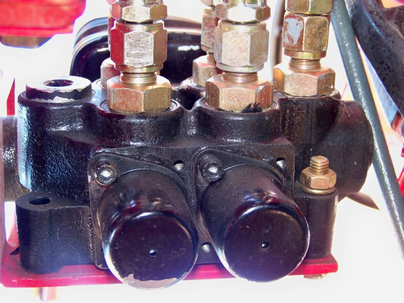

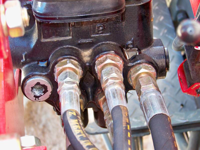

Pictures of my loader valve.
Can you tell what I have?:confused2:
Bottom  view3.jpg Bottom
from front3.jpgFront
Right side toward loader3.jpgRight Side
Top View3.jpgTop

In the top picture, it looks like you have a bolt miss. Is it? That might not let the valve work right.
/ Convert Joystick #16
Have you removed the caps on the lift spool to check the condition of the parts under the caps.
The picture I posted above, is an example of a detent assembly. If you remove the cap, be careful as springs and steel balls may spring out. have a magnet close by or a rag over the cap when removing.
You may not have a float, but most loader valves do.
I also noticed a valve body bolt missing. Sometimes, loose bolts or over tighten bolts will cause a valve not to work correctly.

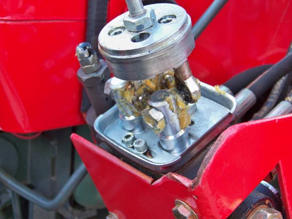

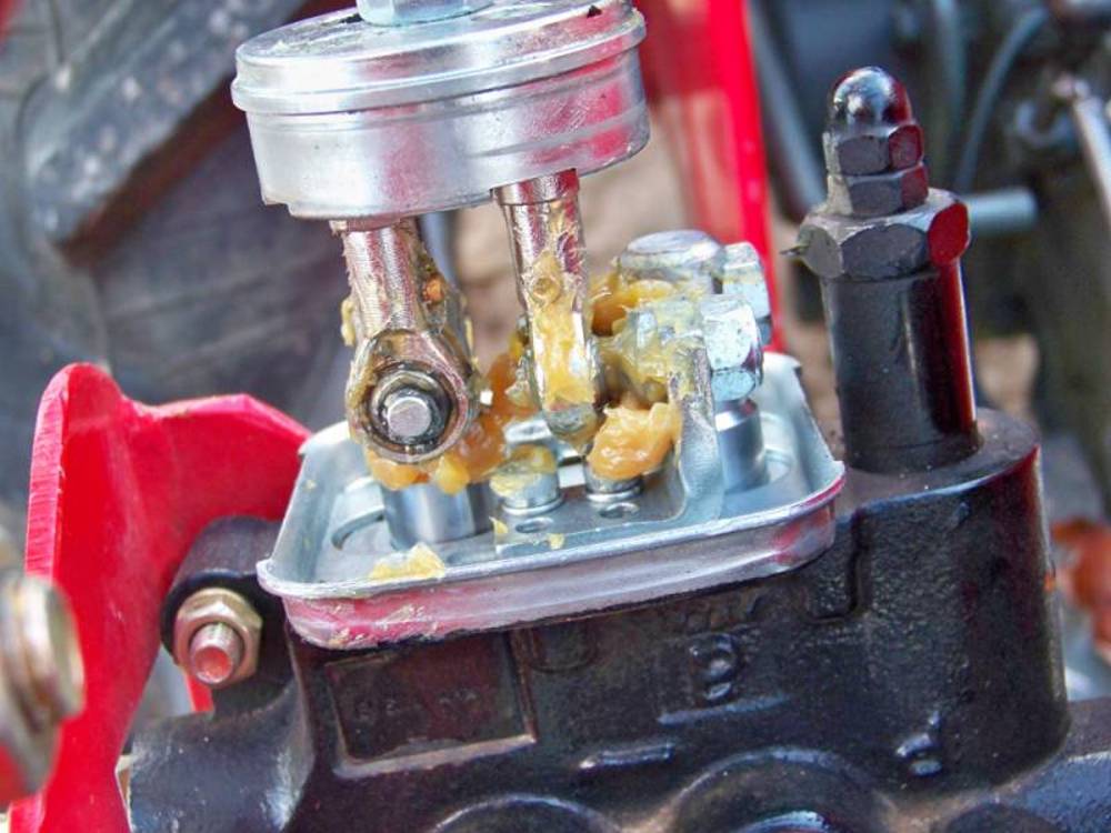

/ Convert Joystick
#19
Well I was worried about the screw missing in the Valve cover.
I took the boot off and took a few pictures.
I don't know why the hole is empty but there is nothing for a screw to thread into.
See attached pics
/ Convert Joystick #20
The missing bolt I was talking about is on the valve body.
Post # 14 left side. There is a bolt and nut on the right side.
Those two holes on the top plate with the lever attached, is probably for use if the other holes get worn out.
