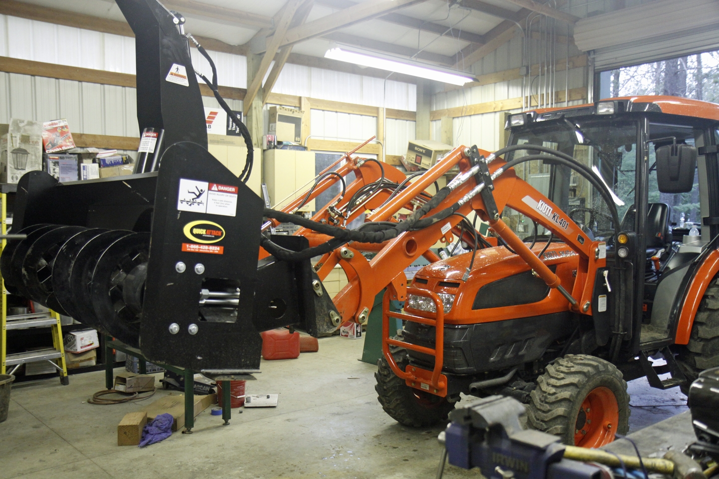

the ones like i have....not cheap . but my neck was all screwed up after 14 years of rear snow blower.

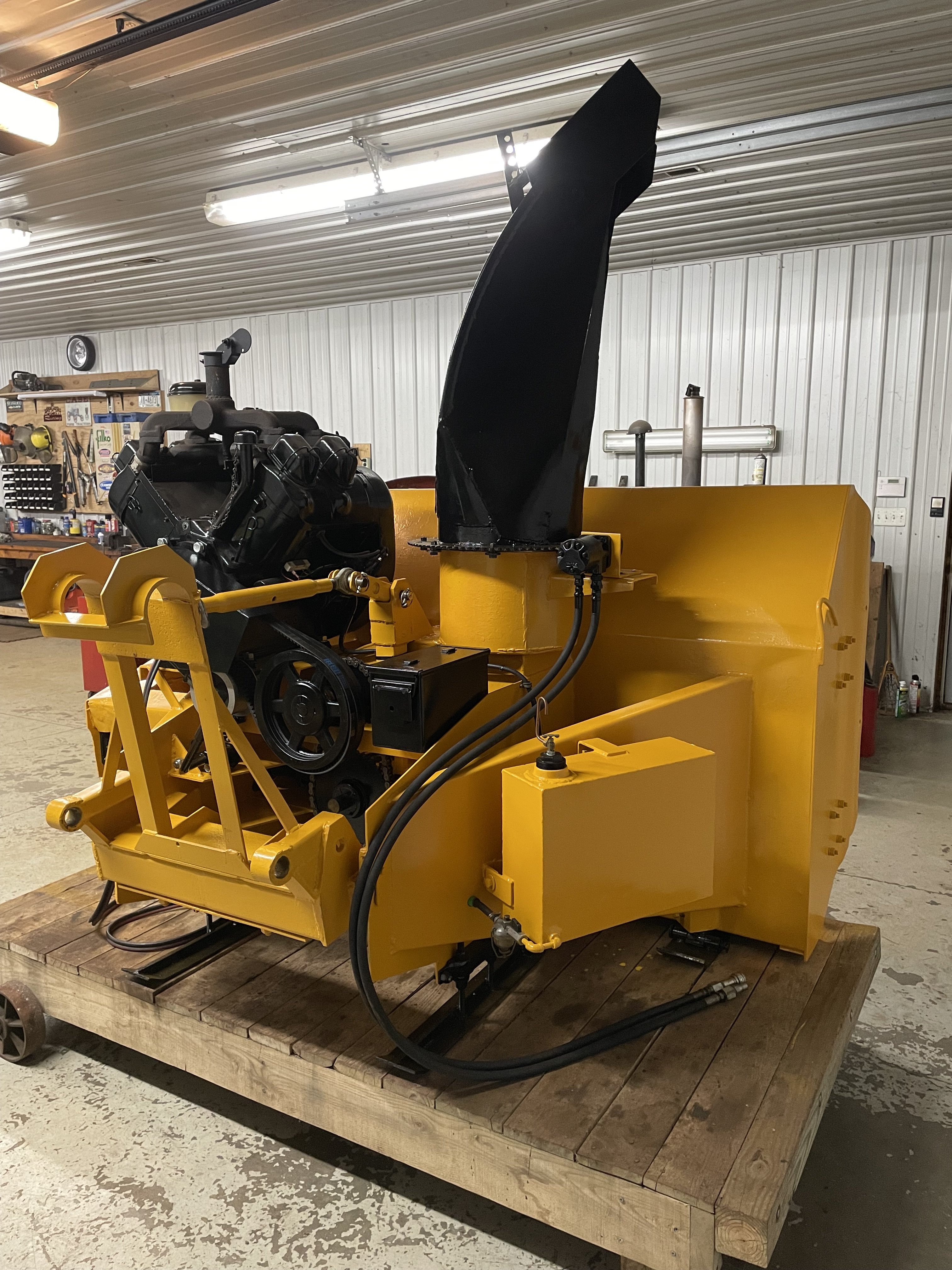

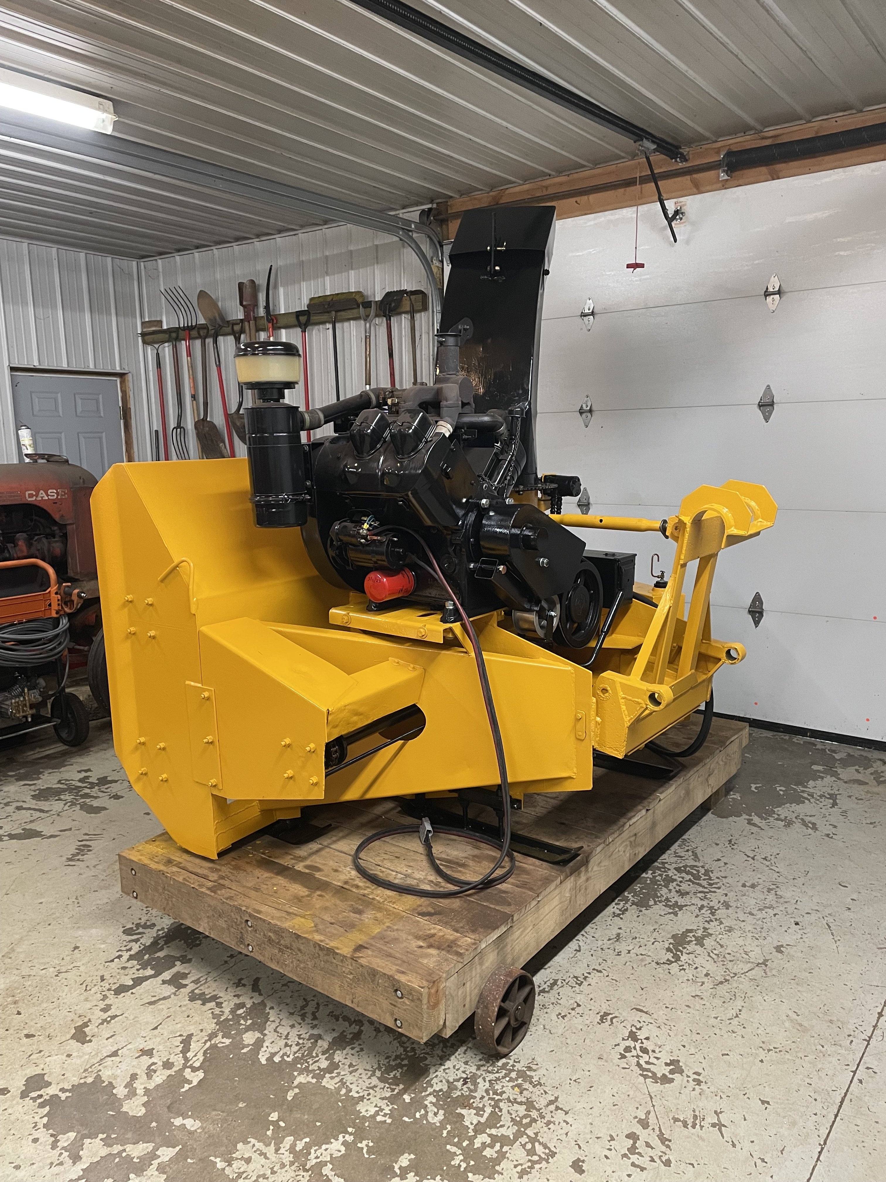

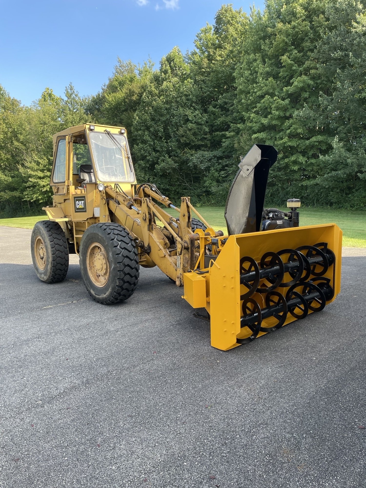

Been there, done that. I added a Wisconsin V465 air cooled to a 7' Loftness dual auger blower and mounted to my CAT 910 wheel loader. Fun project. Here is a picture taken back when the weather was a bit nicer. You'll want around 3 to 4 horsepower minimum per foot of blower width. The Wisconsin I used is rated at 65 Hp, so its plenty for my setup. I run the chute rotation with an auxiliary hydraulic circuit.

I used a 2:1 ratio belt drive speed reduction to a jackshaft that then runs a 1.5:1 ratio chain drive down to the input gear box for the blower. That gives an overall 3:1 speed reduction from the engine to the blower input shaft. I usually run the engine speed to get around 700 RPM or so on the blower impeller. That will throw the snow around 60 feet or so.
How much does your blower weigh? That is one good looking machine.
/ Convert pto snow blower to engine #18
I don’t know exactly. I’m sure it’s pretty heavy. According to the specs I have found, the Wisconsin weighs about 530 pounds. The blower is probably in the 1200 to 1500 pound range without the engine. The wheel loader picks it up without complaining. ;)
/ Convert pto snow blower to engine #19
It’s certainly possible to build a setup that is smaller and lighter than what I built. Keeping the unit as close to the loader lift arms as possible will certainly help. I eliminated some unnecessary weight by using the loader’s battery to start the Wisconsin and run the ignition system rather than adding another battery on the snowblower itself. I fabricated my own quick attach mount on the snowblower to match the factory Balderson style on the loader. Here are a couple pictures showing the quick attach mount just after I painted the snowblower. The cable in the first picture is for the electrical connection to the loader.
