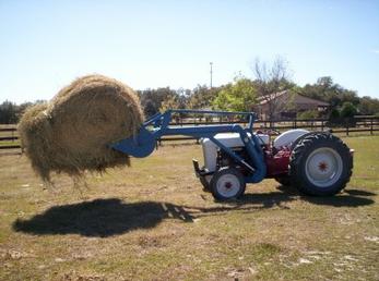

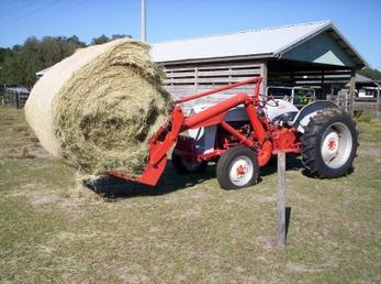

Both 1955 vintage
2wd
No power steering
I agree with Roy....If ya got power steering.. your limited use FEL won't be too big of a problem...
Soundguy
