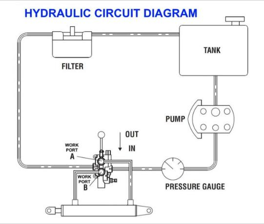

Many valves are "preset set" to 2000psi but many splitters are adjusted to go to 3000 psi.... Read spec on valves carefully there may be some statement about readjusting and maximum pressure valve is rated at.... My stand alone splitter has a 6.5 HP Predator motor (replaced 5 HP blown up B&S) that barely even changes pitch with the toughest oak logs.... Splitter is rated at 20 ton and If i have the math correct for a 4 inch diameter cylinder, the pressure relief on valve is set at 3000psi... The specs on my splitter states it has a 7 gallon tank... Also ideally pump should be two stage.... Not sure how familiar you may be with stand alone splitters, but diagram below shows all the essential parts and etc: (pressure gauge may be optional)

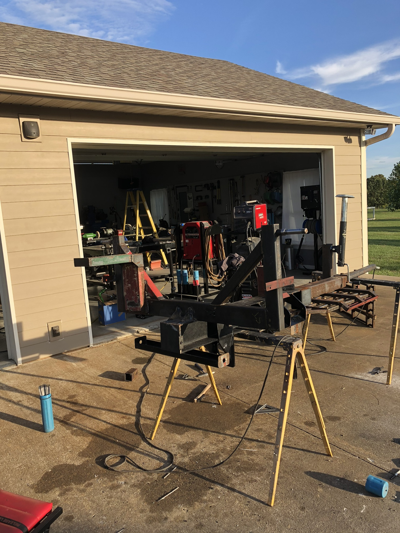

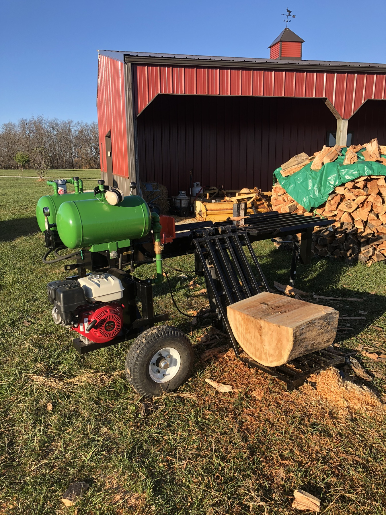

I converted my Northern Tool 3pt to a stand alone splitter. It was good as a 3pt unit but I did not like having my tractor tied up running the splitter. The conversion allowed me to add a large out feed table and a log lifter. I used a Honda GX270 engine with MTE 16 gpm two stage pump, Prince hydraulic valves, and Harbor Freight air receivers repurposed a hydraulic tanks. Fun project.
/ converting 3pt splitter to pull behind
I converted my Northern Tool 3pt to a stand alone splitter. It was good as a 3pt unit but I did not like having my tractor tied up running the splitter. The conversion allowed me to add a large out feed table and a log lifter. I used a Honda GX270 engine with MTE 16 gpm two stage pump, Prince hydraulic valves, and Harbor Freight air receivers repurposed a hydraulic tanks. Fun project.View attachment 711059View attachment 711060
Thank you for those pictures, I really like how that was done and that is exactly what I would like to end up with. any chance you have any other pictures? I see you put a pressure gauge on there, what pressure do you have the relief set at? also do you ever use a 4 way splitter on it or is there not enough force?

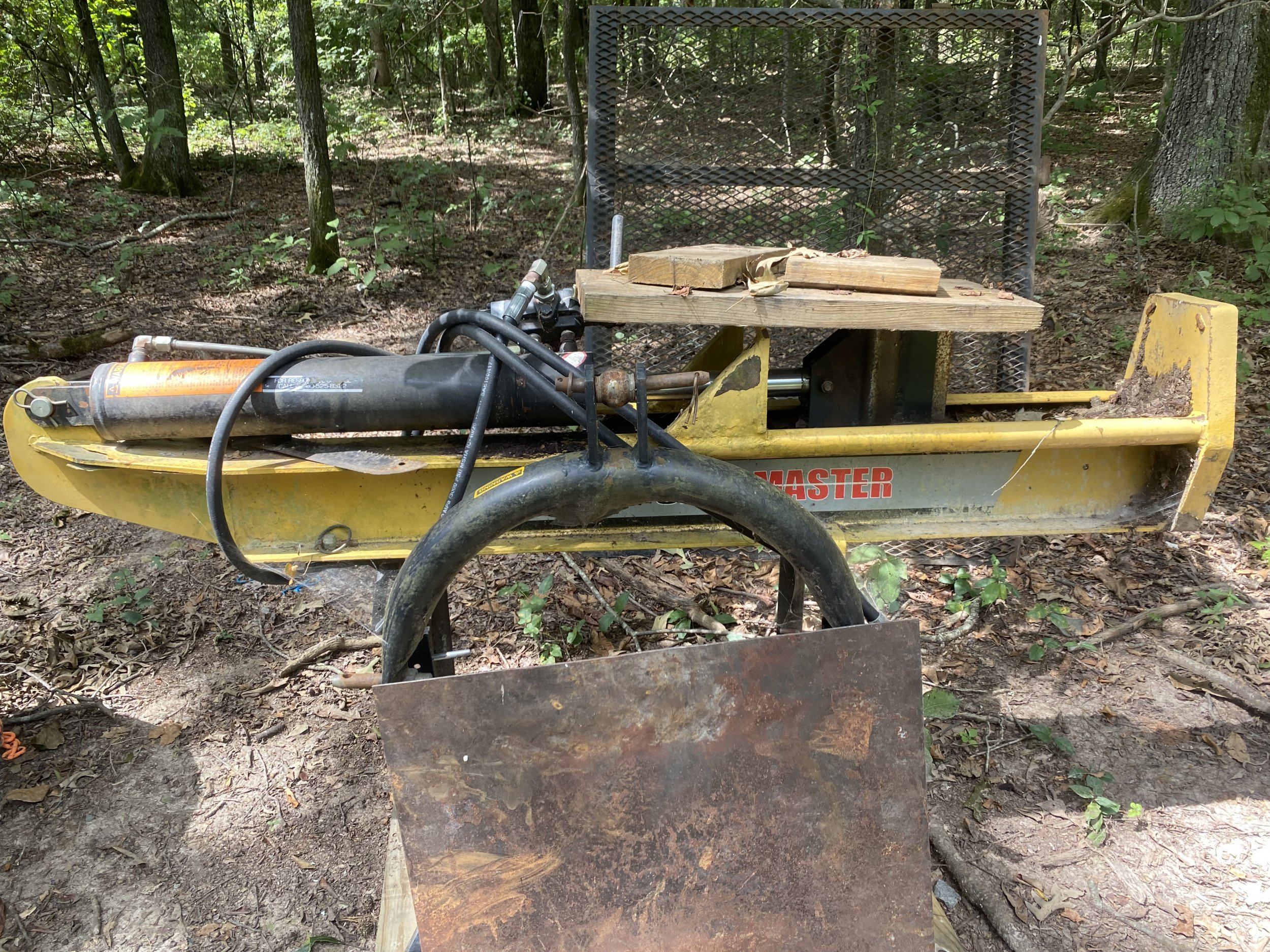

I did just the opposite i left mine pull type but took all the hydraulics and motor off and now run it off my tractor. I built this in 1985 from mostly stuff i scavenged i can split a 8 ft fence post by unbolting the wedge and rebolting it out to the end shes not pretty but been working for 36 years now
The relief valve pressure was unchanged from the Prince valve factory setting of 2250 psi. I have never tried a 4 way splitter as the single splitter wedge is plenty fast for me and gives me good control on each log size. The hydraulic pressure observed on the gage rarely exceeds 1500 psi during a split and is usually down in the 500-700 psi range so it seems to have plenty power (4”x24” cylinder). The biggest benefit of the conversion was the log lifter. It allows me to stack 5 - 7 logs on it at time. That in conjunction using a hookaroon to drag logs on to the lifter mean you never have to bend over while splitting. Additionally, the large out-feed table allows the splits a place to stack up. More pics as requested.

Thank you for the pictures, that looks great. I'm going to look at our splitter tomorrow and see how it compares.
couple quick questions. I see you and lots of the factory log lifts use a wheel to lift the log lift, why do it this way vs. pin direct to the log lift?
do you like the controls being separate or would it be better to relocate the splitter valve to beside the log lift valve?
what size angle did you add to the splitting wedge?

I used the wheel on my log lifter because I had built the lifter frame geometry with larger angle from vertical which makes it longer and the less steep. It allows me to load 6 or more logs on it at one before lifting. This also causes the end of the lifter frame to extend past the wheelbase causing parking/storage problems. Since the lifter frame is not pinned, only resting on the wheel, it’s allows for the lifter frame to be pinned vertical for storage. Most of the designs that I see that are pinned use shorter lifter frames that don’t extend out past the wheelbase.
I like the controls separate to minimize the probability of getting them mixed up. I also like that they are orientated such that the movement of the valve control handle mimics the action of the cylinder it controls. Pull the splitter cylinder valve control forward and the ram moves forward. Pull it back and the the ram moves back. Same with the log lifter. Log splitters can be tough on hands/fingers so I worked to minimize any error traps on it.
The angle iron I welded to splitter wedge was 1-1/4”-3/16” thick. It is pretty effective at popping logs apart after the sharp front edge of the wedge gets the split started.
