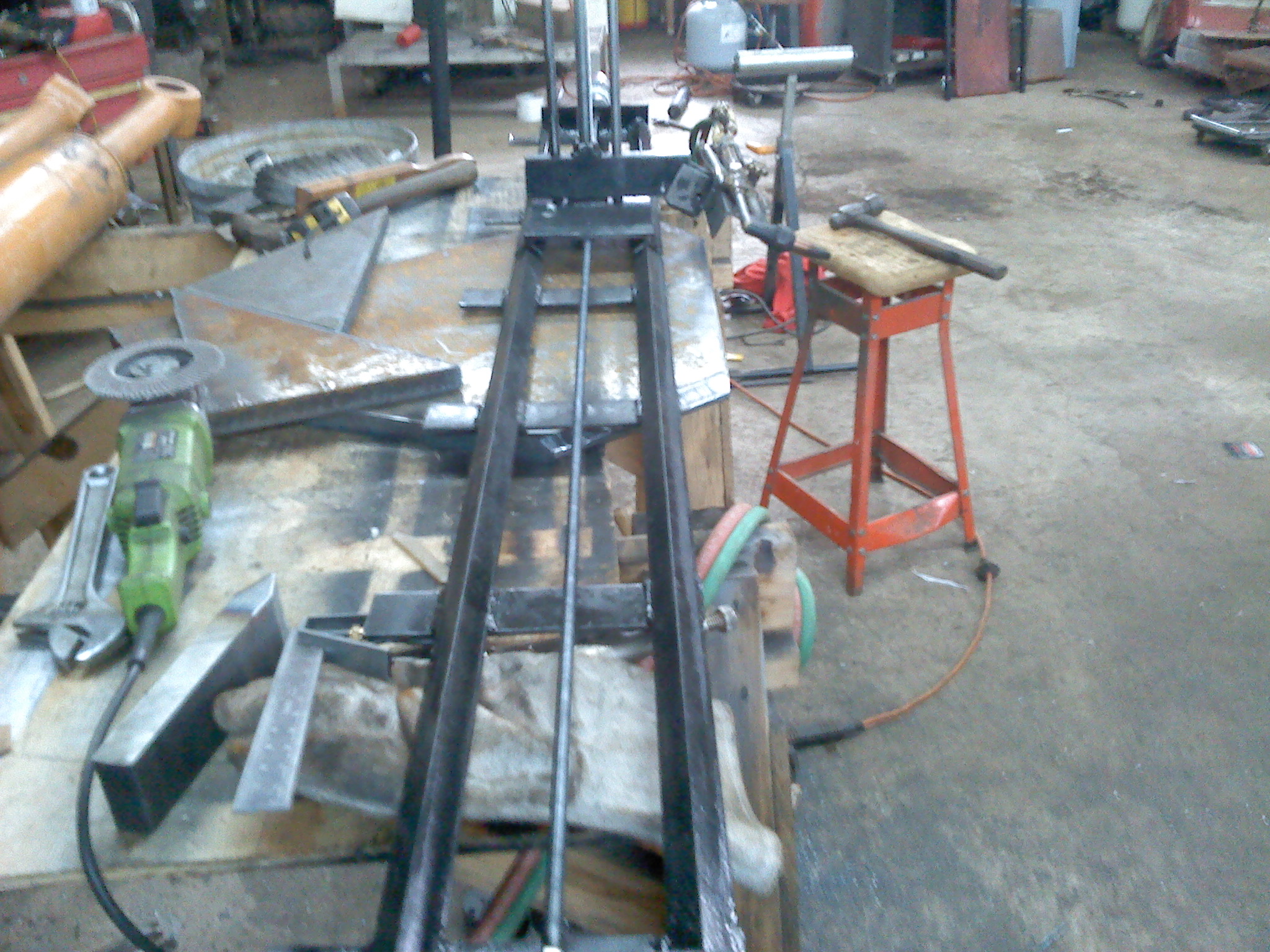

Made a little trip to TSC. I found a bushing that was a perfect fit .1102151734.jpg. 1102151736.jpg I wanted to figure out a way to mount the plasma torch where I had my gas torch mounted. 1102151732.jpg. After looking at it, I decided to just turn the mount around and figure out a way to mount the plasma on the opposite side of the holder. 1102151739.jpg Right now the height adjustment is all the way down and the tip is setting on a piece of metal about 3/16 below the track rails. With the amount of adjustment on the holder, that should be more than enough to set torch height. Tomorrow, I will cut me a piece of plate to weld the bushing to and drill a couple of bolt holes to bolt the bushing to the frame. I looked for a on/off/momentary on switch but didnt have any luck finding one so I am just going to use the on/off switch I already have and maybe order the one on ebay later.

Made a practice cut today1105151410.jpg As you can see, it cut pretty smooth, but cut with a slight bevel. You can also see I about burnt up my thrown together bench. Things kind of got smokey. I cut the torch loose and rewelded the mount, thinking I had it straight, but it still cuts with a slight bevel, so I guess I will be cutting it loose one more time to try and get it right. I also figured out the wireing for the remote switch. Inside the machine there is a three wire plug. the wires are orange, blue and violet. I am pretty sure the orange wire is for the thermal switch inside the torch hande. Connecting the blue and violet wire will turn the torch on. I havent been able to source a on/off/momentary on switch locally, so i guess I will be ordering one. To make the practice cut, I used a set of vice grips to hold the switch. It works, but Not something I want to rely on. To much of an opportunity to grip the switch to hard and break it. I am also going to look for some thumb screws to hold the torch in the mount. Nothing like twisting with a long handle wrench to break something.
Need to ask, I am getting a pretty good amount of dross, is this because I am moving to slow or moving to fast, or maybe not enough air pressure, to much air pressure. Torch height is between 1/8 and 3/16.
