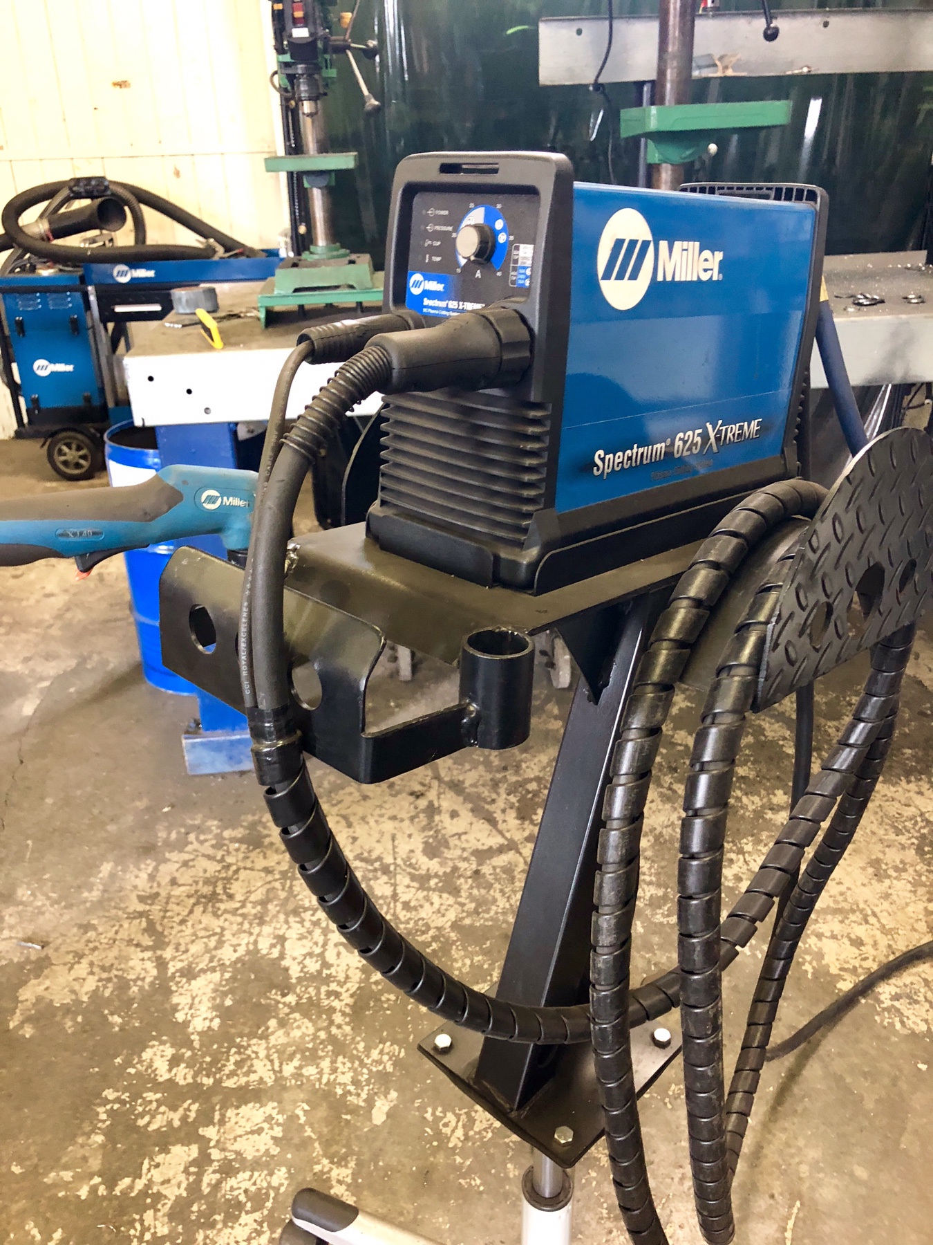

Terry, in the first picture, I see you have spiral wrap on your torch cable. Looks to be nice and smooth (rounded edges). Do you know the brand? I assume you put that on. Spiral wrap that I have used in the past had sharp edges and easily pinched my hand.

I don’t see a brand name, Mark. It may be Greenline. I just bought 3/4” ID hydraulic hose spiral wrap from my hose supplier.
Here’s a close up
I used the same wrap and enclosed the (upgraded) 6 gauge ground cable together with the torch cable for my smaller plasma cutter.
I think that sharp edge stuff was Heli-Tube. Victor had a sharp edge type too that was blaze orange. I like this black stuff much better.

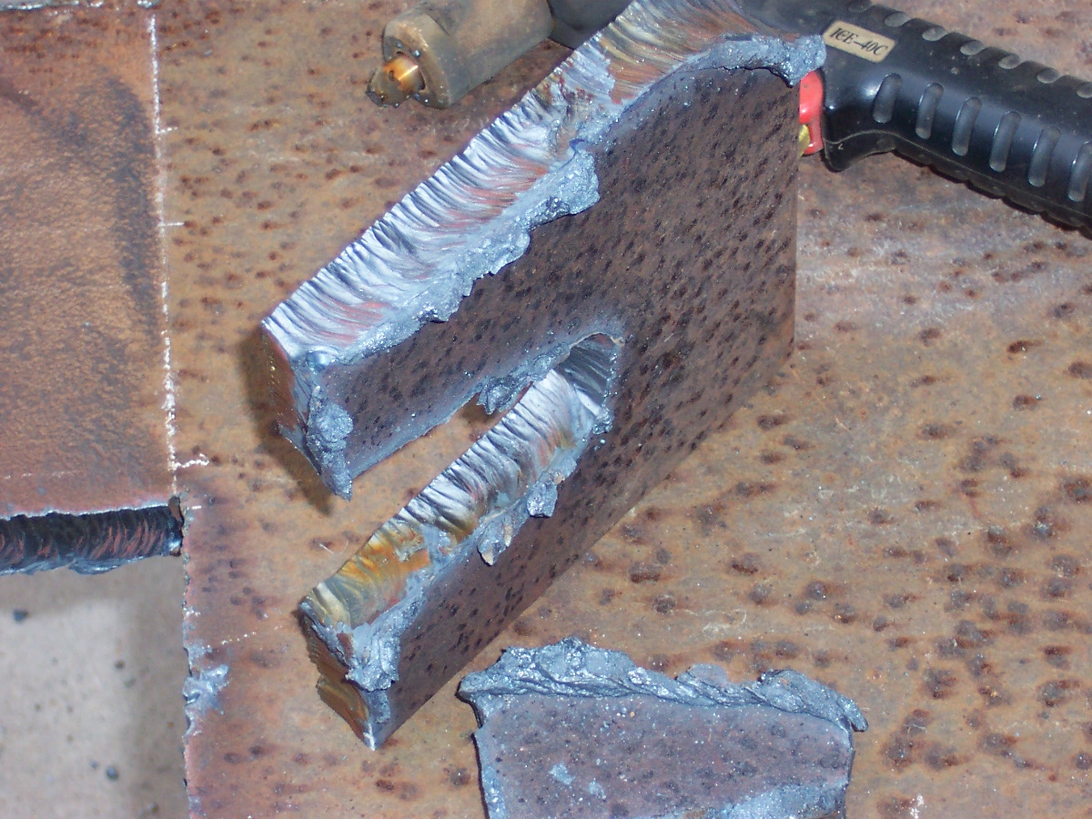

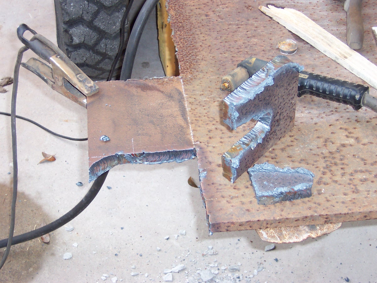

I've posted these pics before of cutting 3/4" with my Miller Spectrum 625.
This was probably the outside limit of my machine but it did cut it slowly. I am very happy with it.
Where it really performed for me was cutting 3/8 and 1/2 bolts covered with mortar.
It melts the mortar instead of spitting and popping like with O/A.
