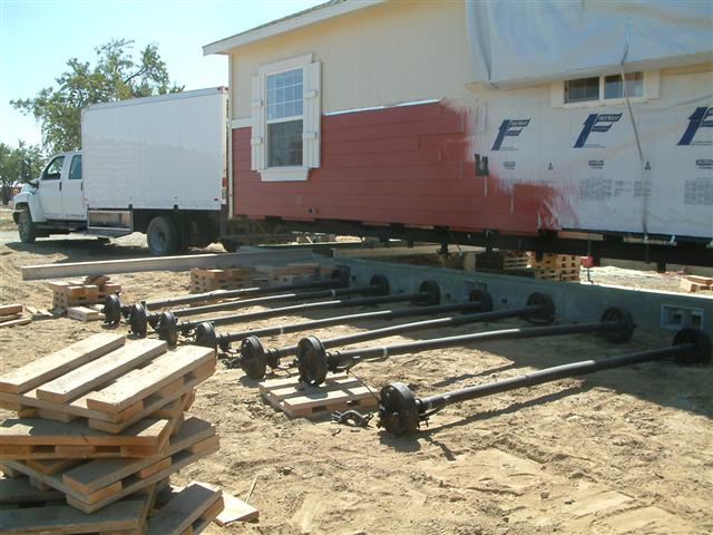

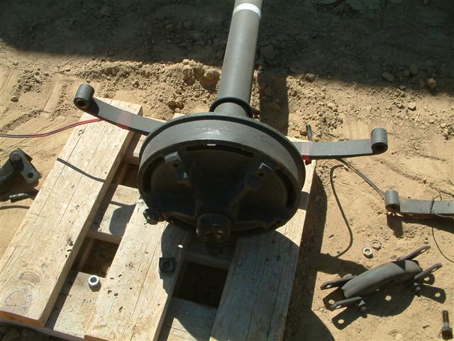

Those axles are illegal in CA for reuse (that's what the sticker says on the axle). The front half of my double-wide MH weighed nearly 40,000 lb and had 7 of those MH axles under the frame. The MH was manufactured in Portland OR and transported down I5 to my place.
