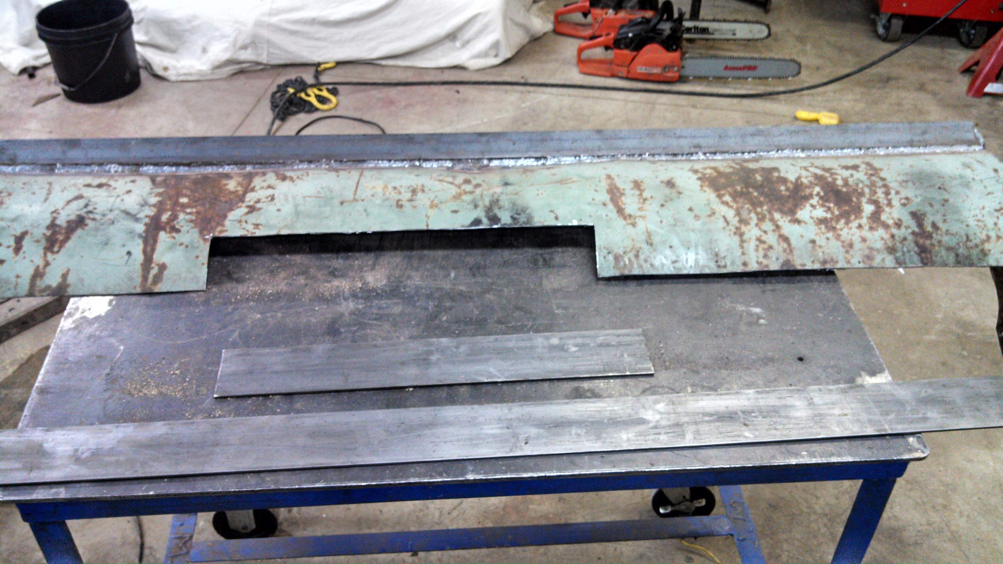

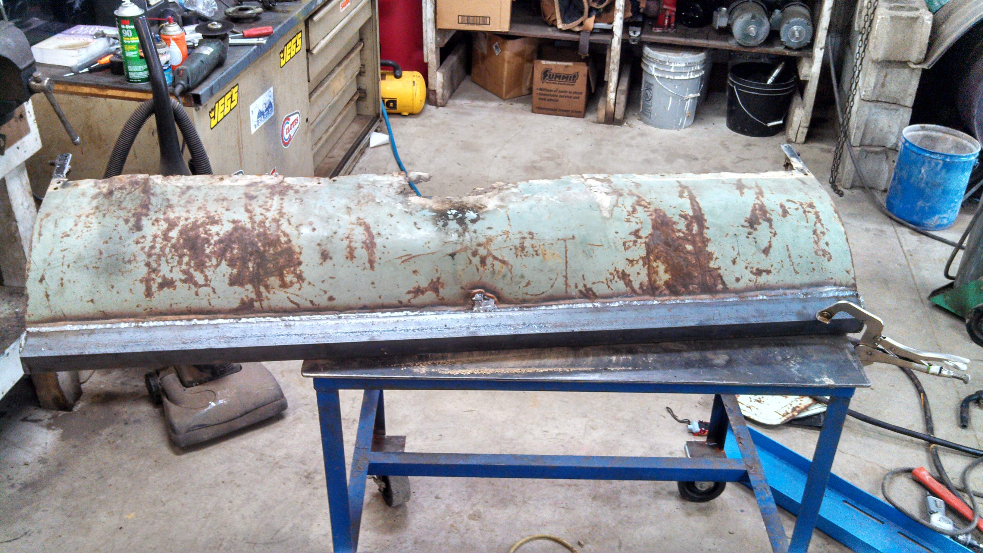

Heres a start on repairing the shield
Peice of 2 x 2 x 1/4" angle laid in there. That should make it pretty ridgid.

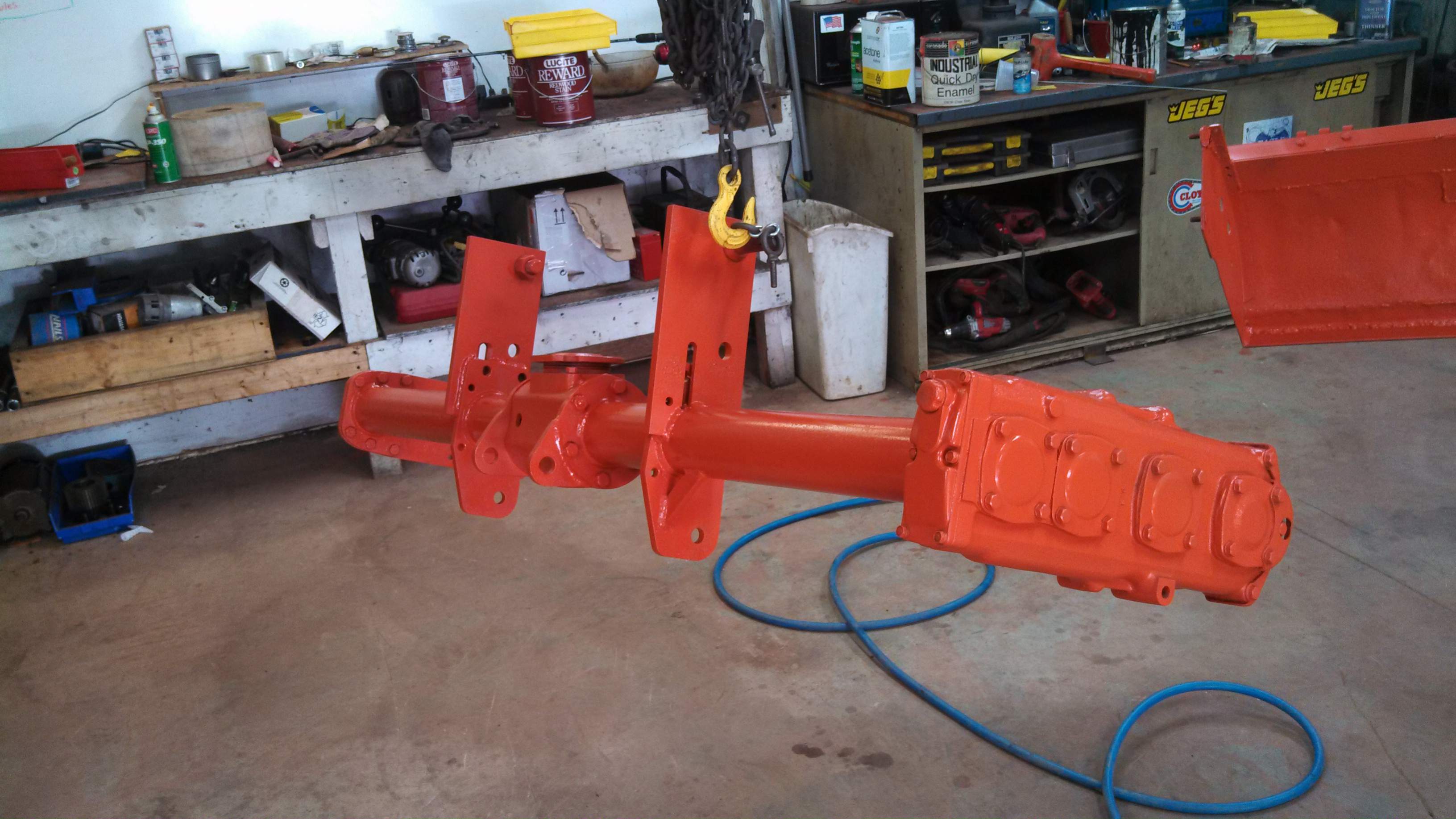

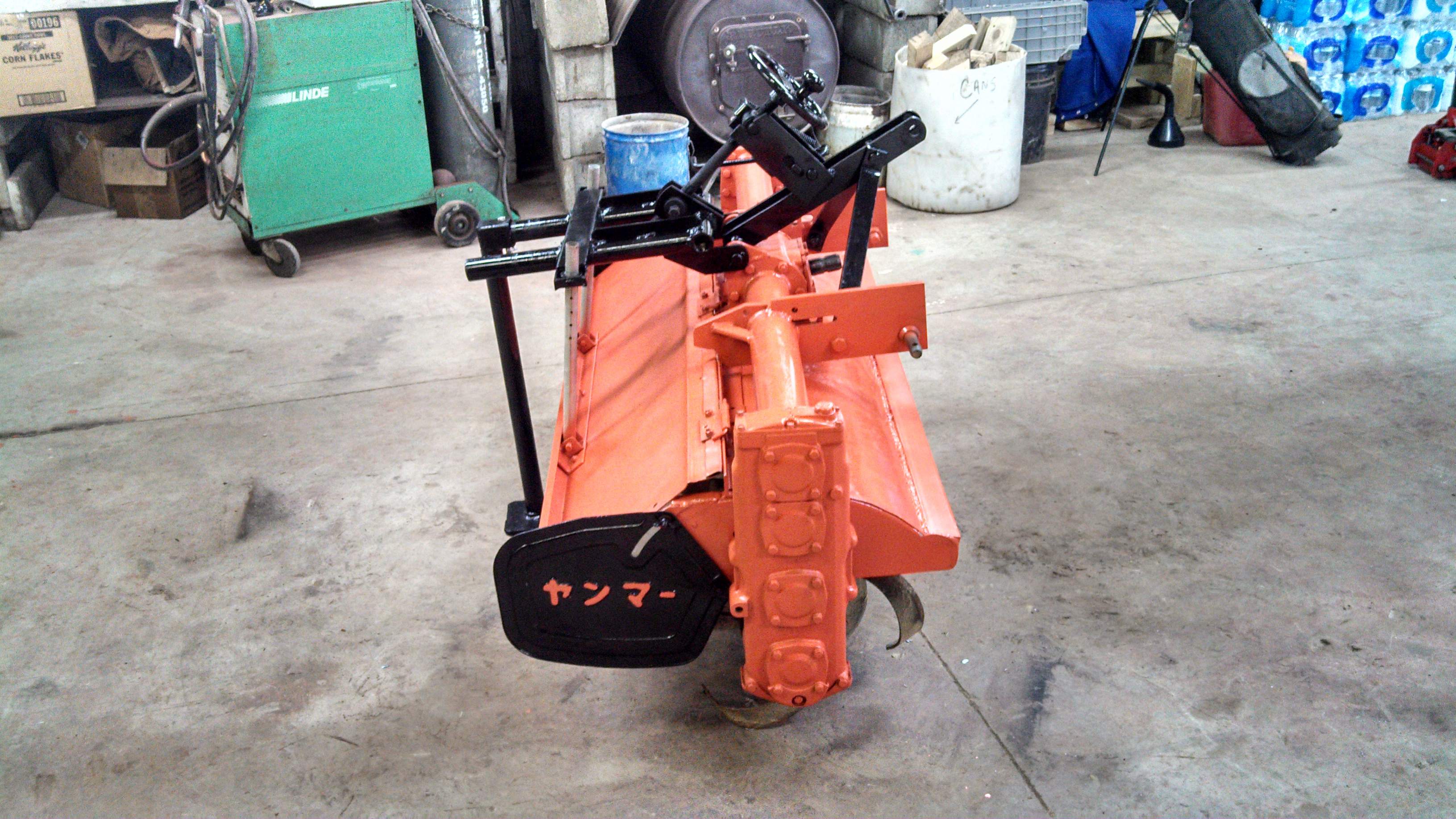

Got the guard all fixed up
And shot a little paint. Its all appart and painted, this is only the gear box and stuff

Looking good! :thumbsup:
