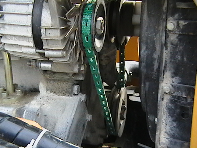

And btw, I use a linked belt. Never have to worry about belts again. Vibration Free Link Belt

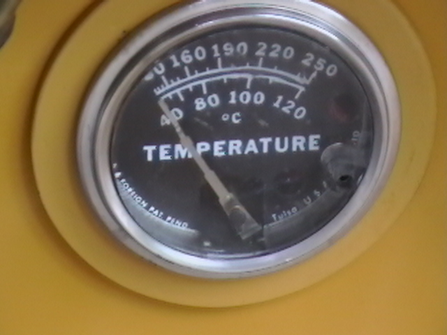

Finally got around to checking the coolant temperature circuit. My fingers said I had two wires attached to the meter, one going to the sensor. After pulling the meter, I found that one wire was just for the meter light therefore the meter is mechanical, not electric. Will be switching to a simple electric temperature gauge. Will also switch to the link belt as suggested. Should have checked first before asking the question!
/ Coolant Temperature Sensor #9
Your definition of mechanical is inaccurate. A mechanical gauge would have ZERO wires, and be inserted directly into the media being probed. Your coolant gauge is electrical, and needs a minimum of two wires. The wire between the sensor and the gauge is ground. The other one is 12v from the battery. The fact that it also illuminates the gauge face is incidental. 12v hits the gauge from the battery side, and passes through the sensor on the way to ground.Otherwise you'd never have a complete circuit. The sensor itself is a thermocouple, in which electrical resistance changes relative to temperature. As the temperature changes, so does the resistance to ground. Ground resistance is what subsequently varies the voltage passing through the circuit. These variations are what move the needle.

Be aware that if you use domestic gauges from a local parts store you will have to make adapters (see the picture of my temp. gauge in post #6). Domestic gauges are typically 2" OD and will fall through the dashboard otherwise. You can special order 2-5/8" OD domestic gauges but then you will have to enlarge your existing holes. The threaded holes in your thermostat housing are 1/2" NPT metric equivalent.

FWIW, my dozer came from the factory new in '06 with a mechanical temp. gauge.

Replaced temperature gauge with another mechanical gauge, radiator cap (7 psi), thermostst (180 degree) with 3/8" thick rubber doughnut on top and fan belt with HF link belt. Engine temperature came up to ~180 degrees and held. All parts came from local stores.

Fan Belt: Harbor Freight link belt

Coolant Temperature Gauge: Eguus 6242 (2” mechanical gauge)
Note: OEM temperature gauge hole is 2 3/8”. Equus gauge comes with a mounting bracket that can be modified and screwed to the dash covering this hole. Engine sensor hole is 3/8” NPT. Equus gauge comes with a 3/8” and 1/2” NPT adapter. A ground wire needs to be added for the gauge light to work.
