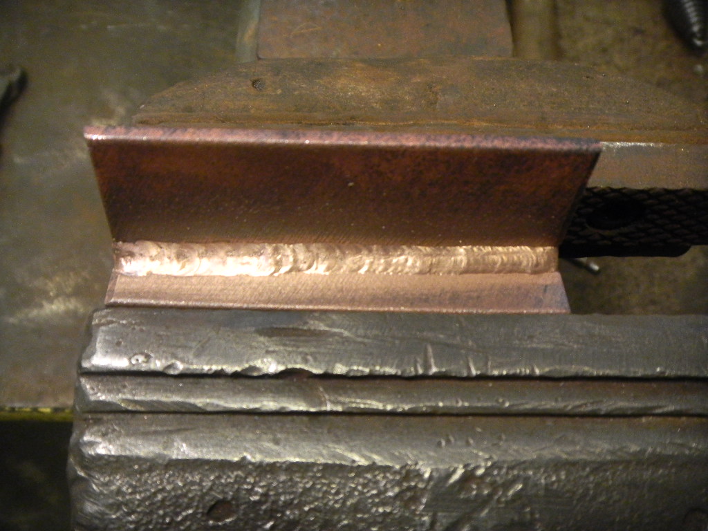

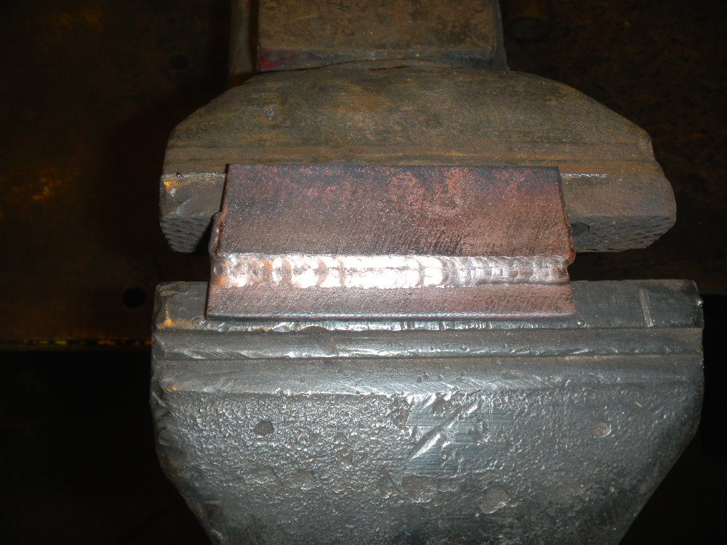

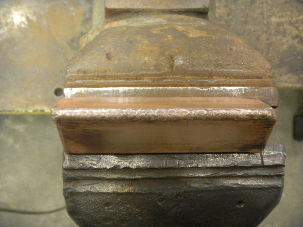

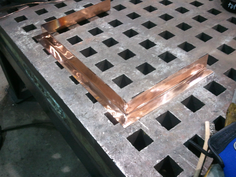

This subject comes up every once in awhile, and I've never seen it done. So I thought I'd give it a try. Took four hundred forevers to get the filler rod from weldingsupply.com!:mad: Back ordered, and all:rolleyes:.

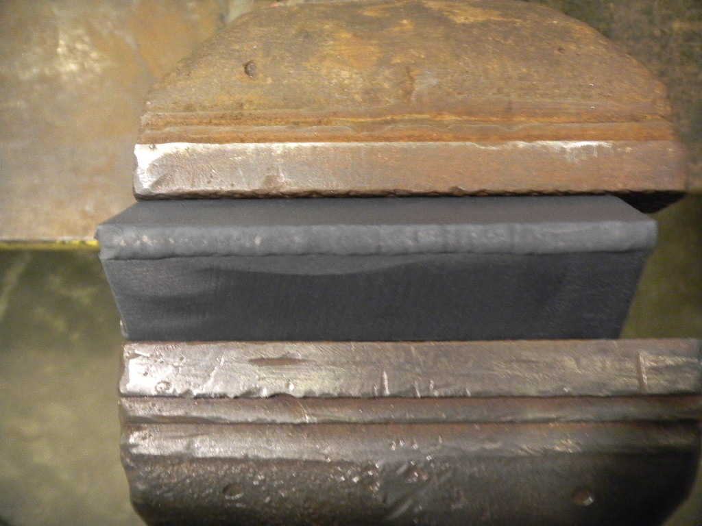

Started on some 1/8" x 1" flatbar. Did some corner joints, lap joint, and a fillet weld. Used 3/32-inch Ceriated tungsten, at 150-amps, with 100 % pure argon. Took a little bit to get enough heat built up to form a puddle. But didn't take to long until I was backing out of the pedal. In some ways it reminds me of welding aluminum, except the puddle looks dirty. I used a brand new steel wire wheel on a 4-inch hand grinder to clean the base metal before welding. After welding I tried a new Scotch-Brite pad, but wasn't very successful, so I used a new stainless steel hand brush. I learned if I let everything cool to the touch, the black cleaned off easier. Soon as I lifted my hood after welding, every piece was glowing red hot!
I tried a couple welds on 1/4-inch material, it took all 300-amps to weld the 1/4-inch!
Kind of fun to do, learned something new today!:cool:

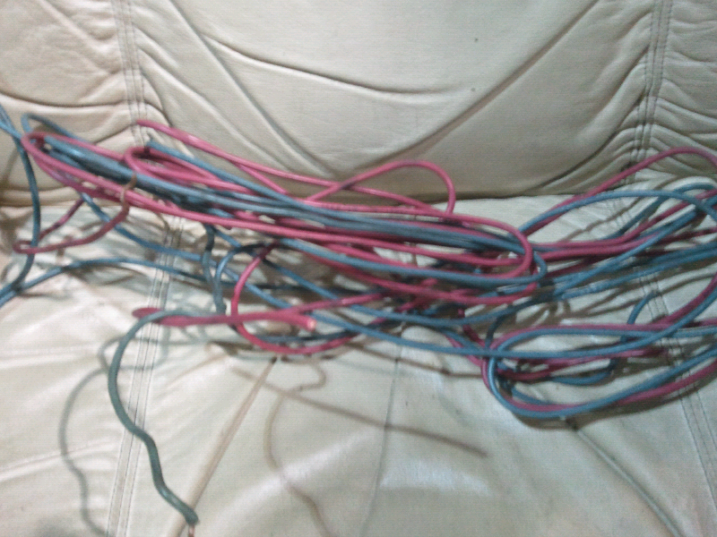

Just out of curiosity, do you think that you could use the solid wire out of Romex for a small job or one time use if the need ever arose?
I've read on some welding forums where people have had good success with like 12-GA Romex wire.
Shield you desribed it perfect bud, very similar to aluminum. Heres my filler wire, works perfect and blends and polishes great!

If it took 150 amps for 1/8in and 300amps for 1/4, does than mean I can do 1/16 with 75amps. Yes this is a real question.
/ Copper Tig welding.
Sounds reasonable to me. But I would think copper is a bigger heat sink than aluminum, so the bigger the item being welded the more heat you'll need.

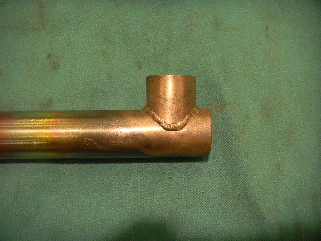

I played with some 1/16-inch wall pipe this morning. 120-amps seem to work fine to get a puddle going, but again it didn't take long before I was backing out of the pedal.
Thats exactly what I was thinking about welding. Got to put together a moonshine still you know.

Looks good. I don't think I would have bothered ordering proper welding rods though. With how cheap I am, I would have to try it with scrap electrical wire before spending anything.
/ Copper Tig welding. #17
From what I have read, copper wire has a tendency to make a porous weld. Havent tried it so dont know if thats true or not. If true, I think the copper wire wouldnt be a good choice if you where going to do any structual or pressurized pipe welding. For what ever I would be doing, it would be ortamental so I suspect the copper wire would do just fine. Now just where did I put those moonshine still plans.
/ Copper Tig welding. #18
I've been following this. Though I have never tried it (on my welding "bucket list") regular copper wire is pretty much pure copper, so it should not cause any problems in a copper weld.... Protected from oxidation by the insulation too, at least to some degree...
/ Copper Tig welding. #19
It works perfect bud, trust me ;)
