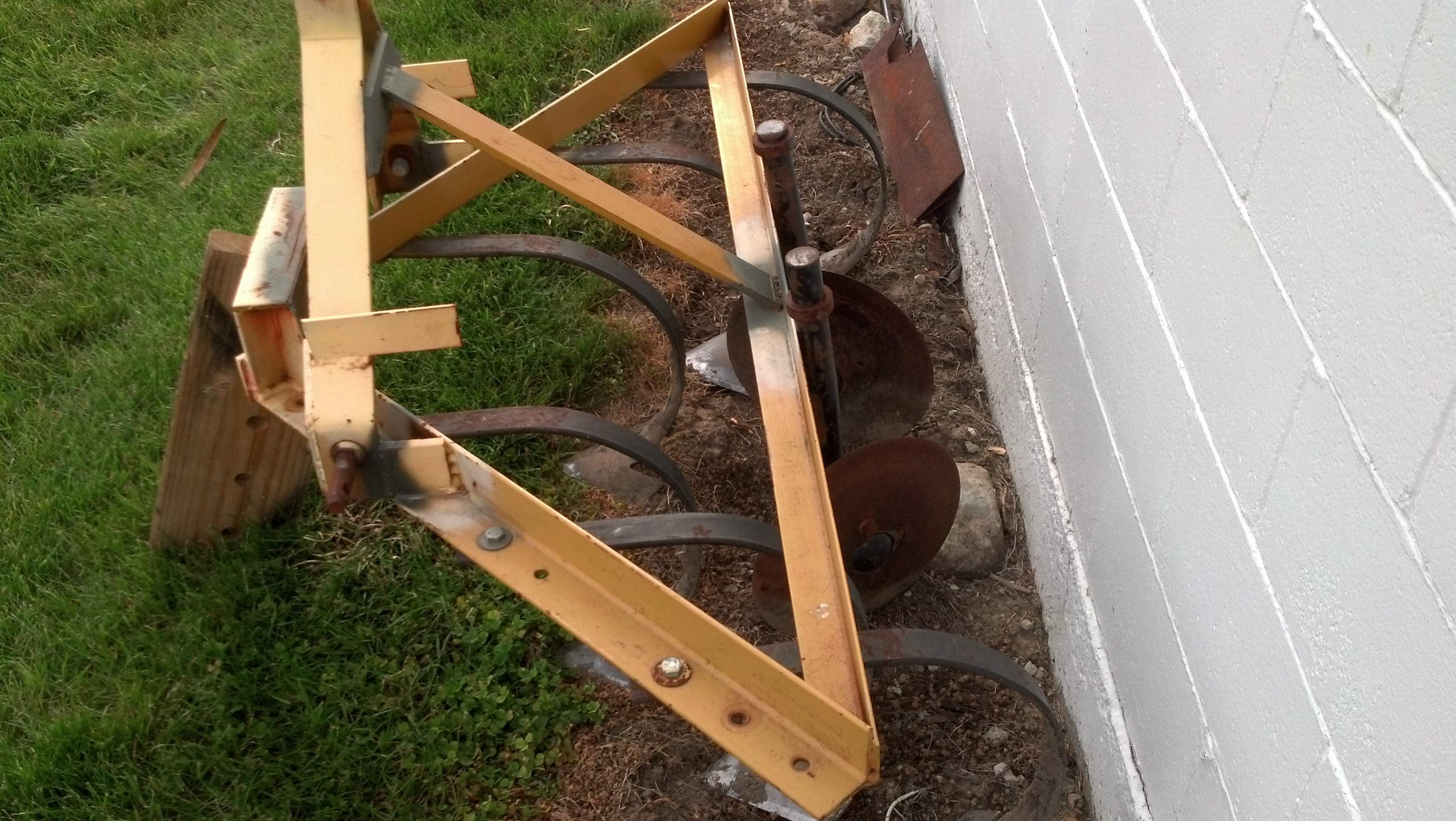

I picked up 4 "hiller" units from a neighbor who tossed them on the scrap iron pile. Once I get my toolbar finished I will bolt it to my TSC 1-row cultivator to move soil up around the base of the corn plants and also put down some Prowl 3.3 EC herbicide at the same time.
Pics below show the hiller unit just mocked up to the cultivator to place mount points.

If you mount a coulter wheel in the center of your planter it will create a ditch for a similar coulter to run in on your cultivator, thus keeping a 2 row cultivator centered. You'll find a lot of these 2 row cultivators with a center mounted coulter wheel on craigslist. Lilliston rolling cultivators are good for hilling corn or you could mount some discs or just mount a wide sweep at a steep angle.

If you could get the toolbar heavy enough, you could put rolling coulters just at the edge of each of the rows to help keep the unit from skipping around if one side grabs harder than the other. And if you had the coulters, you could mount a liquid fert knife just behind one coulter on each row and inject liquid fertilizer at the same time. Just put a TSC 12volt dc pump on the toolbar, and pop a small tank on with some sprayer hose and a regulator. Voila!!
