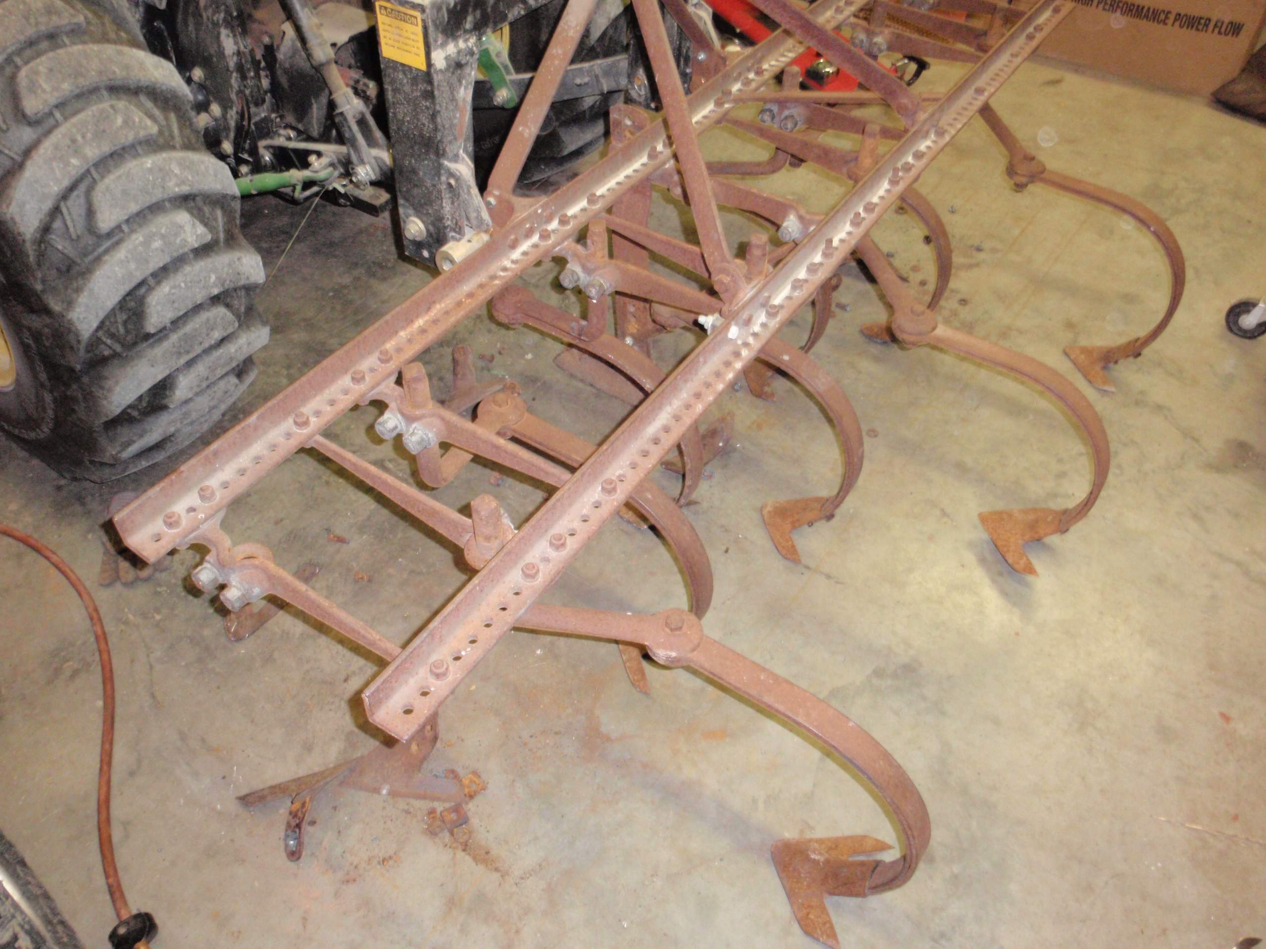

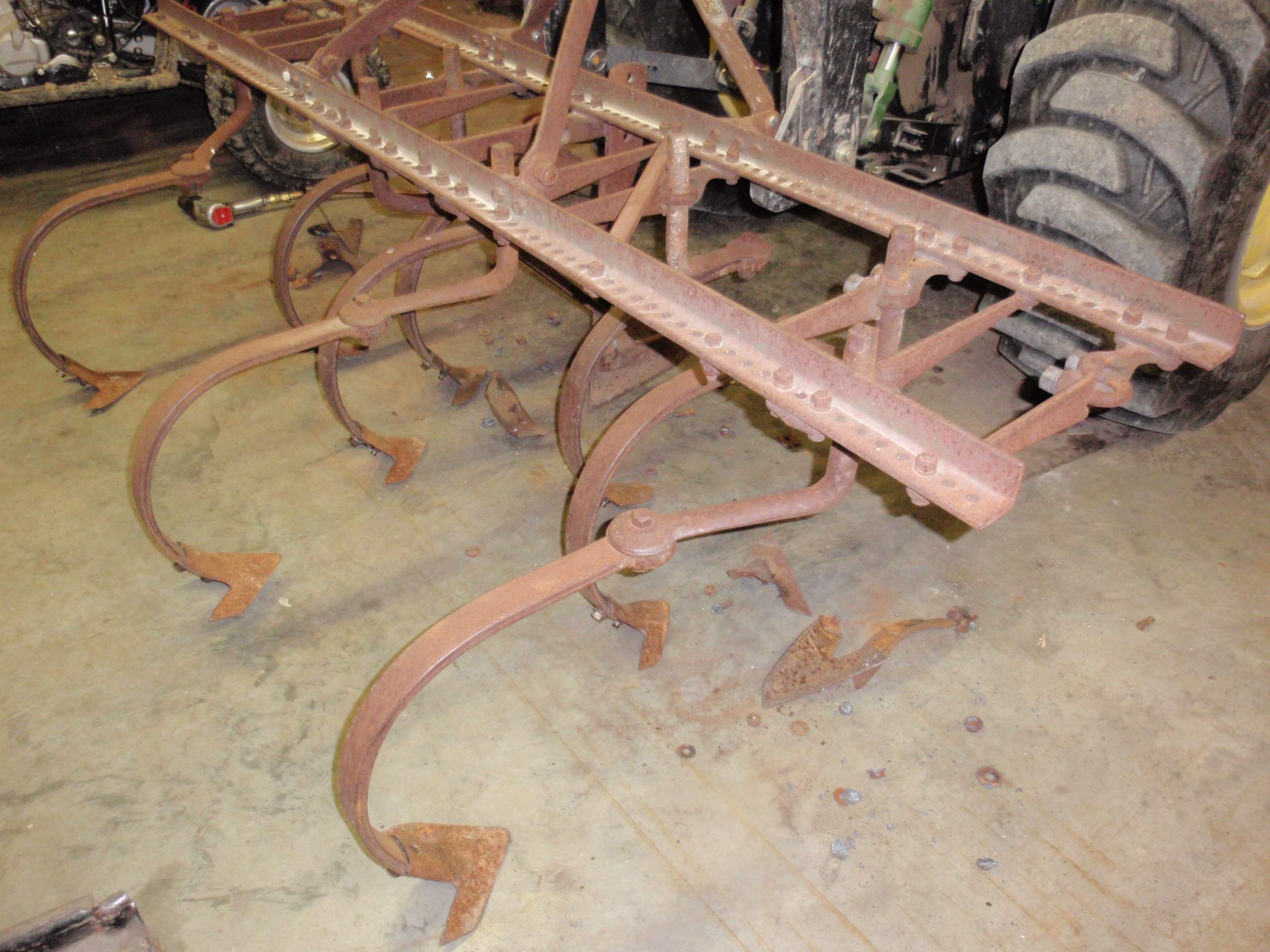

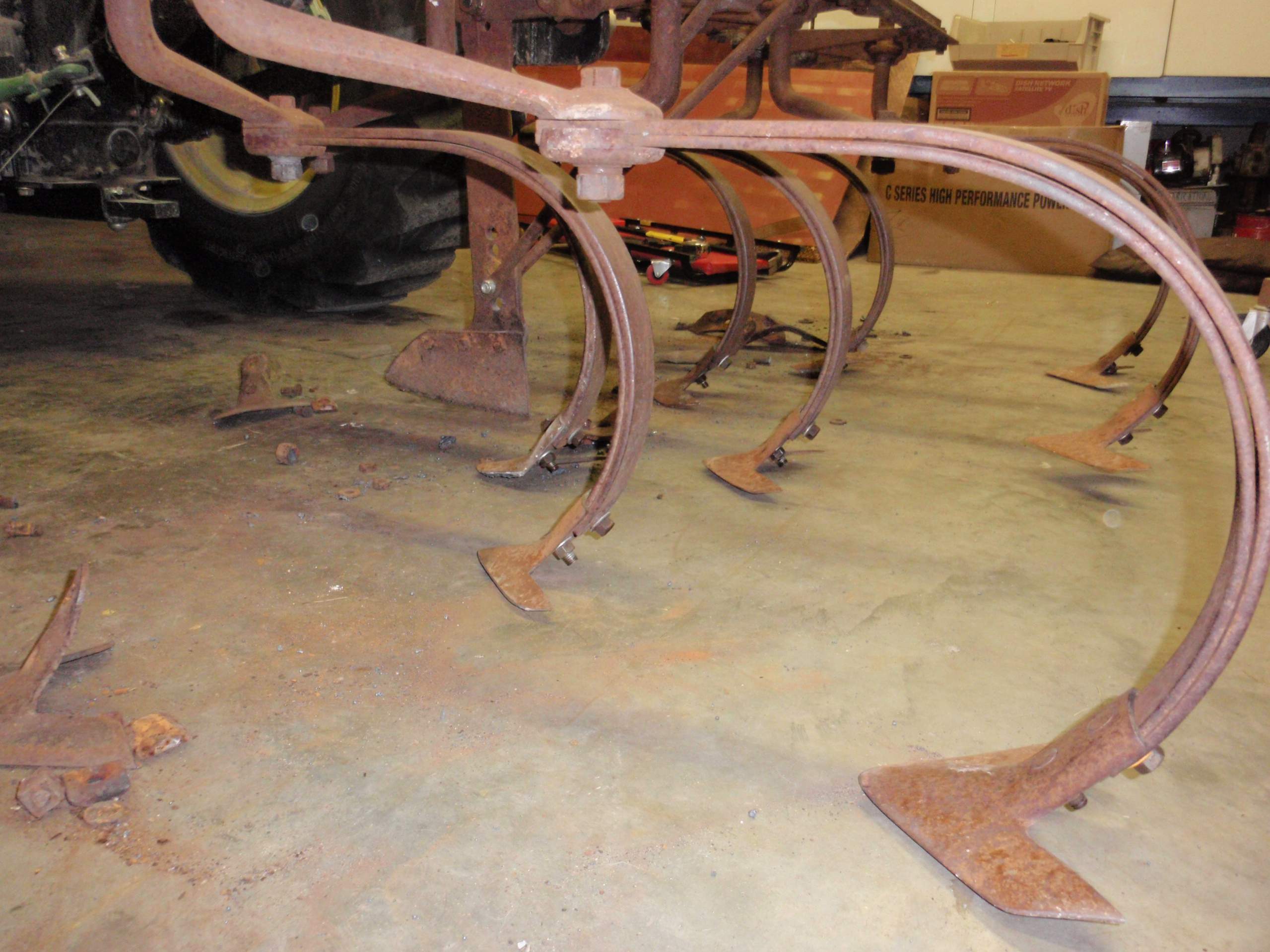

P6250009.jpgP6250005.jpgP6250006.jpgP6250008.jpgI finished preping the cultivator last night. New used sweeps from the helpful neighbor were installed, and the spacing set for 30 inch row crop use. It was a bear to get all the joits moving, and the further along I got the more the big hammer was applied. Hopefully once set correctly it really never has to change 'cause it relates so closely to the planter, which will not change.
I test-ran it in the garden where there were no plants. I put a couple sticks standing in the ground, 29 or 30 inches apart, and cultivated over them using the front wheels as position indicators (there is only about 4-5 inches of space between the front tire and the corn row, each side), and the sticks stayed standing. I cultivated about an inch and a half deep. Saturday I will run it thru corn to see what happens, but I am fairly confident now that it is going to do the job.
