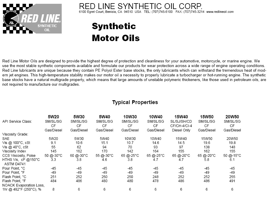

I use Redline 10w-30 in a BX23. It is rated for diesel. Redline is a group 5 synthetic oil. Very high quality, but very expensive. Advanced Auto Parts carries it. See the attached spec sheet.
Ken
