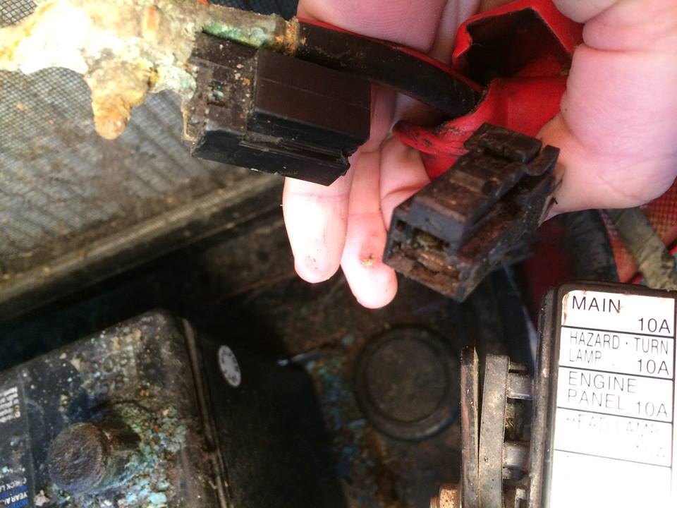

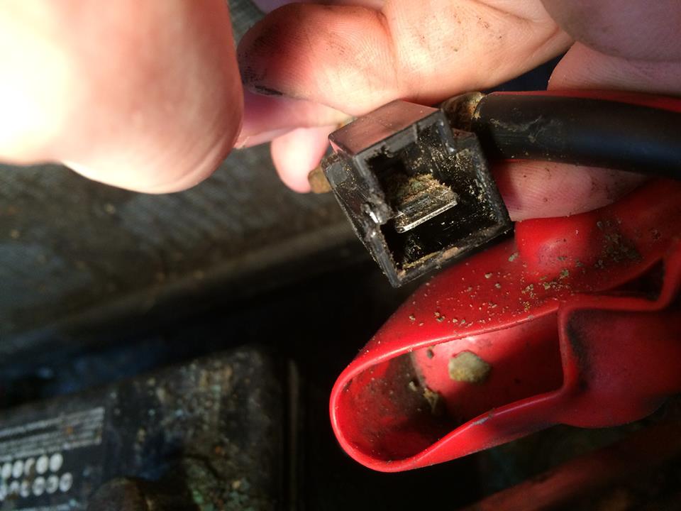

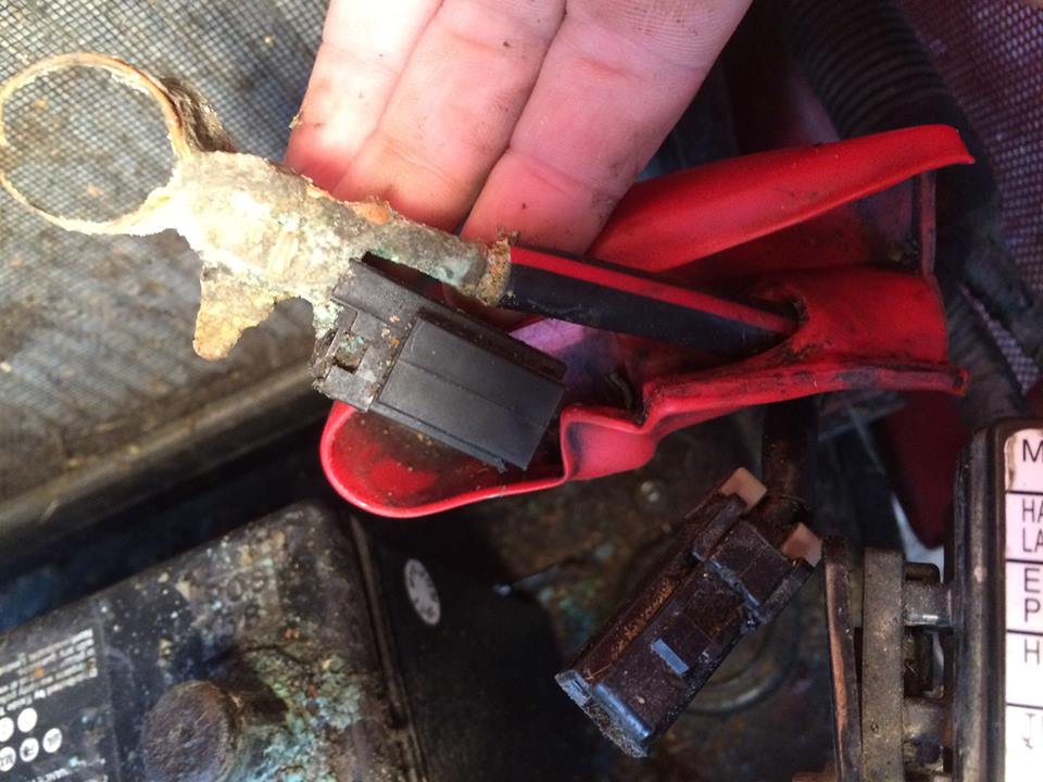

I'm wondering how all this turned out, I'm in the same situation. I can't find the terminal end part to purchase it and I don't know what to do about the plastic piece. 11064707_10153229708472728_8925191725679196546_n.jpg1382197_10153229708692728_7449555334681269067_n.jpg10313375_10153229708677728_4636797661225517427_n.jpg

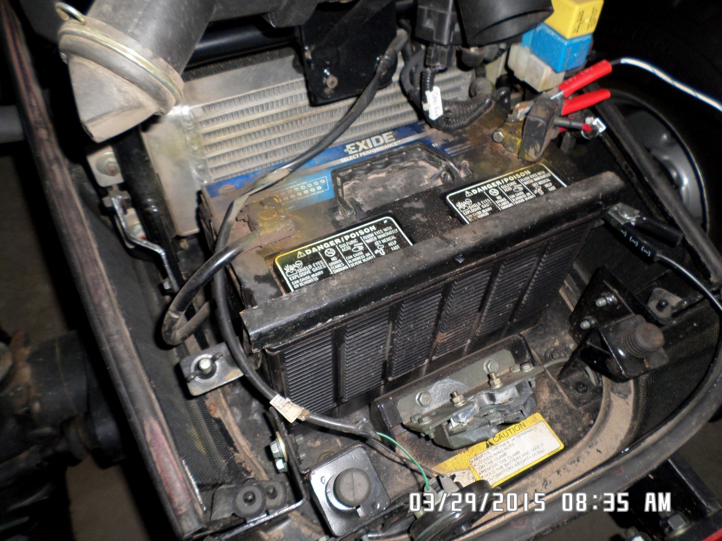

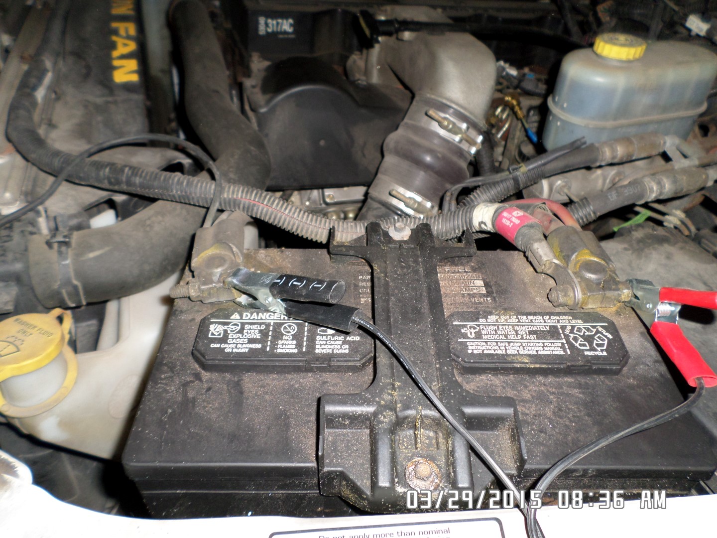

The top of a lead acid battery is a nasty place. Some batteries vent gas or liquid around the battery post, and almost all batteries vent gas or liquid around somewhere.. People have been fighting this problem for over a hundred years. The horror story and pictures you see posted on this site should make you think of doing something everytime you see an unprotected battery.... for the rest of your life. Here is a picture of one of the batteries in a 2001 Dodge Cummins sprayed with non-hardening wax in the fall of 2001, and the picture of a Mahindra 5035 sprayed in 2011.... can't see any corrosion on either... You don't have to use spray wax... but be proactive with some type of solution...
