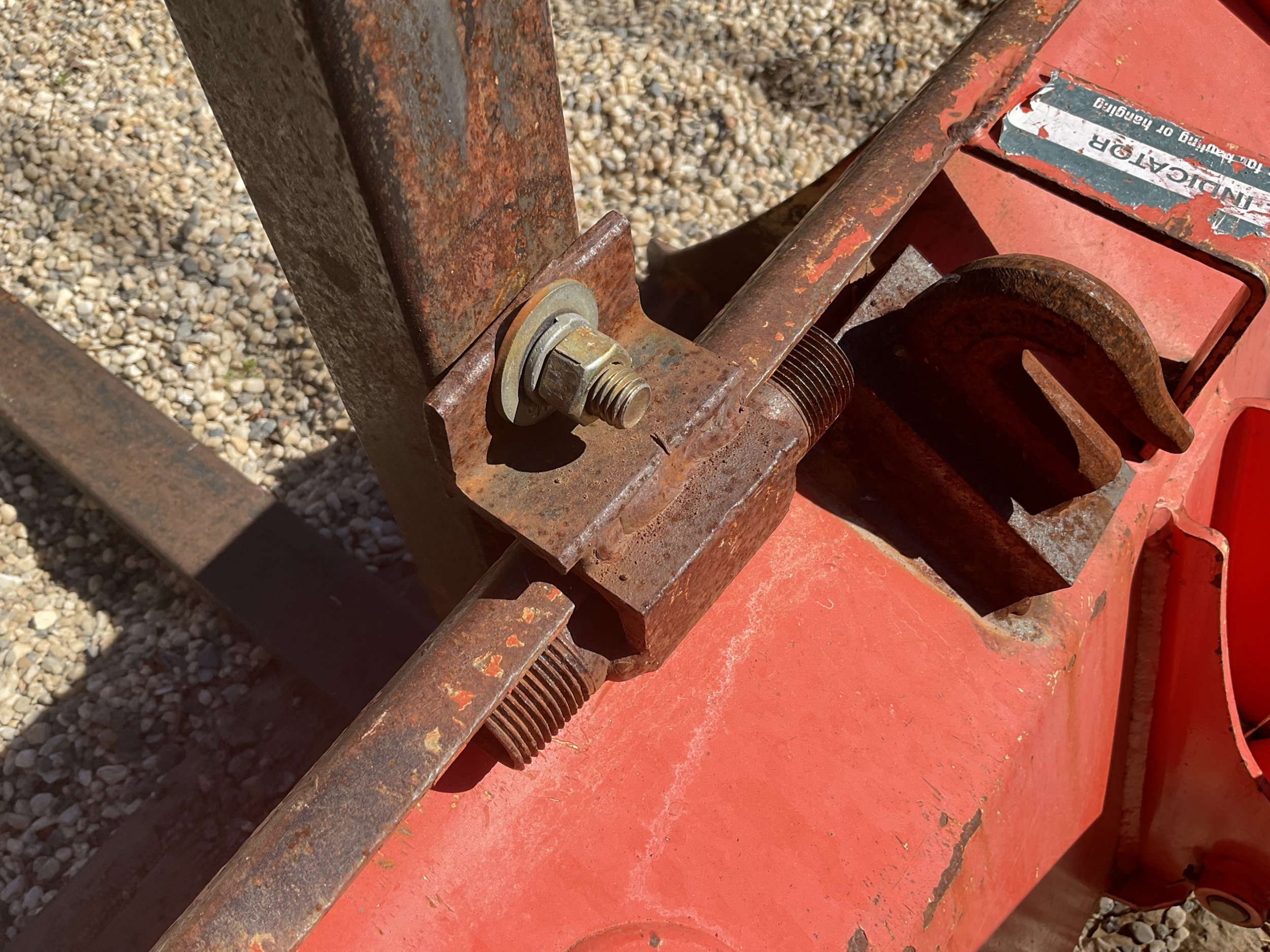

While I understand the benefit of the bolt on forks as more capable and closer to the front axle, I went the forks on bucket route. They fit both the 2660 and the 23. They are 3x.25” channel, 2x2x.019 riser and my Mcgiver attachment of a 1x6 blk npple and a couple pieces of angle iron and a #8 bolt. The go on an off very simply. BX’s are small machines and I am a chicken when it comes to “too much” out front so I haven’t gotten into trouble with them. I built a plywood hopper to sit on them for hauling leaves and yard debris which had made them even more useful.
