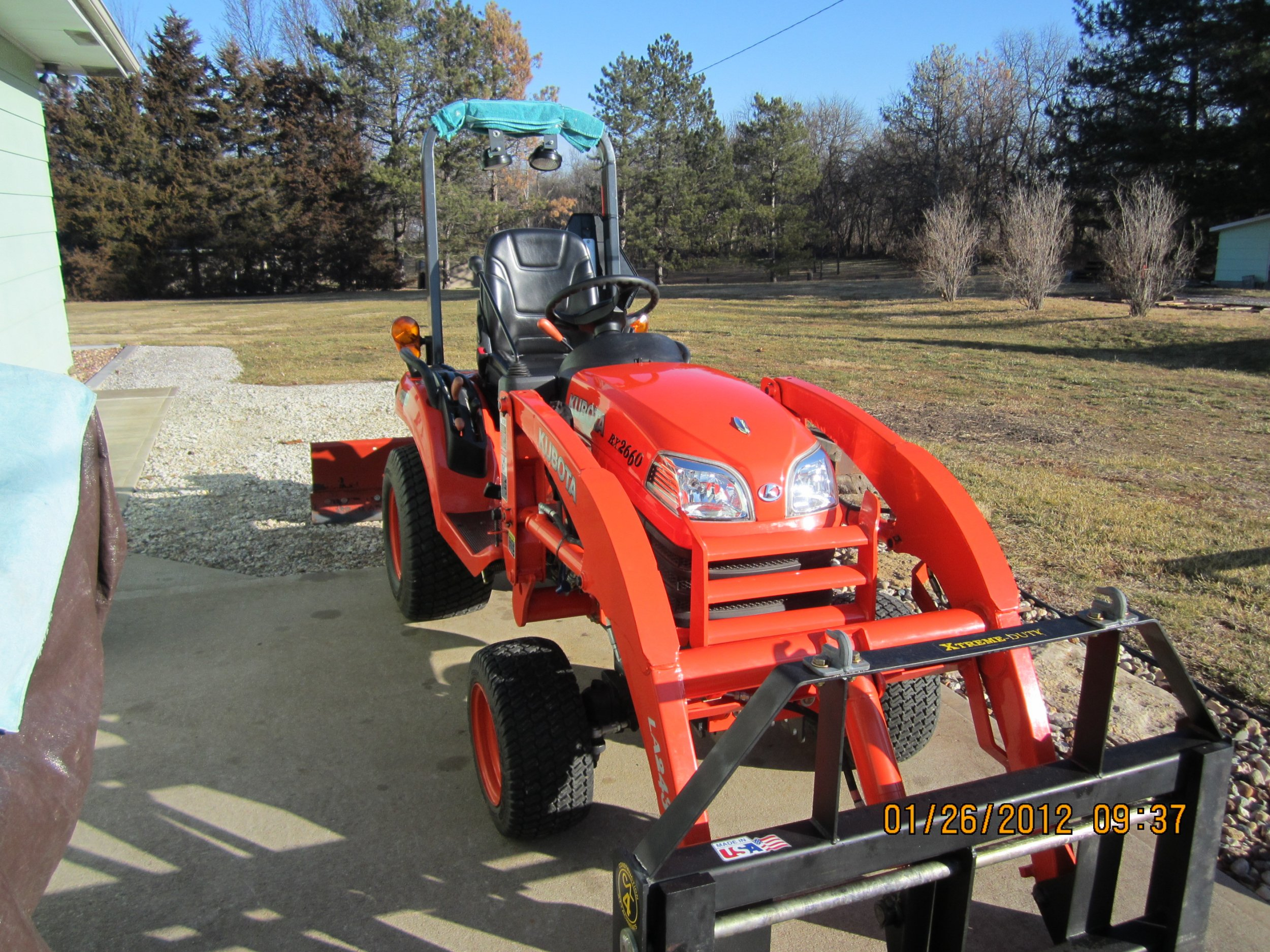

I gotta agree with the above. My first Kubota had a set of "Pallet" forks. They worked really well....but...as mentioned above....were a PITA to pin on. But you really need a SSQA to make it worthwhile.
Cheers,
Mike
