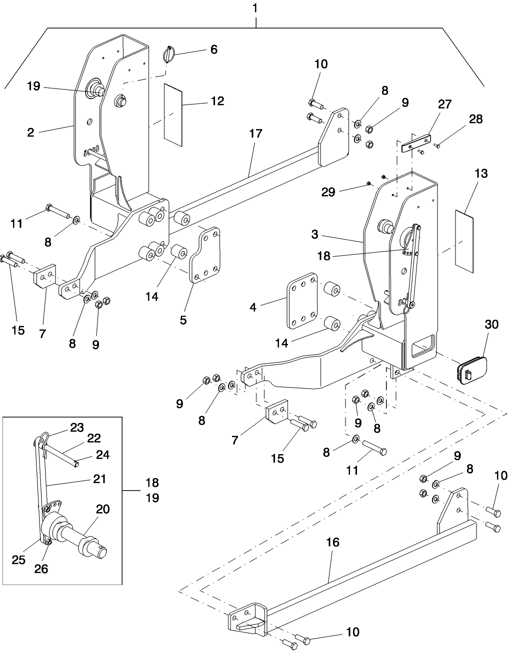

I consider myself somewhat mechanically inclined but this has me scratching my head. The loader on my tractor is loose I have tried every way I can think of to tighten these two front bolts but I cannot get on the backside they are up underneath front differential I do not think new Holland was thinking so smart when they designed this loader. I will attach a picture and maybe you guys have figured a way to get a wrench in their and hold the bolts, the tractor for all practical purposes is just a TC 55 even though now they call it a 2420 don't ask me, come to think of it they change the name again to 40 something ;-). The loader is a 270 TL. I know on the one side I have to remove the exhaust but how to get into that little space with a wrench I just don't get it, someone told me at the dealer that TC 55 used to have some kind of one piece bolt plate that held the bolts while you tightened my tractor has to separate bolts, I can't imagine why it's different the loader's capacity is the same regardless of the tractor's number. Well thanks again and any ideas would be appreciated and if anybody with a TC 55 could take a look and tell me if the dealer is correct and there is some kind of bolt plate that does not require a wrench to be applied thank you

I'm going to take a stab at it to see if I pictured it right... There is a nut behind the frame that you want to grab (keep it from turning) so you can tighten the bolt from the exposed side of the frame. Is my estimation correct? if so, have you tried to get a box end wrench on the backside jammed against the front axle to keep the nut from turning?
JC,
PS. I looked at at again, it more looks like to me that the loader bolt is tightened to a pre drilled and threaded hole on your main frame not needing any bolt on the other side to tighten. That seems to be the normal way loaders are attached to the engine, tranny and or frame.

no offense taken :), there are nuts behind the frame I can just about see them and they spin when I try to tighten the bolt, because obviously the bolt is going around, as far as trying to jam something in their good luck if I could get the camera a little closer I will show you what I mean. By the way I'm pretty sure the loader was installed at factory due the fact that it's a cab model and my bill says loader install factory? Maybe I'm reading it wrong. Well like I said I hope somebody would a TC 55 or 48 can take a look and tell me about this bracket or whatever it's called behind the frame I need to get one ;-).

My TC45D uses a plate with the nuts welded to it in that location. Mine came loose(off), but I was able to locate the plate(but not the bolts).
Chris
edit: to be clear, two nuts were welded to one plate, so they won't turn.
   / could use a little help #6
ditto my tc45 -- mine has a plate with 2 nuts welded to it -- I'm betting your welds broke loose --- now you've got a problem. I think mine came off as well but it's been so long ago I don't remember the fix. ...it's just that I remember holding that nut plate in my hand. If you take the radiator out can you reach 'em?

I checked my DX55 and you are correct, they are seperate nuts with lock washers. I also looked up the parts diagram on the Messicks site and they show the same thing - bolts with lock washers and nuts. Your pictures make it look like there is more room than there actually is on the tractor, although I think you could get a stubby box wrench on the nuts. You might be able to get a flex socket or crows foot on a couple of them, but I'm not sure without trying that.
   / could use a little help #8
See parts 7, 8, 9, and 15.
