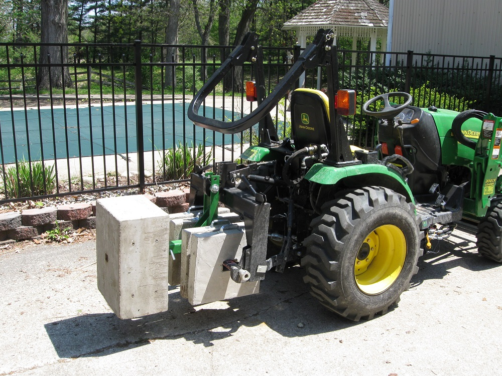

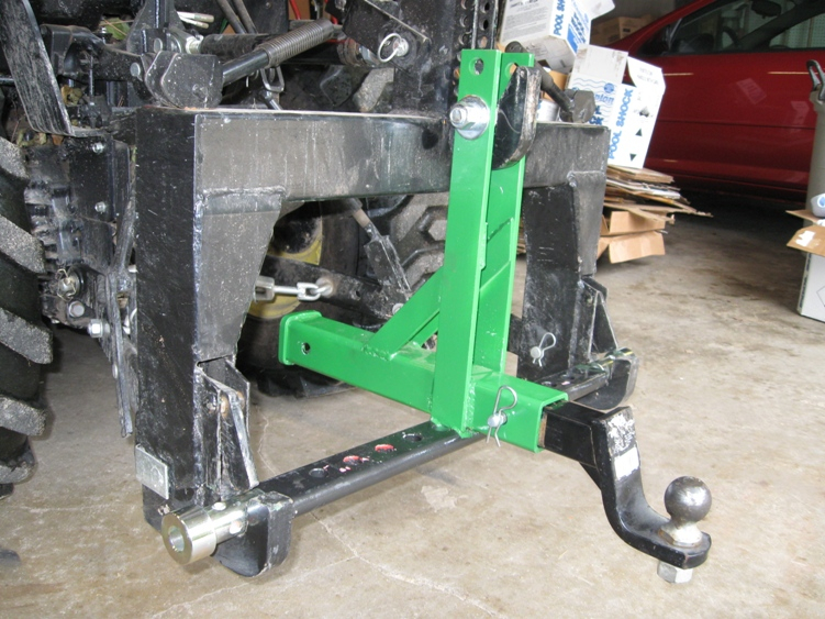

Using several hundred pounds of logs as counterweight sounds really awkward to me. Here is what I did. I built a 3 point hitch receiver. You can buy them for $100 or so but I built this for a lot less.
It's reversible so I can have it close or extended. I can put on a various carrying platforms, etc. or I can just use the concrete weights I have cast. I usually just use the big block mounted close, but if I think I need more weight, I cast these "suitcase" type weights also.
Whatever it's worth it for you to do, but I think the log approach will be annoying if you use it often.
