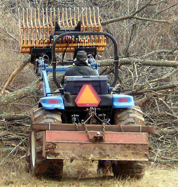

</font><font color="blue" class="small">( Do you guys who use 3pt mounted counterweights chain them up, or just let the hydraulics carry the weight when you're running?I use an older Gannon box weighing maybe 400# and it hangs out 3' or so. Should I chain that?Jim )</font>
jimmysisson, I have a weight bucket similar to Soundguy. Looks almost identical for that matter. /forums/images/graemlins/crazy.gif I welded a large round flat washer on the ends of two pieces of chain which I attach to the lower link ends. The other end of the chain then attaches to two pieces of metal that have "key hole" type slots cut into them to allow me to attach the chain at the top link. I then support the weight bucket completely on the chains. For my little Kubota (B1550) this takes all pressure off of the hydraulic system. I've been using this arrangement for many years now and I highly recommend it. /forums/images/graemlins/laugh.gif You apparently have a much larger tractor and this set up might not be needed on your tractor.
