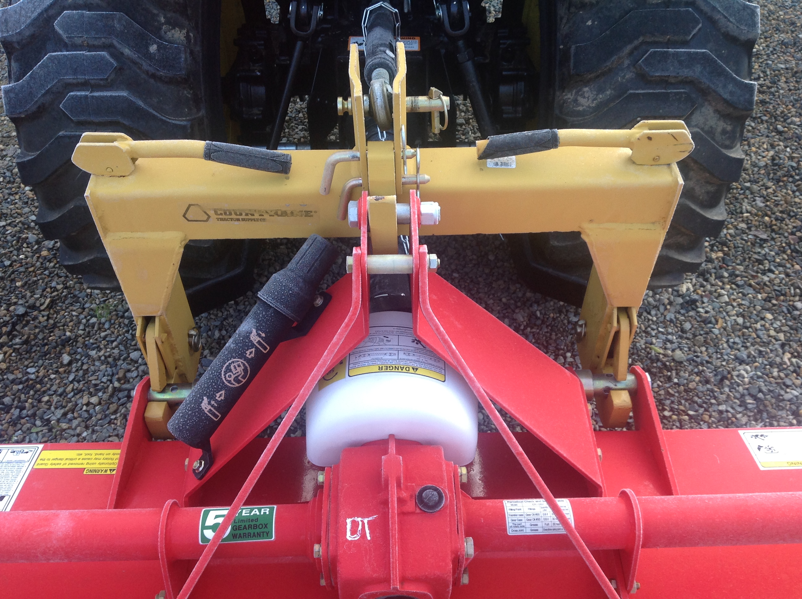

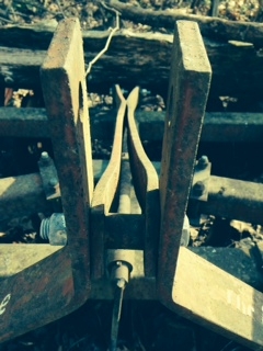

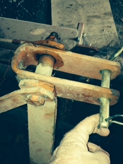

I got the QH to my property where the tractor is. Got it mounted but didn't have too much time to experiment with the implements. I did take the attached pictures.
The third picture is the top link mount on my brush hog. I think it is called a flex mount which allows the implement to follow the contour of the land being cut. I guess when using the QH I will need to flip it back, get the bottom hooks engaged and then get off the tractor in order to flip the flex mount back onto the QH top hook. That shouldn't be much of a problem since I have a hydraulic top link. Sound about right?
The other two pictures are of the top mount area of another implement. I didn't play with it, just took the pictures. Any comments/thoughts about how this will work with the QH? It's a pretty common setup on implements so I expect some of you guys to have experience here.

Disassemble and reassemble so the flex link is behind the A-frame of the hitch.

First two pictures - that's where I back up and set the qhitch's top hook upside down over a pin at that implement's mounting point. No big deal if you have replaced the hook's bolts with removable pins as I showed in post # 8 above.
