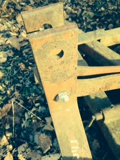

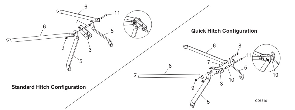

If someone gets a chance, please post a picture of how to chain a rotary cutter as an alternative to the flex link.
I'm home in town so this ballast photo is the closest picture I have available. I use this chain to reach back and make a slack loop over the top of the mower's 3-point mast. And unpin the hook to swing it up out of the way. That's all there is to it, the slack chain loop is sufficient to go tight and raise the back of the mower when I raise the qhitch.
Next time I have the mower attached I'll take a photo but it's going to be a while. 5 to 15 inches of rain forecast for the next couple of days!
Fallon, could you explain what you mean by saying you leave a hydraulic top link in float. I have a HTL, but unfortunately I'm not totally understanding your last post.
My L3200 had a float detent for both top & side links. Just like your loader lift circuit. Put the valve in float & it would extend or retract as anything pulled or pushed on it.
To chain a rotary cutter just attach a piece of chain to the toplink bracket on the cutter then attach the other end to the tophook. Leave 6-10" of chain between. It just needs to be short enough so it will tighten up & lift the tail wheel off the ground when you lift the cutter.
