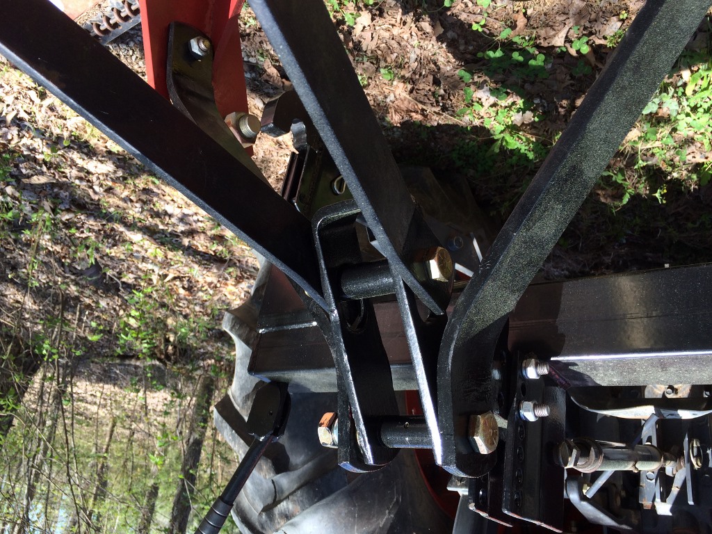

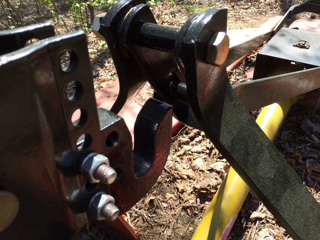

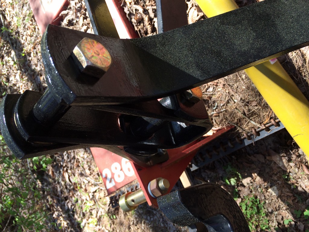

I reworked the "flex link" on my BushHog thusly. It required that I drill a new hole to relocate each of the two vertical side links at the correct QH spacing from the lift pins (I think I used 15").

Also had to cut/grind down the bolt that connects the long "back links" so that it would pass between the verticals when necessary.
Why not just totally remove the flex link, add washers or some other spacers to take up the space left by the flex link, and leave the long "back links" attached as they originally were. Sounds too simple, so I am probably not thinking of some problem this would create.
Removing the flex link would cause a more rigid connection between tractor and cutter. Is that a potential issue? The vertical distance between lower pins and the top where the hook would engage potentially could be a problem, but the hook can be moved up and down, so maybe that won't be a major issue.
What am I missing here?

The flex link is vital (IMHO, and that of Bush Hog) to allow the back of the hog to swing up and down to follow the ground contour. Some folks have just replaced the long back links with chain to accomplish the same thing.
Yes, the top hook on the QH can just be moved up or down, but I disliked the notion of having to "adjust" the QH any more than absolutely necessary between different implements. Makes it easier for the wife to change implements herself. So it was easier in the long run for me to just adjust the spacing between the lower pins and upper pin to fit exactly. This required redrilling the two holes for the side links about 1-1/2" lower.
