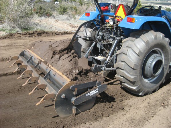

I do a fair share of trail work, have about a mile/two that I maintain around my property. I have a BB and a rear blade that I use for it (and a hydro top link). You've gotten good advice, but I'm weighing in to say, if your tractor is big enough, consider a heavy rear blade. My BB will clog with grass and jumps over things, with the rear blade, I make 2 passes, cutting a ditch on the side of the trail on either side and dumping all the dirt on the top. The I smooth all that out with the BB. That works much, much better than just using a BB because the BB (at least mine) stinks at ditching. And you don't want a dead level trail, it won't stay that way for long if you get much rain. If I had to give up one tool, I'd give up the BB, the rear blade can do what it does, just harder and not as pretty. But the BB cannot do what the rear blade does. A hydro rear blade lets you "grade" a road, you can cut into hills, you can ditch, you can level. It's a very, very full featured tool if trail cutting is what you're after. Now, distributing rock? No way I'm using my rear blade for that, the BB is so much better. But when it comes to "heavy" dirt work, I find the rear blade is significantly more useful than the BB for my purposes.
Here are some pictures of me using my rear blade and some videos; give you an idea of what I do for my trails.

Those pictures look good and are very helpful thank you! I am not sure if both implements will be in my budget but I might have to save up a little extra, some nice trails you've made!
https://www.tractorbynet.com/forums/attachments/406953-bison-nb80-240-review.html
Does your rear blade not clog with grass as well? If not, do you think it's because it's so heavy, or is is there some functional aspect of the rear blade that just works better with grass?

A rear blade works a live load, meaning that the material is always moving. A box blade works a dead load, as in gathers material and holds it.

I see - so if I'm inferring correctly (from description and pictures) the rear blade peels grass out of the way and moves it around, whereas the box blade just sort of pushes it and collects it (not permitting 'escape' of the material, and thereby slowing the tractor). Is this correct, or am I missing something important?
I have a small box blade that I intend to replace when I can find a good used one, and an ancient, multiply-welded, and slightly curved rear blade (got free when buying some other ancient equipment) that I have not even hooked up to the tractor due to my skepticism about it's functionality.
An angled blade will roll material to the side. Snow plows & to some degree road graders are like this. Box or straight blades just collect stuff.
I recently picked up a cheap used back blade because of deficiencies with my heavy Gannon box blade & LPGS. Neither will move material laterally. So they really cant put a crown on a road or windrow material to the side. They can only move material straight ahead. Either smoothing or piling, but never creating any side slope.
Back blades rarely have scarfiers, side plates or as much weight as a box blade. You can find exceptions to that generalization in this thread, but they are much rarer. Without scarfiers & weight a back blade will never cut as well as a box blade. They are also generally wider than a box blade to cover the same width when angled. That further decreases the lbs per foot that does the cutting compared to an equivalent box blade.
Each impliment has it's own strengths & weaknesses for various jobs. You can also make either do the job in most cases as long as they arent to light. All things being equal, the box blade will be stronger & cut better. But the back blade will do some things the box won't.
