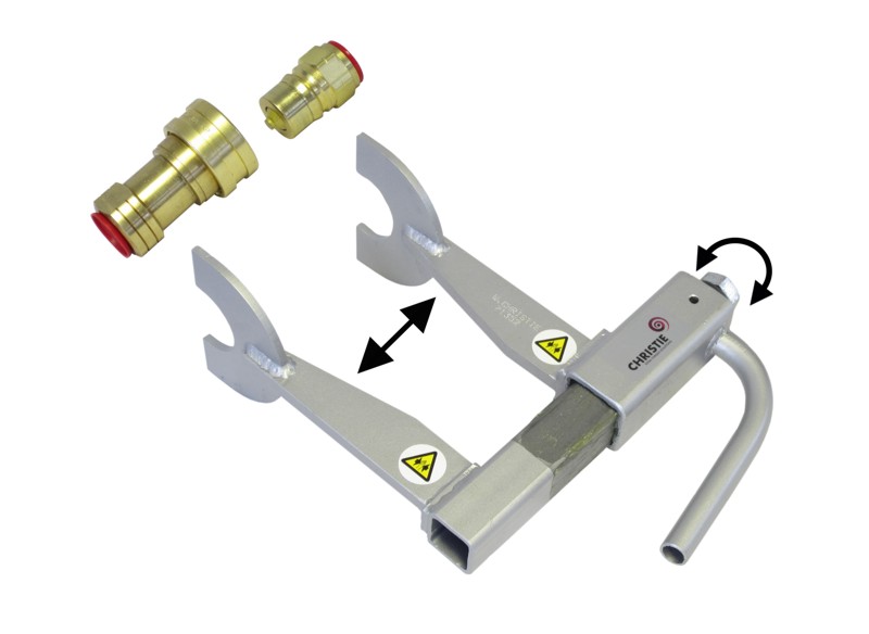

Found this image on Bing...is that the type of tool you are looking for?

I saw that too in trying a search That works fro removal, but not attaching where you need to quickly slide the collar back to lock. The one I remember did not require a ratchet wrench.
Maybe I need to invent one :):thumbsup:
Thanks
On edit, they sorta looked like this 373 Fuel and AC Disconnect Pliers | Lisle Corporation But could be used both ways.
