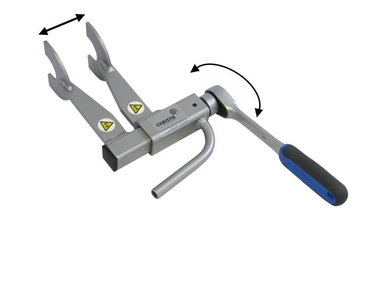

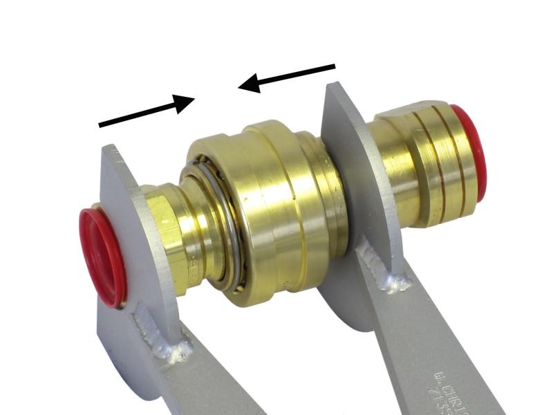

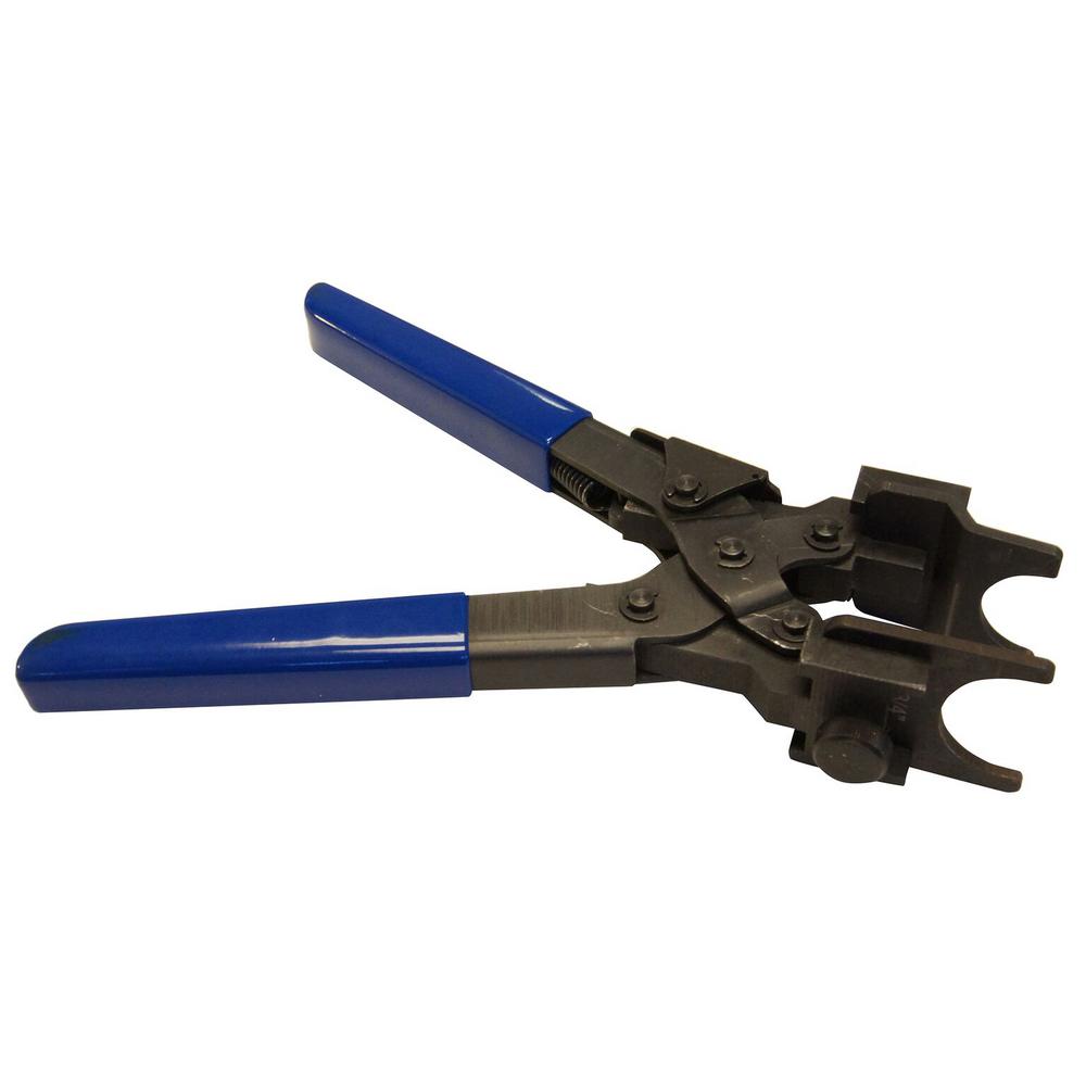

Has anyone got one or know where to get one? My hands are getting iffy sometimes pushing back the big collar to connect or particularly disconnect hydraulic lines. And before folks ask, Yes I have relieved all the pressure
Years ago I saw one at a farm show that looked like a set of oversized pliers with ends configured to push the collar back while hooked to the back of the fitting,
Thanks for any help
Keith
Check some of the previous threads on coupler connecting tools:Search Results - TractorByNet

Is there a video on the Waite tool? For the flat face couplers?
