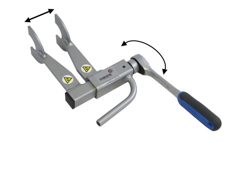

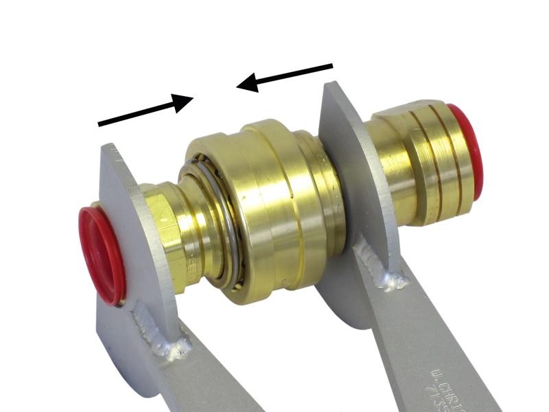

Post #19 quotes a link for Ken's Bolt on Hooks that has a video on how the tool works. He's shown using the ag couplers, but he states that the same principle works for the FF couplers.
   / Coupler connecting / disconnecting Tool #23
It's the same principle as tapping the poppet with a hammer. Only the tool holds the fitting & pushes on the poppet as you tighten a bolt. Not rocket science, but handy.
The tool only works on male fittings. But that's all I need for my snow plow or post hole digger. Relieving 1 hose relieves both sides unless you have the plow hard up against the stops on one side. Might have similar issues if a grapple was hard open or closed.
The tractor side is usually easy to relieve by cycling the valve with the engine off.

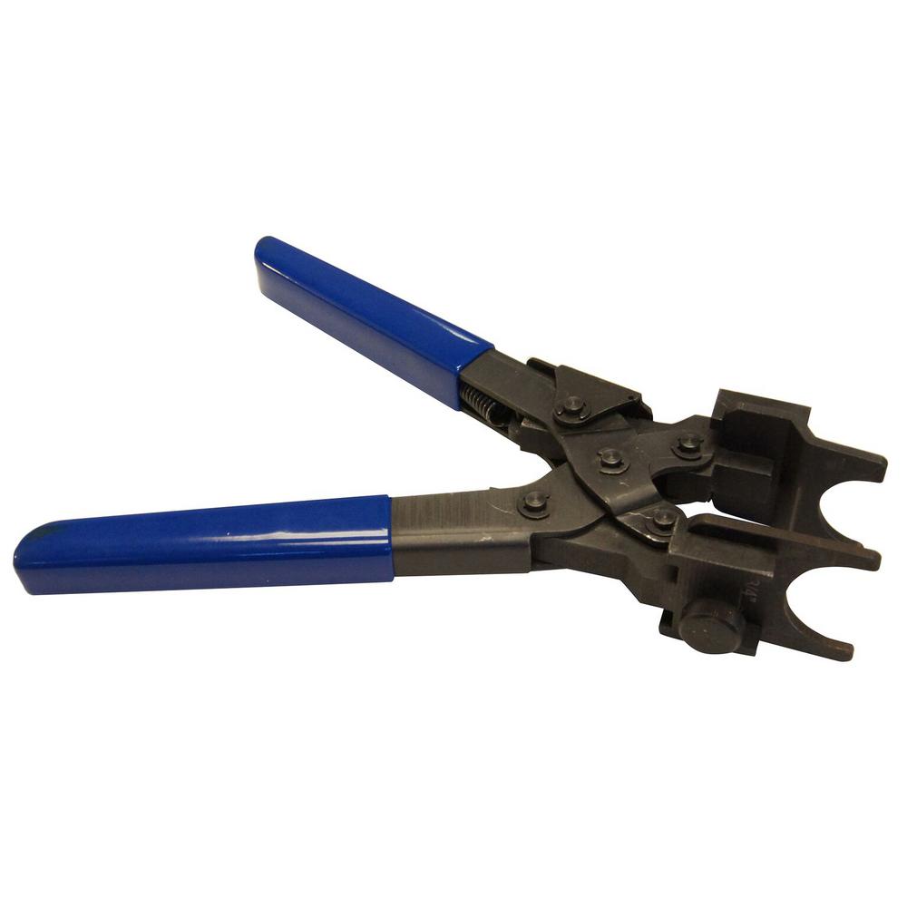

powerscol, is this the type of tool you mentioned in your first post?

Only issue I see with those is they don’t hold the collar back, he would still have to do that.
