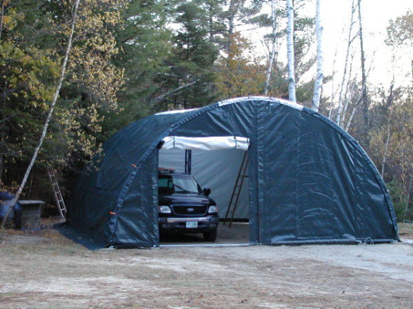

Dave,
My garage is 26' wide x 24' long and is the round style. The anchors I used, if I recall correctly hold approx. 1200 lbs each. I only have 6 of the and my garage has not shifted one Iota in over a year. 12 / 14 of them would hold down a battleship. Do you really feel you need that many ?

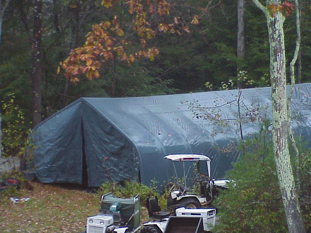

   / Coverit All Weather Shelter - Anyone Have one ? #25
If you get a cover-it, you might consider spraying the outside with silicone to help the snow slide off. I have been thinking about the cover on mine and looked it over once again this morning. I have a feeling that it might be the heavier fabric and that was all that was available in the beginning. They might have made that an upgrade later on to keep the price to a more reasonable amount since they went into selling in the discount houses. Don't know for sure. I would say that if someone were to look at it, they wouldn't be able to tell when it was erected, since is shows no signs of deterioration except for the one seam that opened. I would say that is a manufacturing defect that showed after 7 years..... I never close the zippers at either end and allow the air to flow through and this might be another reason that it hasn't deterioated...... just don't have an answer to those that have experienced short life of their cover-it....... Now if I can find the time to eliminate all the clutter that has accumulated inside the cover-it and get the old Bolens tractors back inside before the winter...... The new Kubota BX has evicted the Bolens!!!!!
